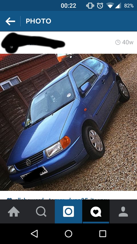

Hey guys,
Was wondering if anyone knows the paint name and code for the Polo attached? Makes sense to sort the rust and dings before modifications!
It's a 1995 6N1 1.3 8v 55bhp
Its the lighter of the two blues I've seen on these models.
Cheers :)

    There should be a sticker hidden away in the boot somewhere. Possibly under the boot carpet itself. The paint code will be on that sticker. It will be a 4 digit code around the centre of the sticker.

The paint code will be on that sticker. It will be a 4 digit code around the centre of the sticker. Probably starts with L
Many thanks! The sticker itself had peeled off and found its way under the spare!
The colour code is LR5Y if any one is interested!
