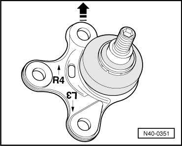

The wishbones are not handed, you just fit the bottom ball joints in different directions according to side & wheel size
post-36925-0-72975400-1431344270_thumb.p
post-36925-0-05499200-1431344282_thumb.p
You fit them with the arrow facing forward and then 3 or 4 for 13" or 14" wheels

That's for taking up any play inside the rack, not for the tracking, I would check those bottom ball joints are fitted the correct way around

I think the ball joints can only go in one way on the wish bone unless you put the upside down.
