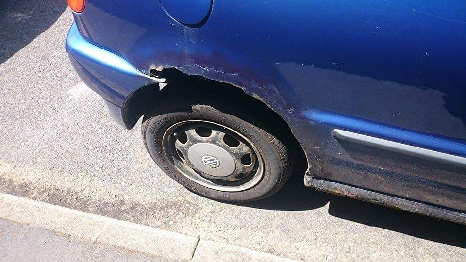

At the start of the month I decided that the car had cost more than enough and that I should probably think about replacing my wifes Polo 6 years later.....especially since Mini parts are so expensive and you can still find a Polo at a scrap yard! In the 5 years I owned the car it had been driven 1500 miles and cost me half a years salary, which is a sobering thought as I am far from being on minimum wage.
For the grand total of £200 I brought a 149k mile 1997 R reg 999cc Polo L
Currently I am stripping down the car, seeing what work needs doing and parts i need to source
So far it needs...
  • Both rear arches repaired
  • New rear valance
  • underseal stripping off, rusty treating and reapplying
  • Various rust patches repairing
  • A full respray
  • replacement carpets and retrimmed front seats
  • Engine reconditioning (probably gearbox too)
And probably a whole host of other things....but its a project.

And if rust makes you queasy, then look away from the drivers side rear arch of this car....that's an inside shot of the day light coming in and a shot from inside the arch.
And bonus, at the bottom a hole!!
