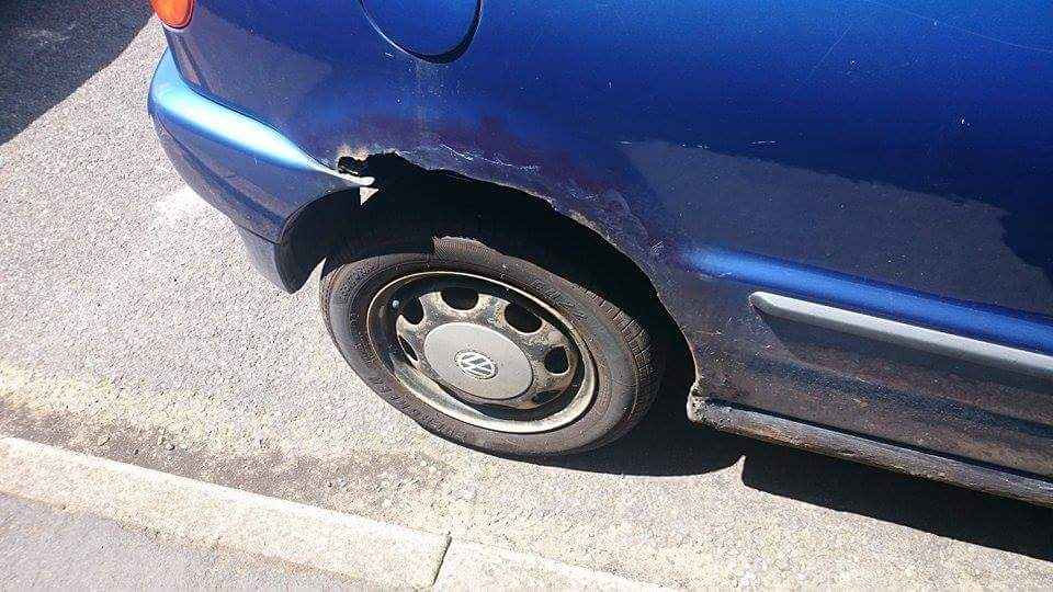

Only kidding, I have scrapped the car today. Here it is, cut into pieces and on the back of a truck.
Every time I took a piece off the car it only revealed more rust.
  • Both sill completely shot
  • Both leading edges of the rear arches.
  • Both trailing edges of the front arches.
  • Both roof seems (front and back edges)
  • Around the windscreen
  • Floor around every grommet hole, because the grommets have just rotted away
  • Around the fire wall
  • Front subframes and arms
  • And then all the bits of trim I would need to locate/replace/refurbish!
