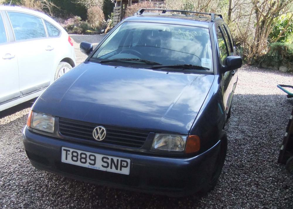

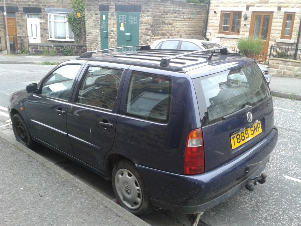

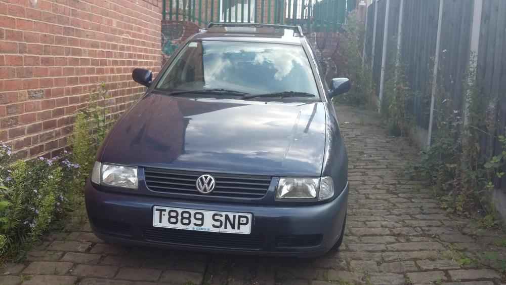

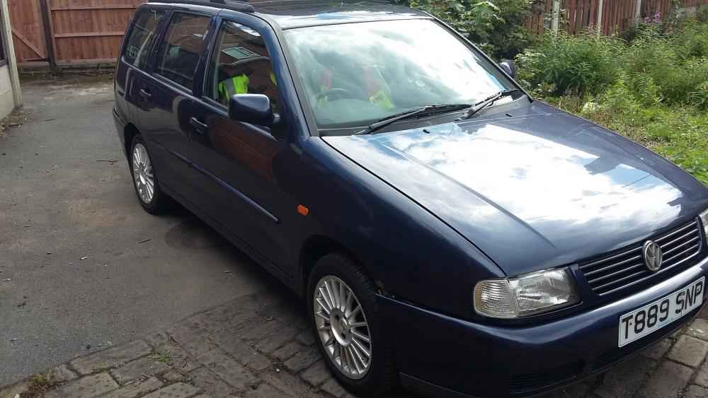

I was thinking yesterday that it would be nice to show my baby to you guys. So, this is...Ellie(named after my team leader). It's not in the best condition, but slowly I shall make her like she was on day one.
She is a 1.6 automatic estate, with(and this is the "wow" thing) genuine roofbars and a towbar. Everybody keeps buzzing me that the roofbars, combined with the automatic gearbox and the fact that she's an estate turns her into a pretty rare Polo. I really don't know if it is so, but I don't care about.

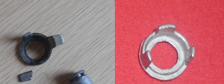

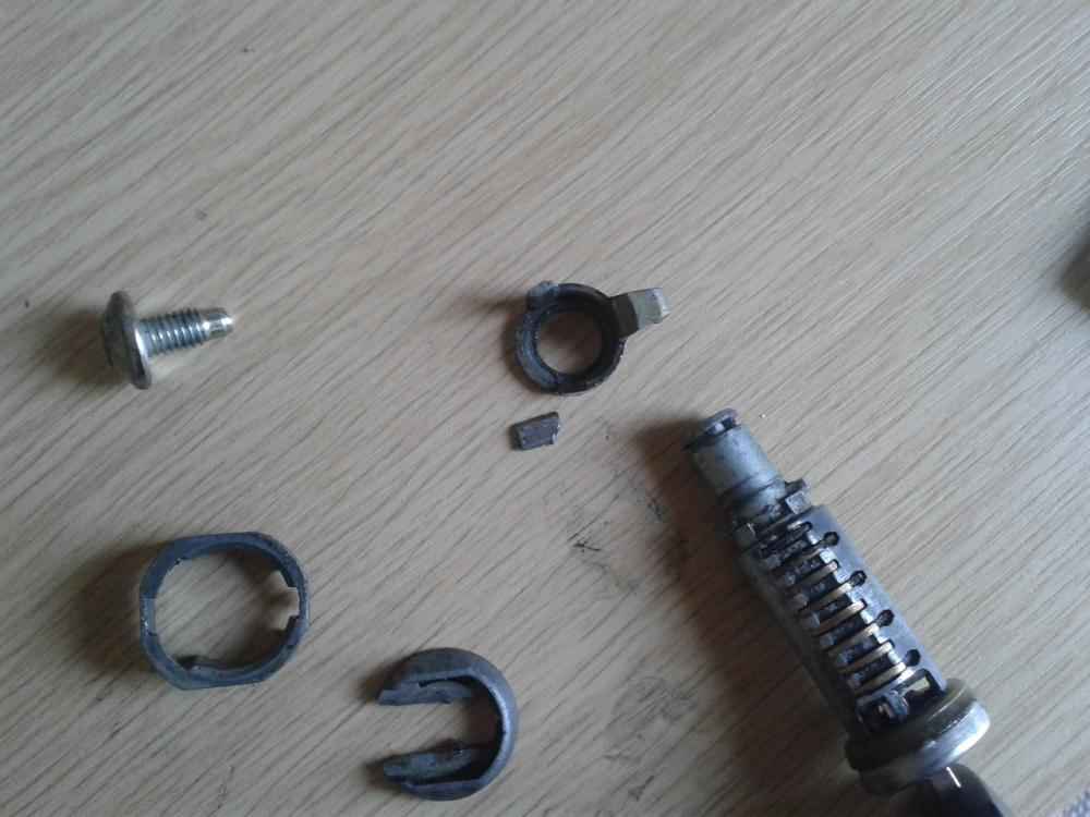

So I took the handle down. Due to the nature of key not rotating, I had to take off the door card in order to release the handle from the inside hinge. When I finally got the handle out, suprise: there was no spring or that locking bar(encircled with red in pic no. 1). I got over the initial shock and went further. Took the back end out and voila! The round thing with three bits had one bit broken(pic no. 2)
Now, if you notice in pic no. 2, one bit from those three is a bit different. It's somehow bent in a certain shape. Looked on eBay for replacement parts and it strucked me that none of the kits has that round piece with that certain shape.(pic no. 3)
My question(and please, I really need any info) is: where can I find that part? I feel that what I'm finding on eBay is not the good part for me. Further more, do I need to take spring and that long locking bar? I need to know because I want to repair the lock asap.

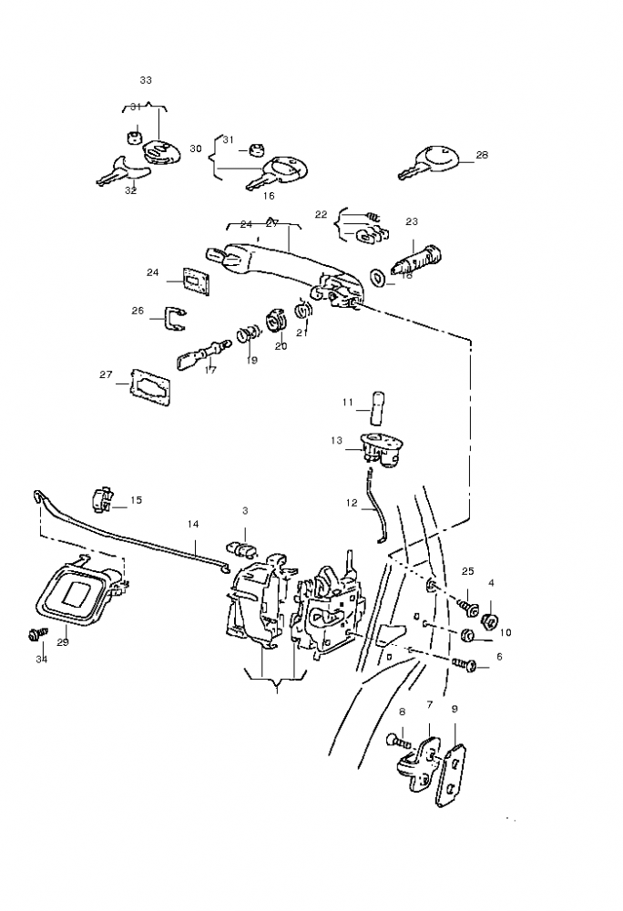

yes, but my broken part is not the same with the one from eBay. Would my locking mechanism work with the one from eBay?
Ok yours has the earlier lock/mechanism by the year it should have the one I linked too.

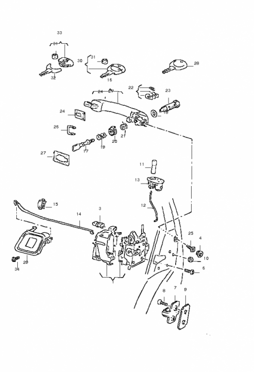

post-36925-0-00375000-1433439907_thumb.p
17) 6K4837223B excentric
18) 1H0837227 seal
19) 6N0837229B pressure spring
20) 6N0837238B driver
21) 1H0837245 torsion spring

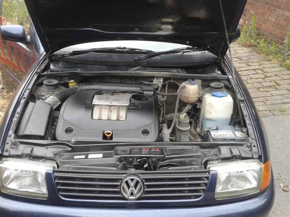

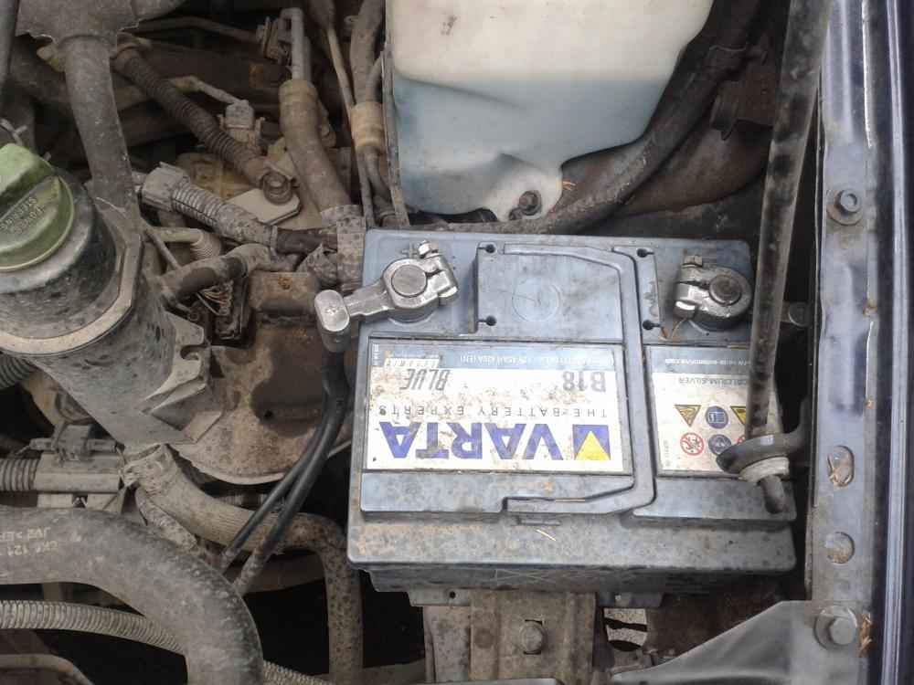

Before yesterday, the car ran like a dream. Started perfectly, moved like any '99 car but when going over speed bumps, all the lights flickered(including dashboard, interior lights). I said "ok, we'll sort it out".
Today, I put the ignition and....nothing. I try again. Same thing. Either the battery is KO(looks kinda old to me), either there are some seriously electrical problems to the car. Either way...it's not ok.
Again, the car stays :-(
A new battery will come and, after that, test the alternator. If that's not the issue, well, I have a big problem, financially speaking. Meanwhile....some pics of today

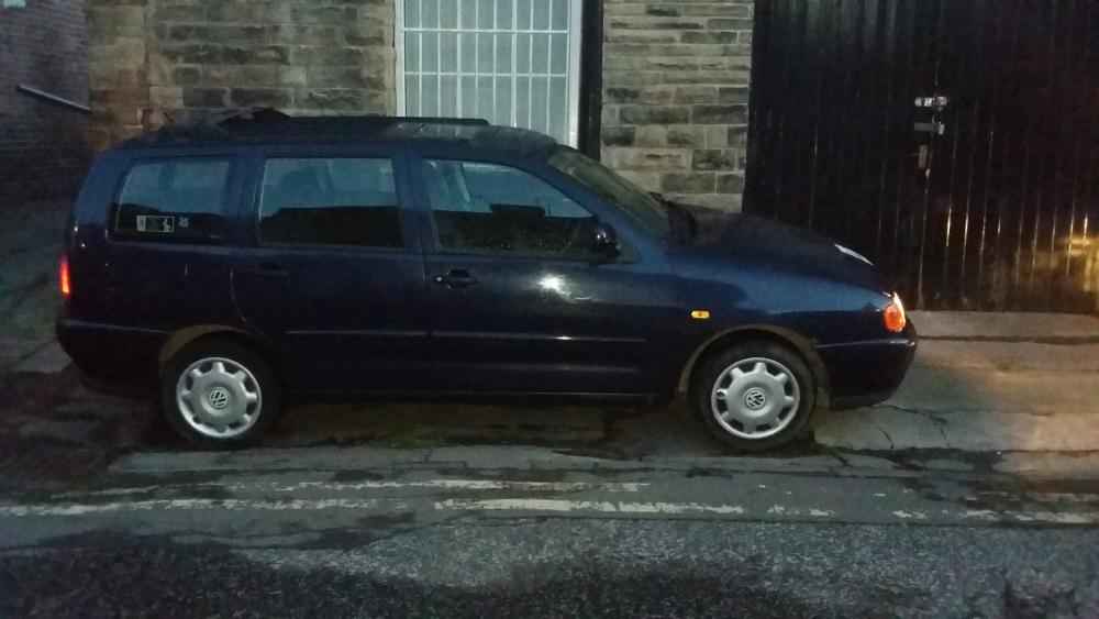

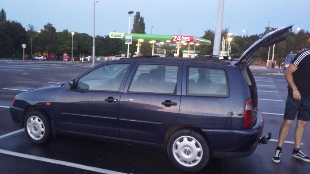

And she's alive!! After having some electrical issues(including a new battery), Ellie hit the road. Now she's fine. From time to time, the oil indicator starts flickering and beeping, but I assume that is because the oil dipstick funnel is cracked(still waiting for the part).
Meanwhile, I've rented a garage for her and, at the moment, I am still working to make the garage door work(it has some mechanical issues). Here are some pics from her maiden voyage, after some months of just sitting around

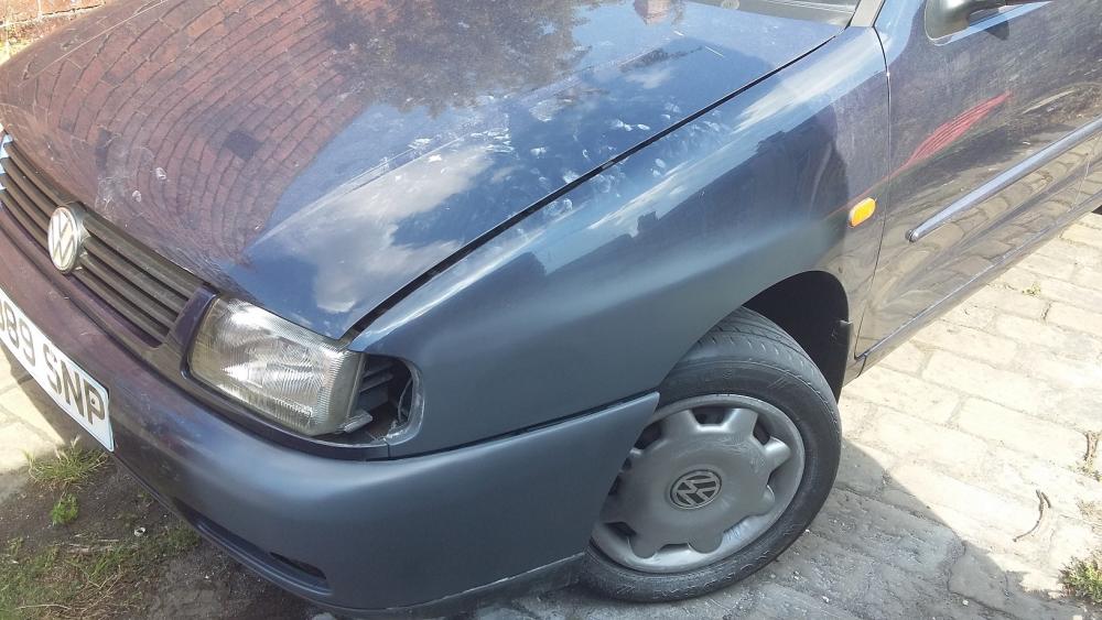

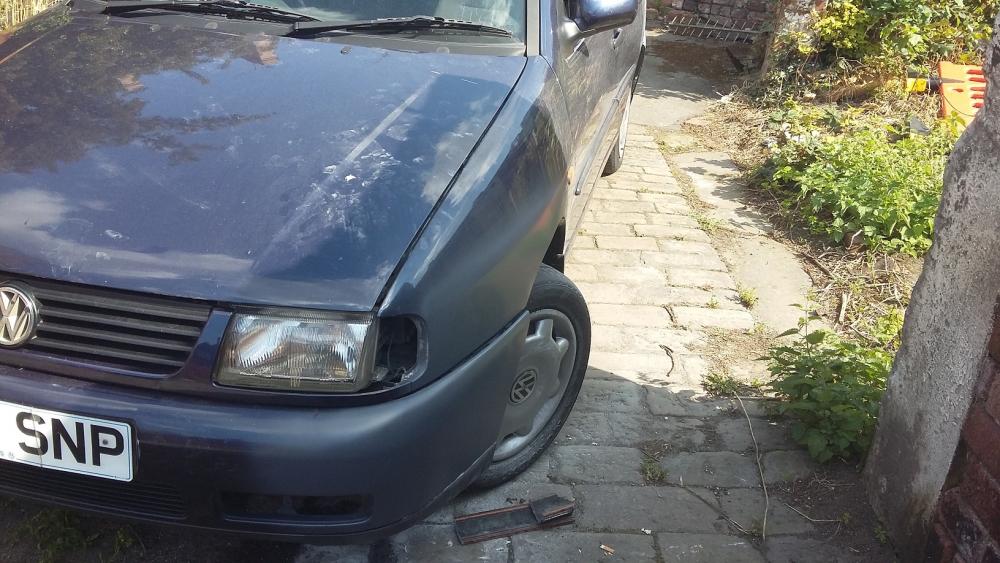

And I've started to sort out the bodywork a bit. Dents, scratches, bigger dents and patches of rust.
I can't say that I'm a professional, but I'm doing my best. In the end, it's my baby.
Untill now, I tackle the front wing problem. A big dent, thanks to a neighbour. Took the paint down, rubbed as hell to bare metal, applied body filler, sanding(geez, I'm sanding the area since 7 in the morning), now comes a thin layer of filler, then again sanding and in the end, filler. And even that one needs sanding. It's 11:15 and my hands are already protesting :D
Pics later(didn't thought to take any pics)
Finally finished the front wing. Now I have to finish the rear damage and figure out how to put back the front bumper
Oh, and Ellie got new clear signal lights :D

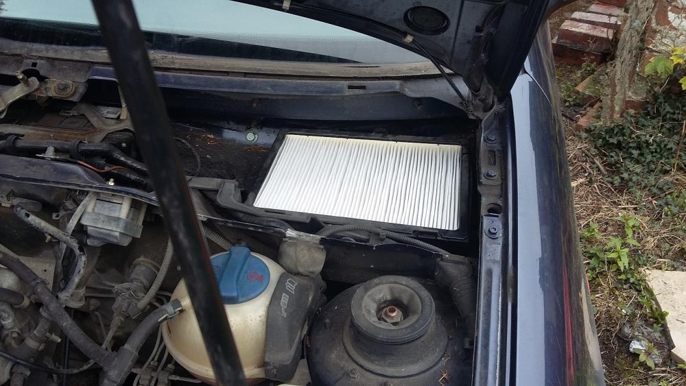

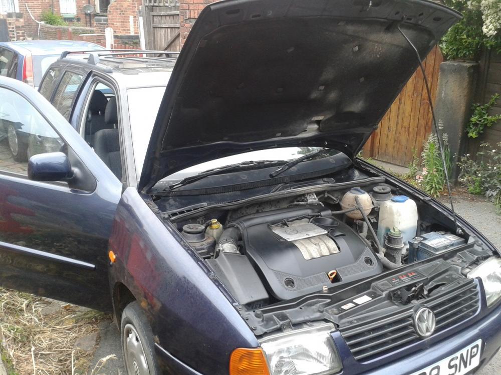

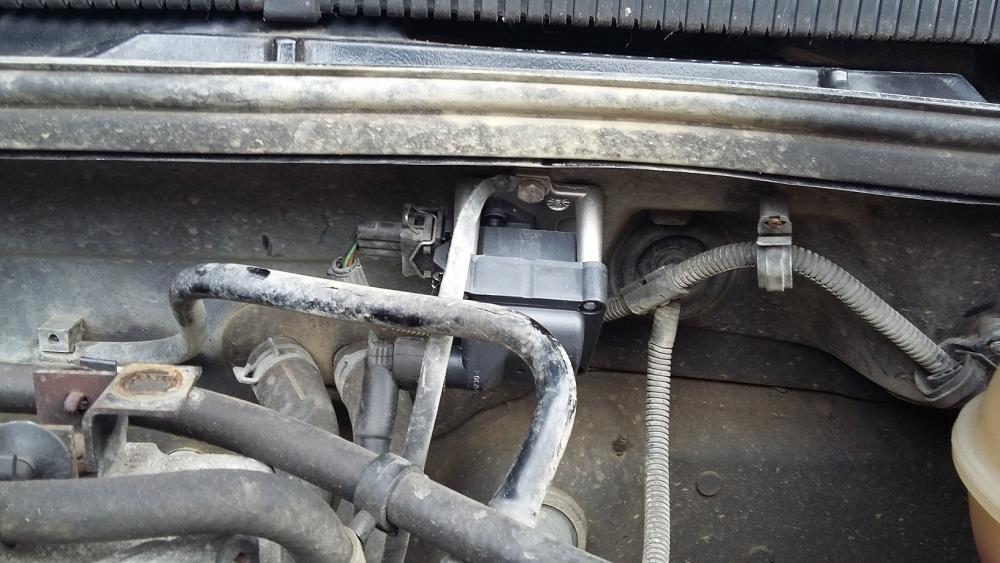

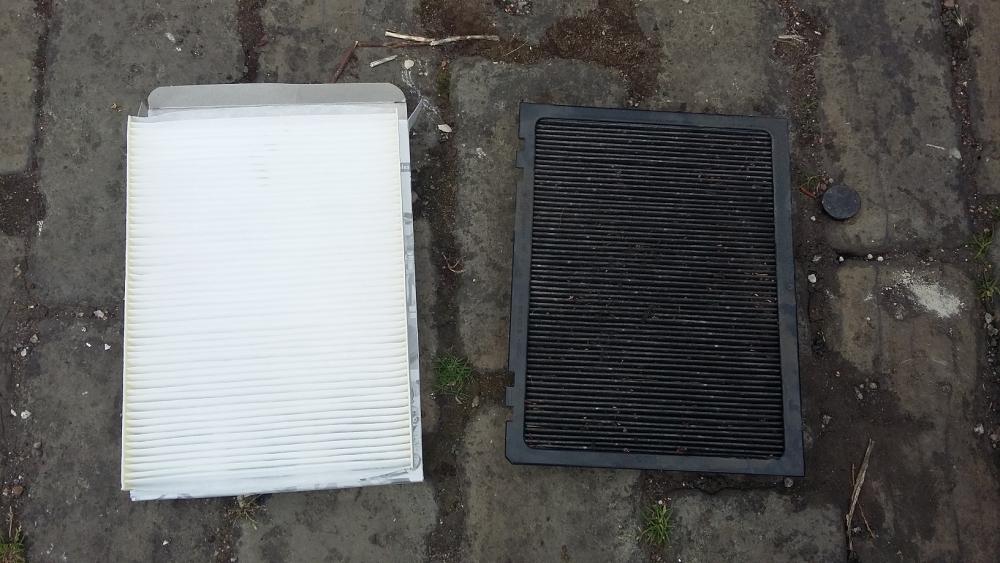

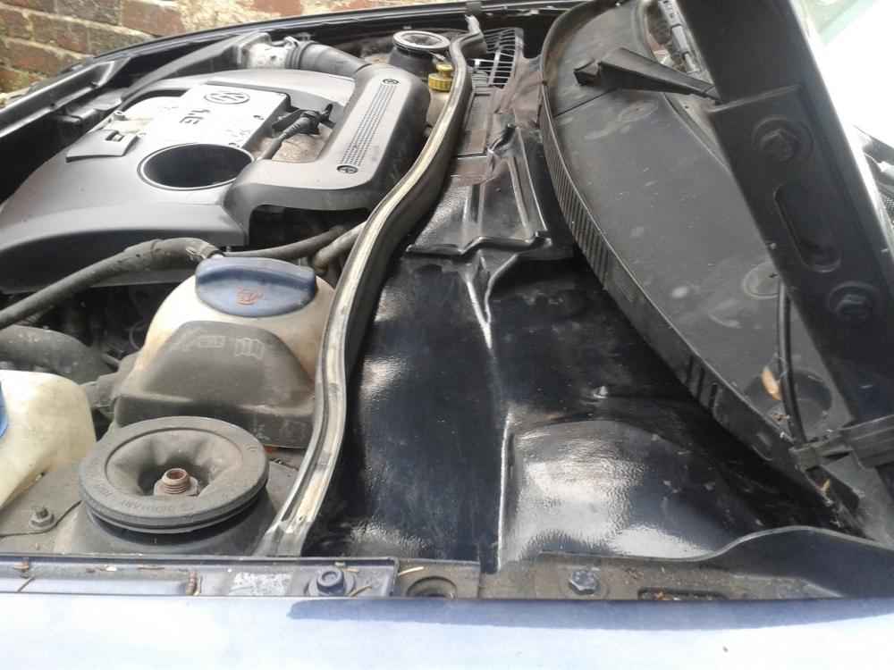

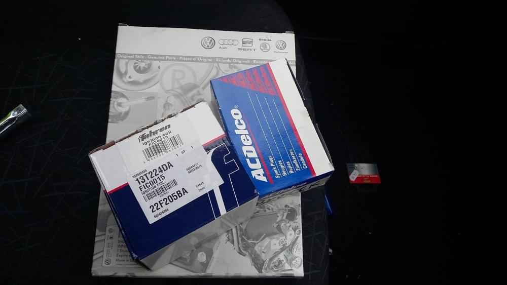

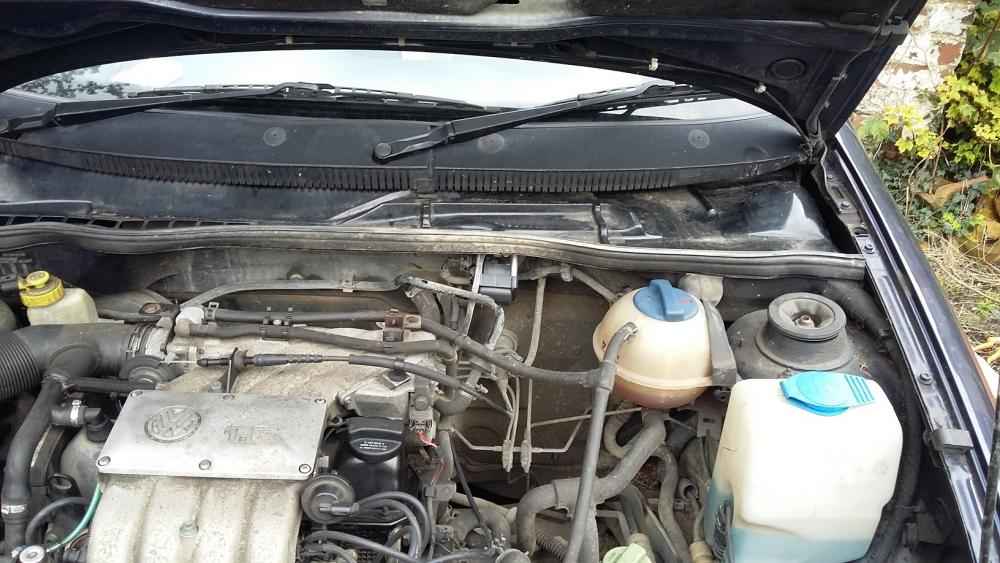

Finally, I've sorted the starting problems.

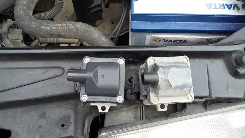

She died two weeks ago. Simply didn't want to start. Tried to turn over, but in the end, did not start. Had to let her at work and pay for recovery and a sort of repair. The guys at the garage replaced the coil pack and she started. Realy bad! I was advised that it may have problems at the air flow meter and that I should buy a new air flow meter. Quote: "let her start in her own way....don't rush her and after you can go on the road". REALLY??
But I've felt that the problem was actually somewhere at the plugs/ignition. So I've started to research.
Anyway...today, being sick of waiting a miracle or a solution, I've bought plugs, coil and since I was about to work near the windshield, a new pollen filter. Changed two spark plugs(the others are well under the intake manifold so....they stay there), mount the new coil, change the pollen filter and....the baby started at first key.
Tomorrow I will have a trip with her to see how is going. Hope that everything will be ok.....
post-920654-0-49325000-1441746697_thumb.
post-920654-0-46606200-1441746705_thumb.
post-920654-0-26623000-1441746714_thumb.
post-920654-0-08617400-1441746721_thumb.
post-920654-0-47643000-1441746729_thumb.
post-920654-0-45409300-1441746736_thumb.
post-920654-0-51659300-1441747284_thumb.

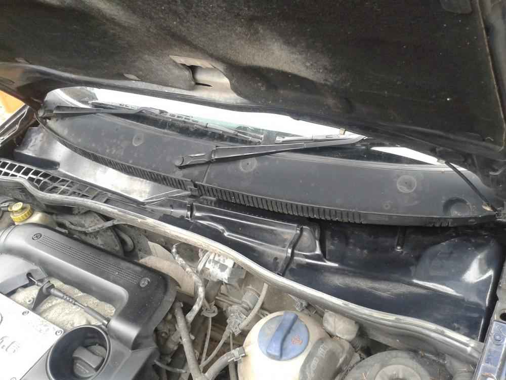

Oh, and I've got a curiosity: why the air holes on the plastic cover that comes under the windshield(and goes under the bonet also) are opposite to the pollen filter? In mainland Europe is the same thing, only that the pollen filter and the holes are in the other direction
