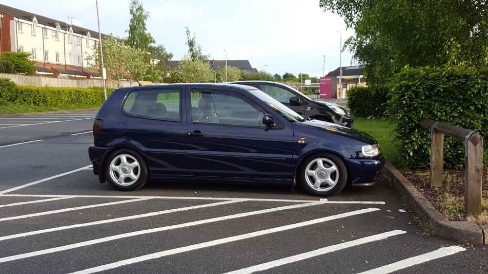

So as this little Polo is my daily, and the Jetta needs a bit of work, I thought I'd just get it looking reasonable. I got some coilovers and free wind deflectors and they've been fitted, I'm working on my cam cover to get that polished up, but I think I'll leave it there with this. It's a 57k AFH in what I think is one of the best colours for these, gonna just look after it! That said, I would love a set of fogs and a Zender spoiler. The charm with these cars is how underrated they are, just lowered they look 1000 times better, and they're so nice to drive.
Here's a cheeky pic from last night. Looking forward to the Polo Social now!
^^^ How low is that?
Nimal
No idea to be honest. Front mud flaps are around 2cm off the floor.

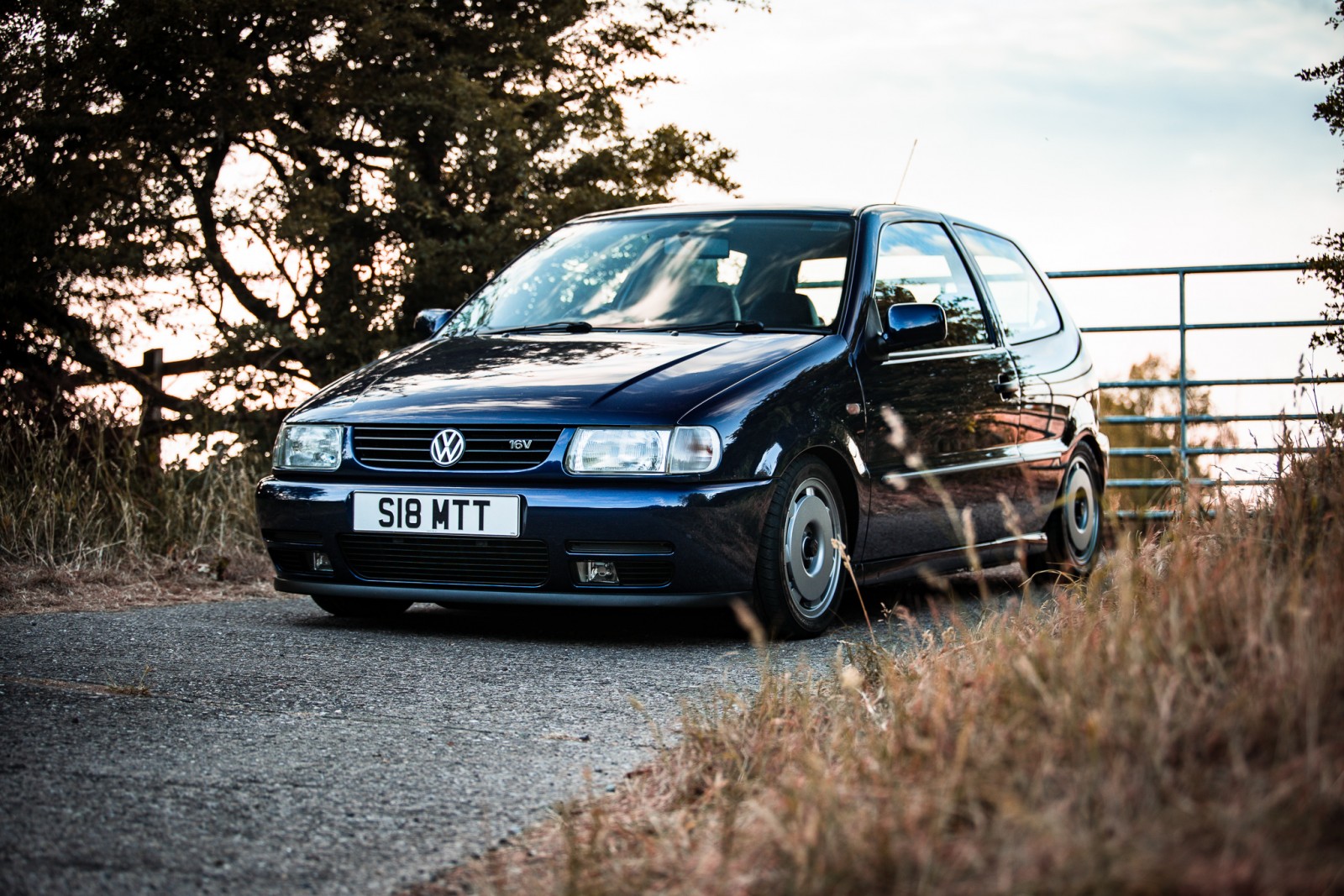

Thought I'd update this as it's been a while.
I've still got the car, it's been my daily for over five years now! I've just kept on top of things with it and kept it well maintained really.
I've ditched the wind deflectors for now, swapped over to my other wheels as they had good tyres and were just in the garage on my Mk1 Jetta. Here's a recent photo! Hoping to get along to the next Polo Social.
