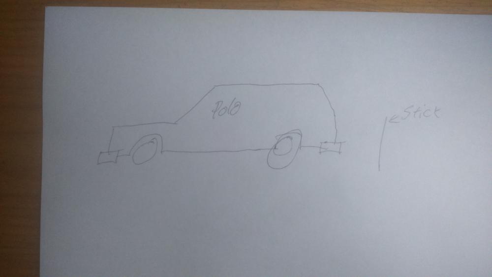

Get a polo
post-3073-0-83038700-1435858165_thumb.jp

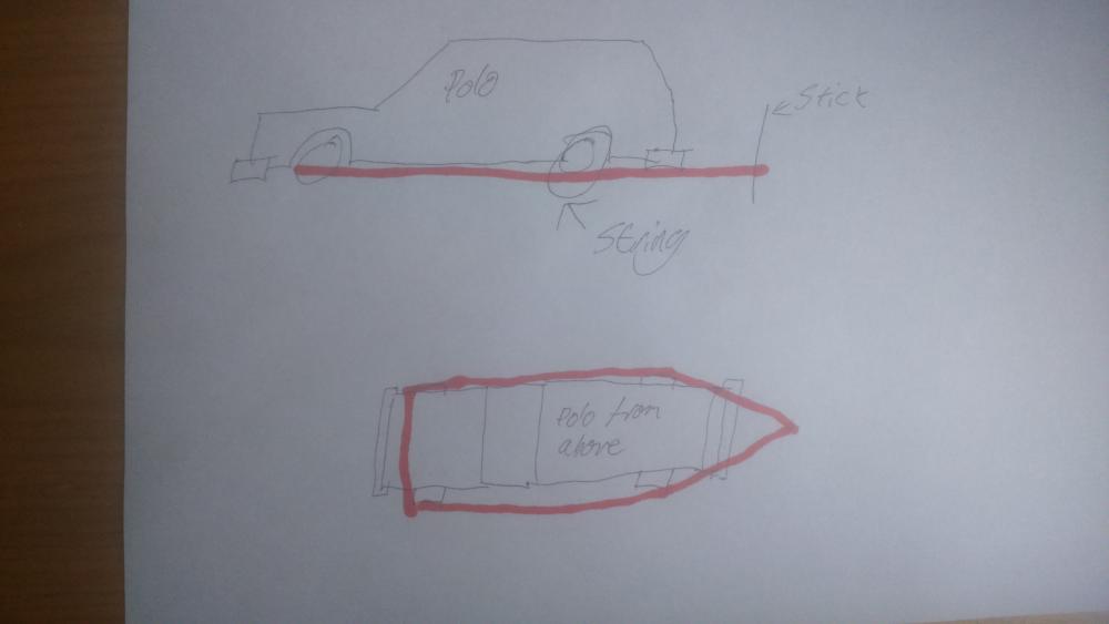

Tie some string round the wheels
post-3073-0-05190100-1435858160_thumb.jp

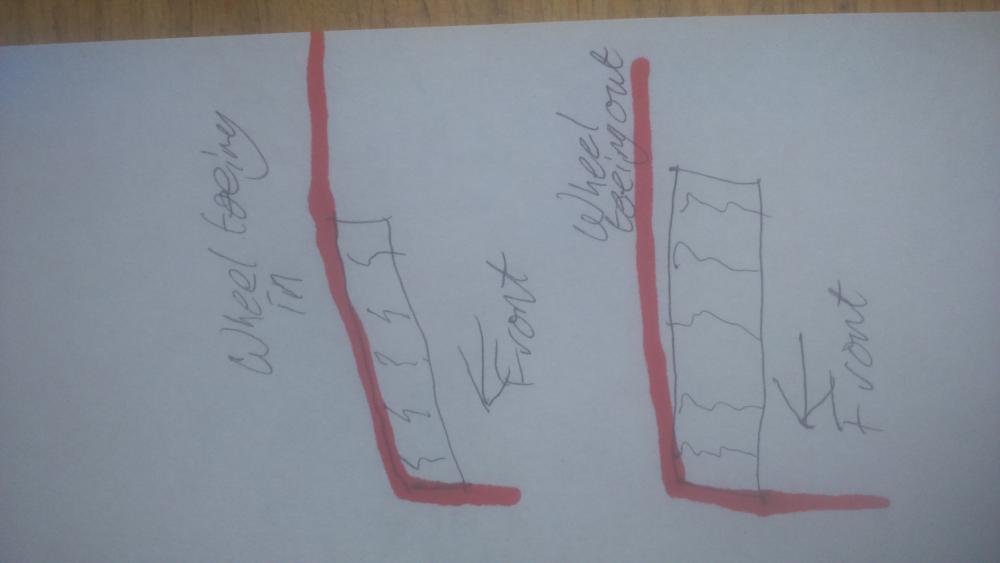

Look at how the string lies across the front tyre walls.
post-3073-0-37388600-1435858154_thumb.jp

Okay I get the set up now,
so if I measure toe out do I measure with a rule from the centre of the front wheel to the string in mm?
