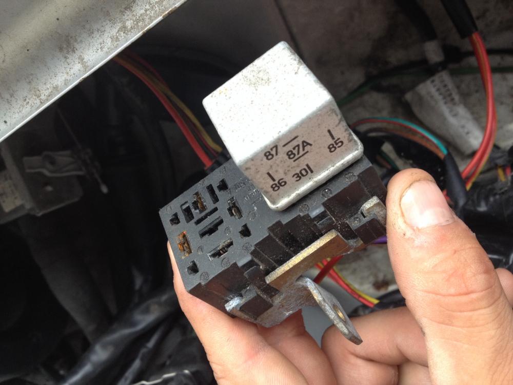

Having abit of trouble with the fuel pump relay (left relay which is missing), I have a constant live (pin 30) to the relay but no switch live? Any ideas?

Lookin at the wiring diagram and it looks like the relay is controlled by the ecu and I'm not running one... I've bypassed it with another relay and wiring but the pump is on and staying on, I'm sure before it would prime then go off... I do have the origonal 1litre pump and lift pump... Any advice?
