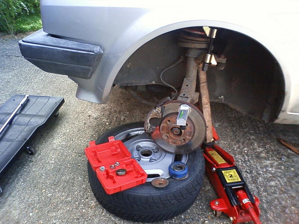

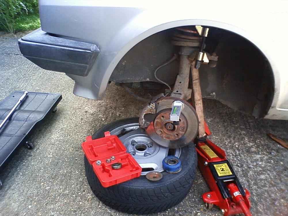

So no detectable issues with top mount bearing or ball-joint. but two things.
  1. a spacer missing on nearside (I fitted a spacer to protect the supposedly chocolate bonrath bearing)
  2. I noticed the nearside tyre has some outer edge wear.
- refitted the spacer - a bearing from an old top mount.
- I rotated the top mount to correct the camber (back to negative 0.5 unweighted?) and keep almost same castor.With strut back in and a camber gauge on the disk and TCA balljoint and ARB nut back in place I lowered the car to level. I think I now have camber equal left and right but I checked offside on wheel rim and made no special reference correction for any driveway sloping.
Both strut tops now look the same.
Certainly feels more balanced on a short test drive.
