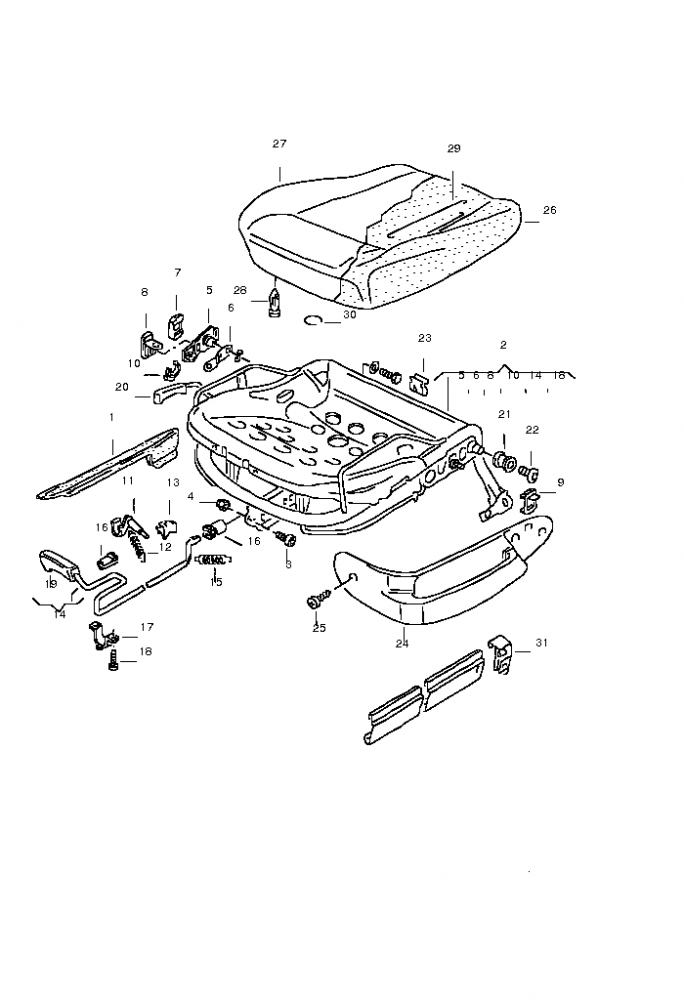

7) 191881213 glide piece inner /
7) 191881213 909 natural colours
9) 171881213B glide piece outer /
9) 171881213B 2VK platinum
post-36925-0-40425400-1435155326_thumb.p
Thanks the part numbers nige, as useful as ever! I am curious about part 8 on the diagram as it looks similar to these parts but I'm not sure that it's on my seat either...
Anyway, I have found the below and was just going to buy them but...

8) 357881195 stop buffer
13) 435881203A glide piece front /
Yes slide the seat fully rearward till the feet come out of the track, then clip the guide pieces onto the feet, slide back forward refit bolt/nut :)
# 13 is the guide at the front of the seat where the nut/bolt rail slides
