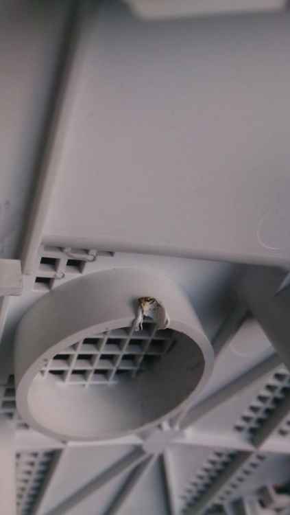

For some reason I decided to mount my speaker on the outside rear of the clocks, to be honest it could be mounted inside to make it neater. If you do decide to mount it outside, cut or melt a notch in the ring on the back cover of the clocks where it meets the speaker and then feed the wire out through the grille on the back cover.

Screw the clocks back together and mount your speaker. I hot glued my speaker to the back of the clocks in a location that wouldn't foul the mountings.
