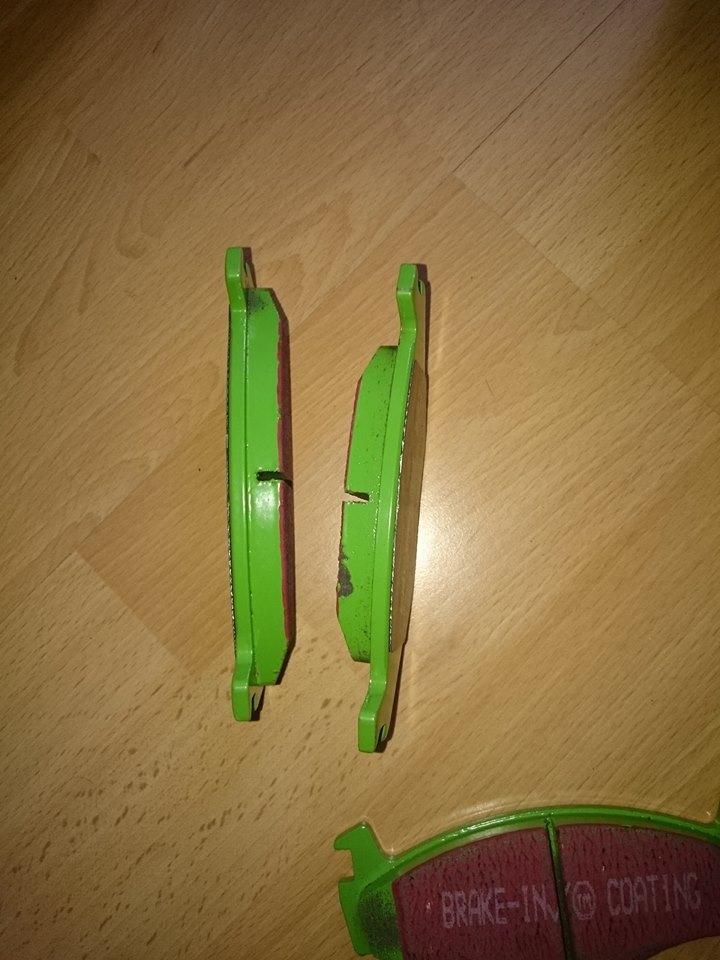

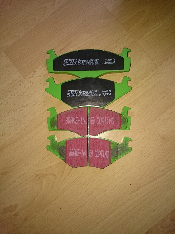

Is this right? two different size pads?

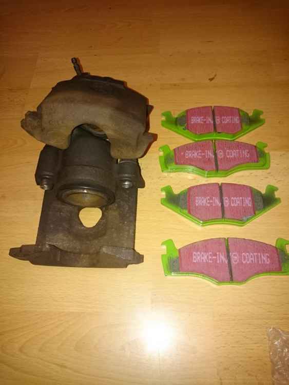

Also am I missing some bits? This is all that was in the box. Literally all I have is the pads and the calipers and discs. Is there meant to some anti-rattle/squeal shims or something? (vw2 upgrade)
Yes all the sets come like that.
I put the larger pad on the outside and the smaller pad on the inside. Don't know if that is correct but it makes sense in my eyes due to the caliper design.
You may have to buy the anti rattle shims on their own...or reuse your old ones if you have.

Thanks mate. Just to clarify, this is all I have:

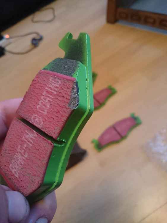

And should I be worried about this little bit of damage to one of the pads?:

That should be fine, but I would say something to EBC if you're giving them feedback.
