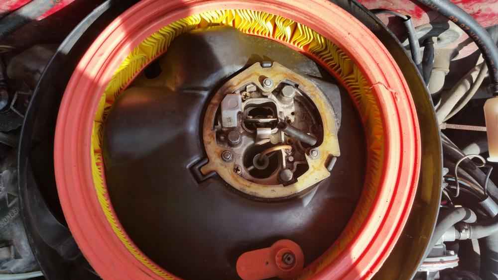

Hi guys attached hopefully 2 photos from my carb. On a cold start it runs fine with the vent closed. The problem is it stools after a few mins and the vent is open fully allowing an incorrect air to fuel ratio, so I believe. Is this the problem and how do I fix it. Many thanks

When you say vent, are you refering to the choke flap? This should be fully open when choke is off (engine 'warm').
When choke is active, idle speed will be high enough to conceal a poblem with the anti-stall device.
Please post model of carb - or photo with air filter housing removed. Different carb types have different ways of maintaining idle speed. May just be a vacuum hose adrift.

Take off the air cleaner cover and check that the choke is going 'off' (opening) when the engine is hot.
2-3 minutes is not a lot of time for it to get hot though, so it could still be that the choke is opening too early - If it is opening within that time, the adjustment probably needs turning slightly towards the '+' mark.
