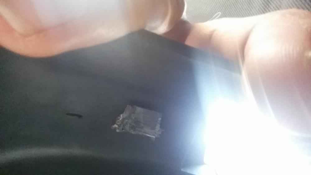

Can someone post a picture of that peg under the centre console?
I know where the bracket is, but is it possible that the peg broke?
someone?
OK so I took the CC apart and had a look at the bottom, seems like the peg itself is broken
Have a loo at the attachment
