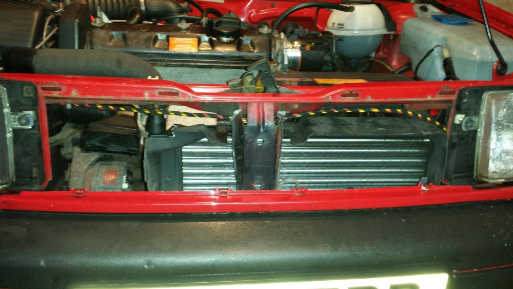

I'm looking for a set of clips that are along the bottom edge of the opening at the front of the car. Photo shows the grill off with two of my clips broken. Anyone help? By the way it's a coupe 1991

Anyone out there breaking a mk2f coupe? These clips are on the lower opening of the grill area. Helps to hold the grill in place and stops it rattling.
Someone must be breaking a mk 2f coupe on this forum. Just have a quick look behind the grill.

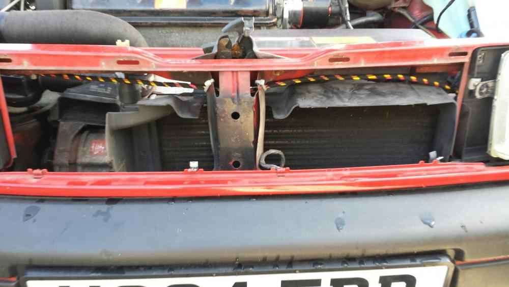

Do you mean the 4 along the bottom metal piece? On mine they are only for holding the wiring in place? But on yours the wiring seems to go along the top.
The grille on mine has probably never come off before, but I did not see any clips along the bottom edge, only at the top.

Thanks for your reply. The clips are across the bottom as seen in the photograph. They hold the cable behind the lower edge but also the act as a securing position for the grill. My grill is very lose and rattles. Two of the clips have broken as seen. May try dealership but thought I'd try the forum first, probably not on the Heritage web site.

On mine it had all 4, but they where not fitted where your are, they where next to these raised parts.
The grille has 4 "feet" these slotted onto those raised parts, then the clips are at the top.
The clips for the cables did not point up they pointed towards the radiator, so clipped onto the flat part of the metal (if that makes sense?)
I would suggest bending or lifting the metal part so it is a little higher, this way the grille would be wedged making the top clips sit snug against the top of there holes.

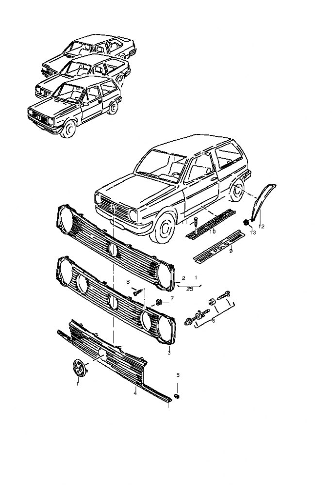

Definitely worth a try. This is the part number and number 12 on the diagram
867971897

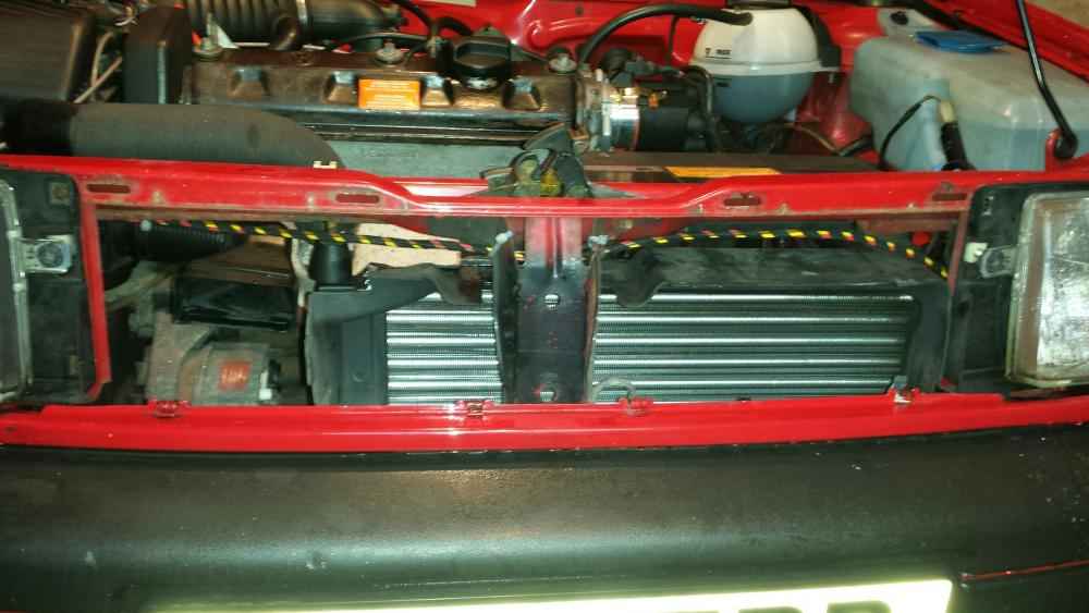

At last! Done. Finishes off that area.

They look like metal clips?
Did they solve the rattling grille and did the grille fit back properly with them fitted
