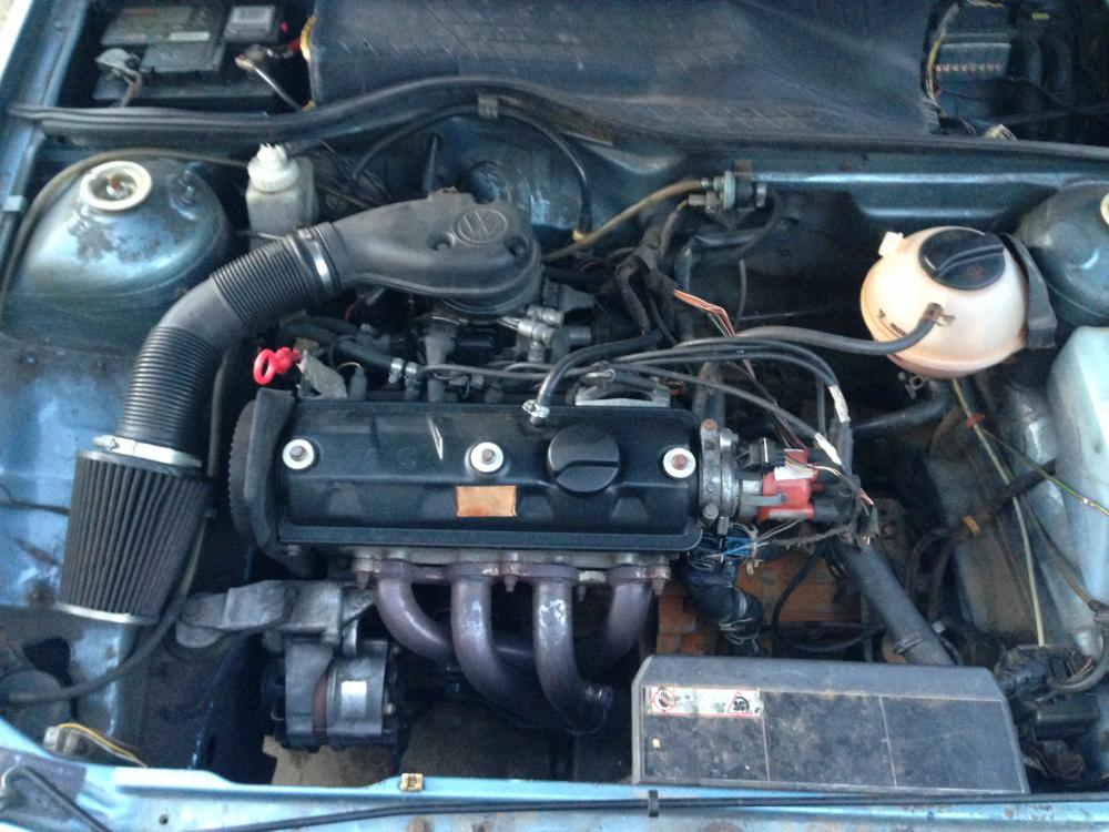

I'm lewis and new to the polo world... Just bought myself a MK2f 1.3 GT as a project hoping to bring here back to its former glory.

  • Hi guys ... Yes unfortunately I had feared this as he told me it has had a engine replacement but haven't got round to checking yet ... Only poaid 200 or it so the gamble was reflected in the price. O
Hello and welcome.
I'm really sorry to break this to you but your 'GT' does not have a GT engine. Yes it is registered as a GT but someone has fitted a single point injection engine :-(
I hope you knew this already and best of luck in restoring her :smile:
hoe you didnt pay over the odds for that as its a 1.3 55bhp engine rahter than the 1.3 75bhp
i'd get onto the seller as thats probably worth £200 at the most
Hi guys ... Yes unfortunately I had feared this as he told me it has had a engine replacement but haven't got round to checking yet ... Only poaid 200 or it so the gamble was reflected in the price. On the hunt for a GT engine ... :)
I would check that it hasn't been stripped of other GT parts like the rear beam and the fuel pump too, though saying that the expansion tank is still there.
Did the seller say why the engine was replaced?
At least you knew it was a gamble. You'll want to check the gearbox code too, see if that is a GT one or not.

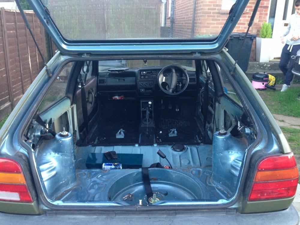

What's the differences between the GT rear beams ect ... I could upload some pictures of this later for you guys to confirme or not .. That woul be much appreciated :)

The rear beams have an Anti Roll Bar built into them on the GT, it is pretty easy to spot as it is just a bar that runs along the back side of the beam.

Soo I've checked the gearbox ... It's a CEG box ... Guessing not a GT box ... I also can't see an anti roll bar on my rear beam .... Looks like I've been we'll and truly GT stripped :(
At least a CEG 'box isn't a bad gearbox. Sounds like maybe your car was used to convert a 1.3CL to a GT....

I would recommend trying to get a GT rear beam if you can, these Polos don't handle well at all so little differences like the rear ARB do help. The fuel pump on the GT also flows more but I have heard of people running conversions on the normal pumps and having no issues. But I'd rather run a GT one if you can.

On closer inspection ... turns out i do have a GT rear beam and a GT fuel pump :) Bonus !!!!
so must have just been the engine swap after all ...
