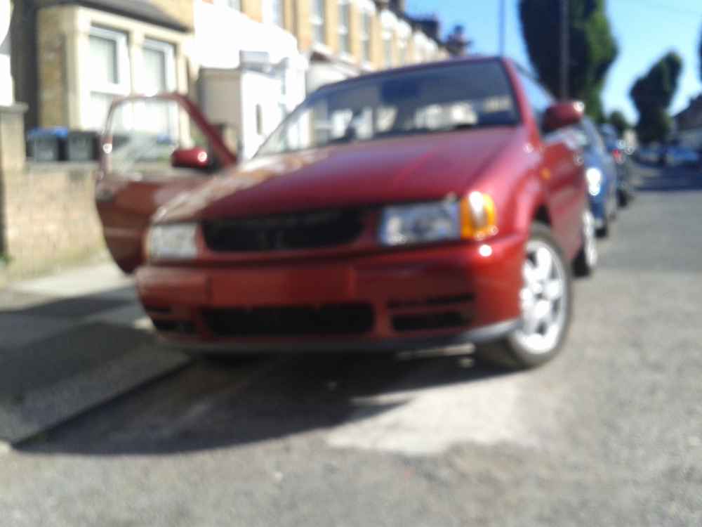

'My Lil Polo 6N Canyon Red Nearly AFH'D'
Doing some good work there mate,was the engine an easy conversion?
Thanks. well my friend did the conversion and was easy too do, basically just swapped the whole front end from the doner too mine engine,box,suspension,brakes,pas,anti roll bar,exhaust. He usually deals with audi s4/rs4 and vag engine swaps etc soo the polo was a piece of piss.

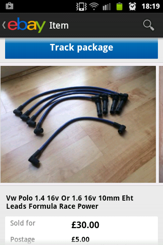

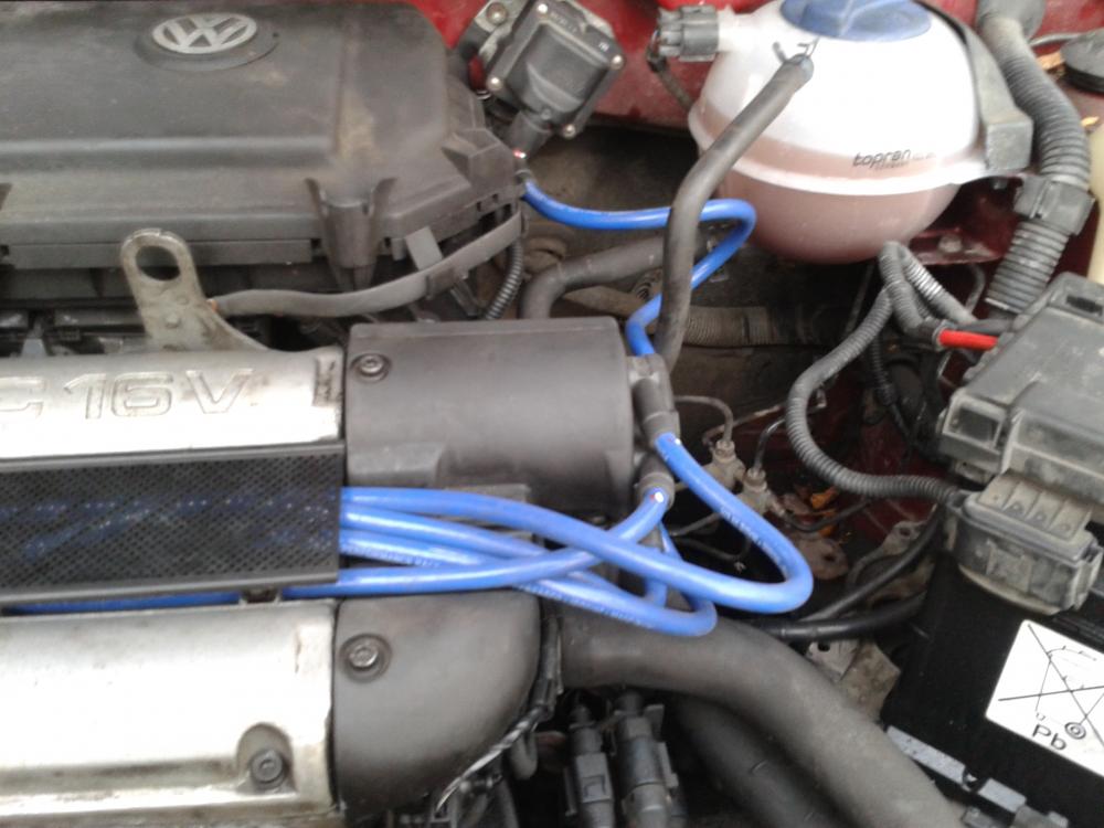

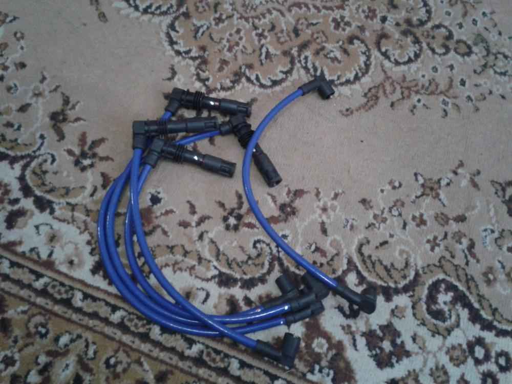

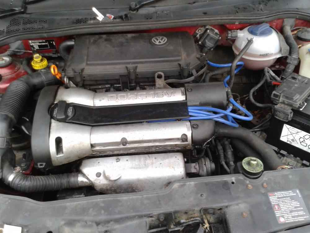

Bought some second hand race power high energy 10mm ht ignition leads because when i bought my doner car it had a slight misfire .
post-920579-0-98641700-1460394903_thumb.
Bargain at 35.00 as they normaly retail 70.00+
post-920579-0-42402300-1460394969_thumb.
shame they dont fit in there holder as there bigger than the originals.
post-920579-0-55275300-1460395878_thumb.
post-920579-0-29590100-1460395924_thumb.

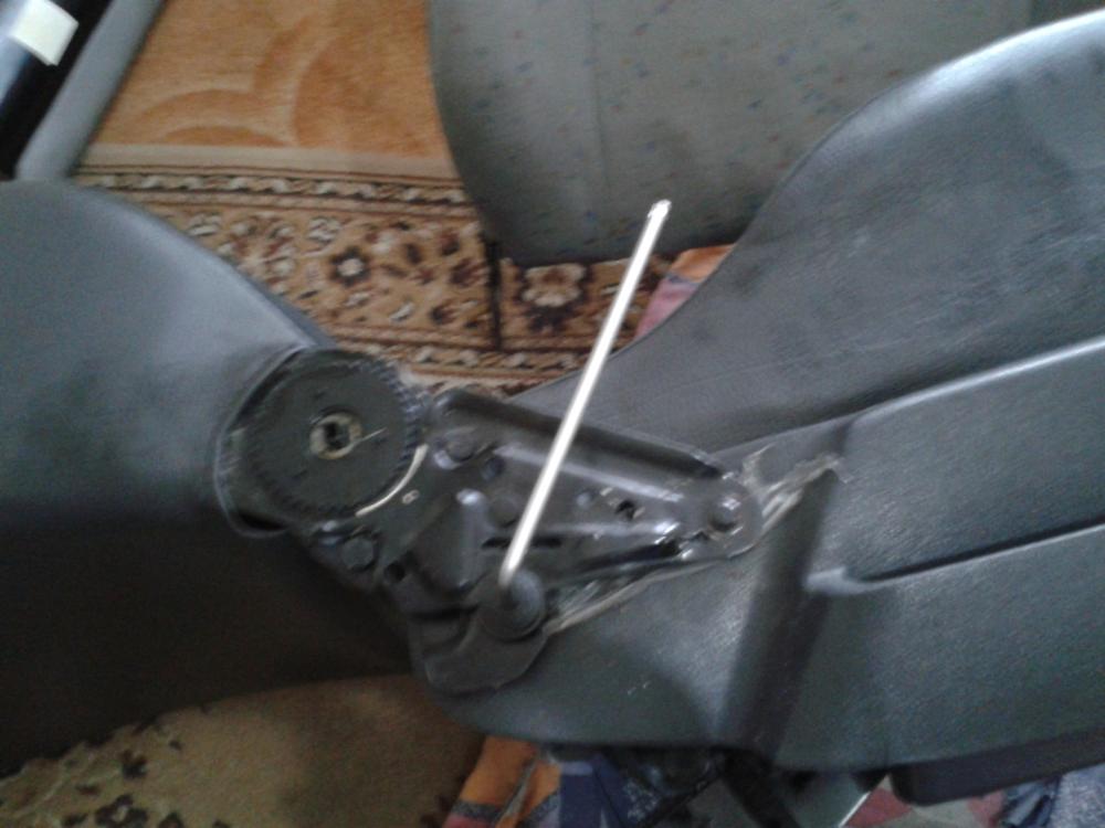

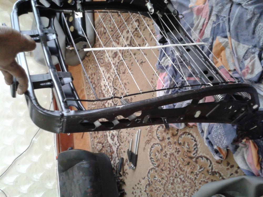

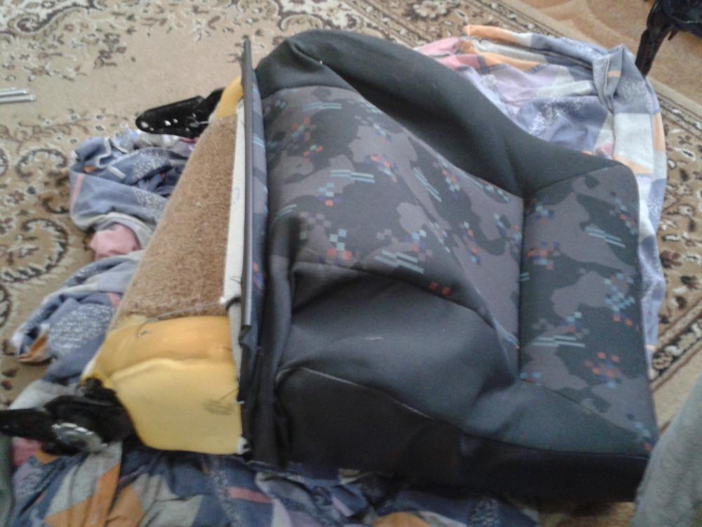

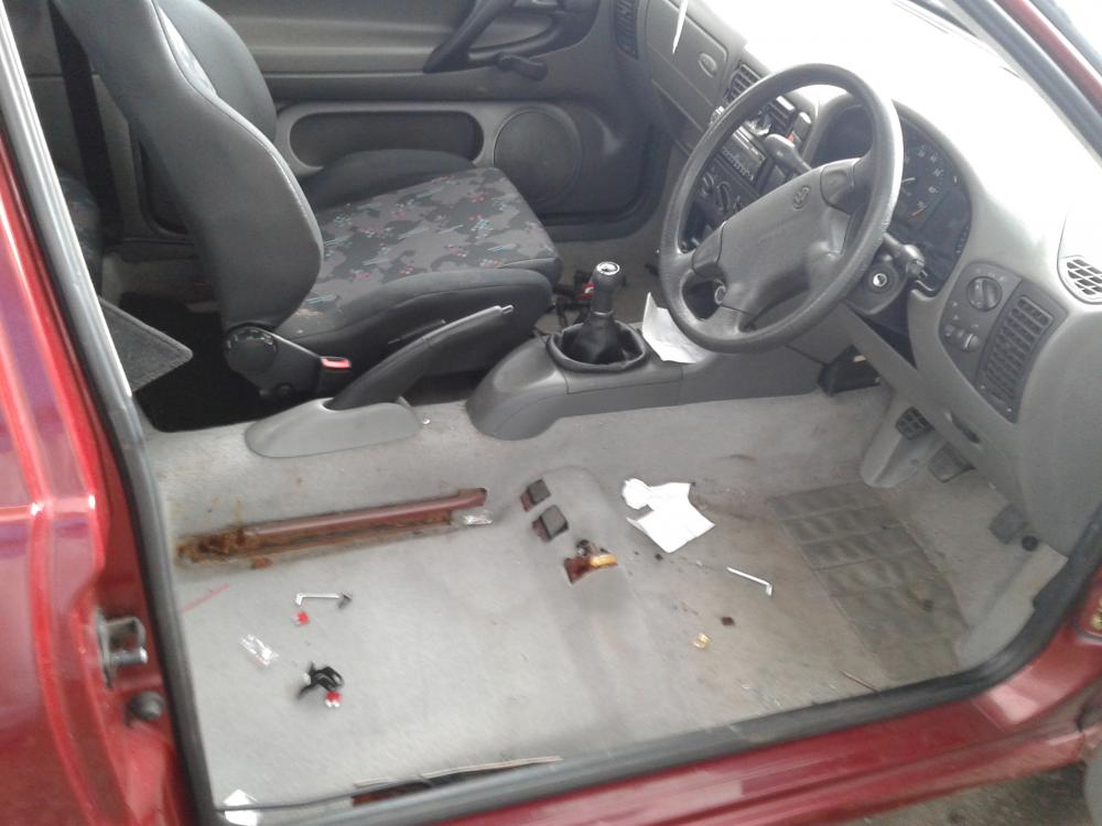

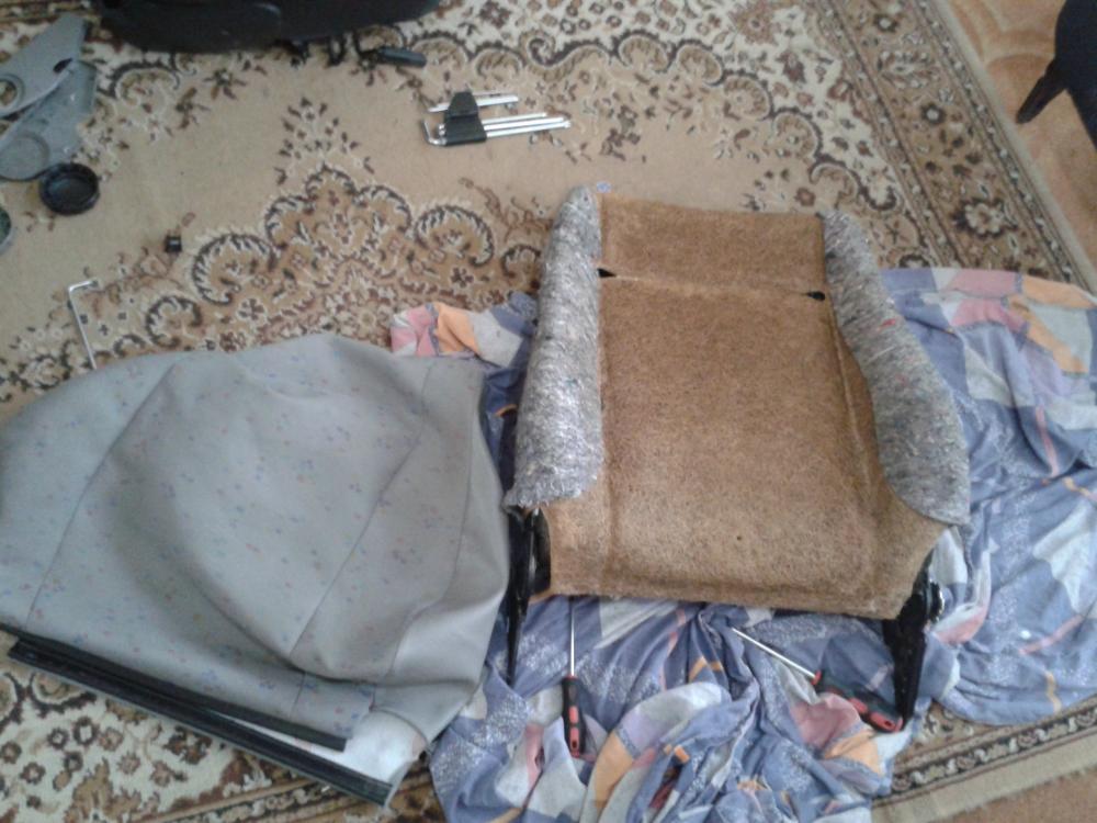

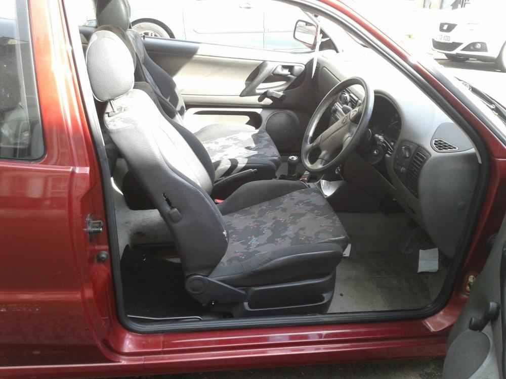

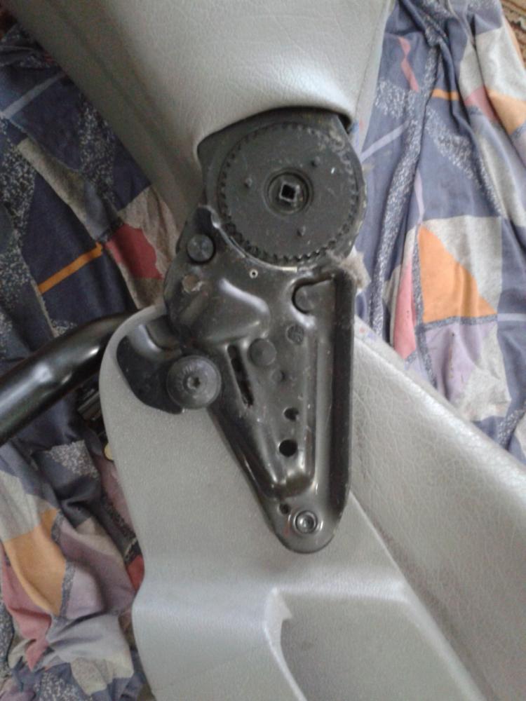

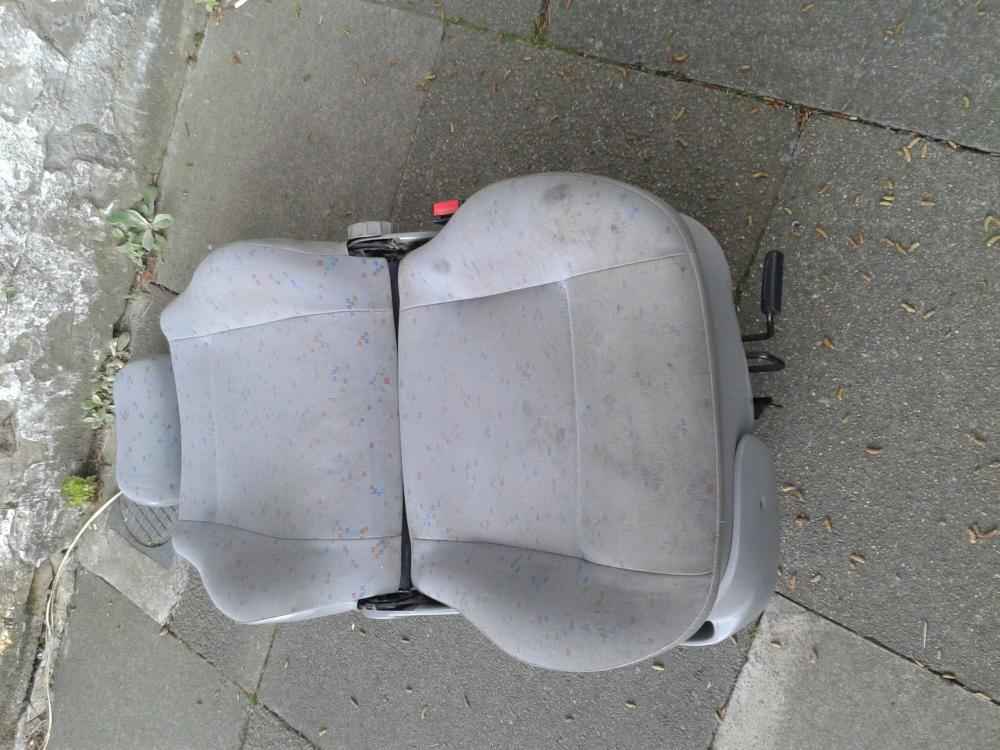

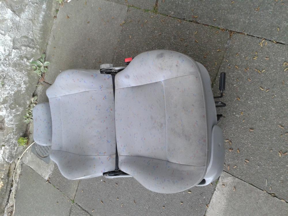

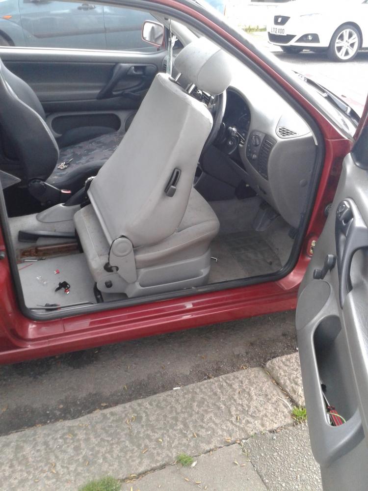

Today is my day off. Soo i decided to remove the driver's seat
post-920579-0-04937400-1460477638_thumb.
post-920579-0-84181400-1460477679_thumb.
post-920579-0-92653100-1460477822_thumb.
drivers seat removed

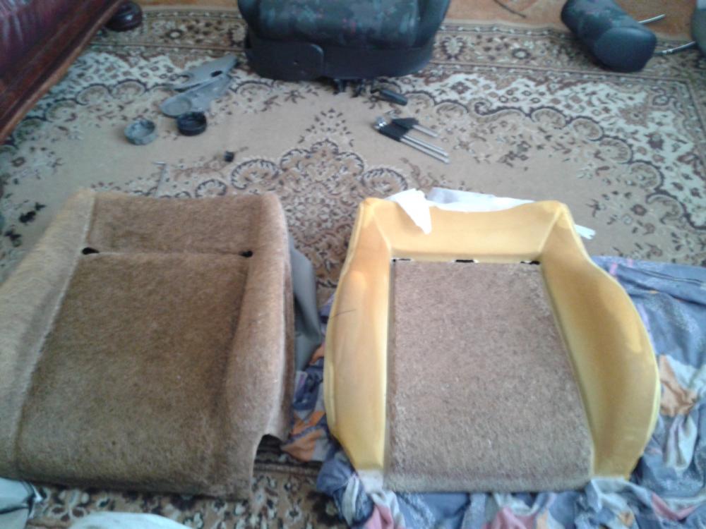

Now again remove the back of it
post-920579-0-58641900-1460478048_thumb.
post-920579-0-58202500-1460478355_thumb.
post-920579-0-12478000-1460478590_thumb.
post-920579-0-03955600-1460478631_thumb.
post-920579-0-65979200-1460478765_thumb.
post-920579-0-86411700-1460478820_thumb.
attached the 16v foam bloaster to the 3door tilt & recline frame
post-920579-0-06604900-1460479453_thumb.
and all finished. Just need to get a new plastic trim cover for the tilt handle as mine was already broken :x .Nimal

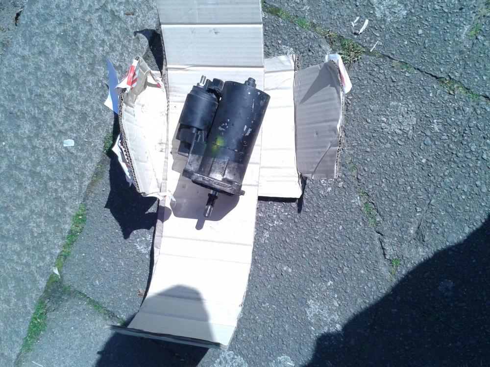

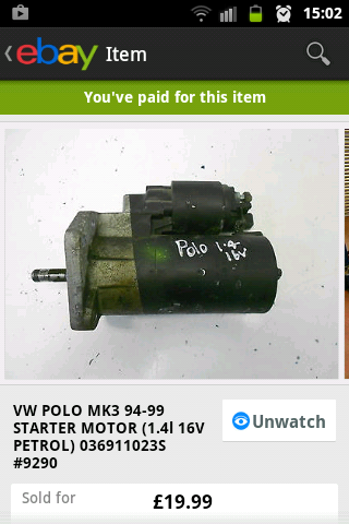

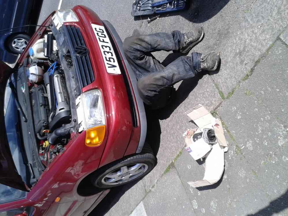

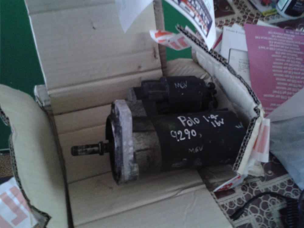

No updates really went in a big puddle on friday and 30secs later the car cutted out. Tried starting it and smoke was coming out of the engine bay with a burned smell. 15 mins later tried start it and it was making a whiny electrical noise . Soo basicaly my starter motor is fried.
Bought a replacement off ebay for a score.
post-920579-0-34307900-1460988412_thumb.
Edited by madnemo
The quickest delivery I've had from an ebay seller. I've bought my starter motor yesterday and it turned up today :D :D
post-920579-0-83754200-1461075413_thumb.
post-920579-0-51617000-1461075446_thumb.
My friend attaching the new one
post-920579-0-05231000-1461075516_thumb.
post-920579-0-46385300-1461075722_thumb.
^^^^^^^^^ old starter motor which smelt burnt .
and it starts :smile: :smile: :smile: :smile: now.

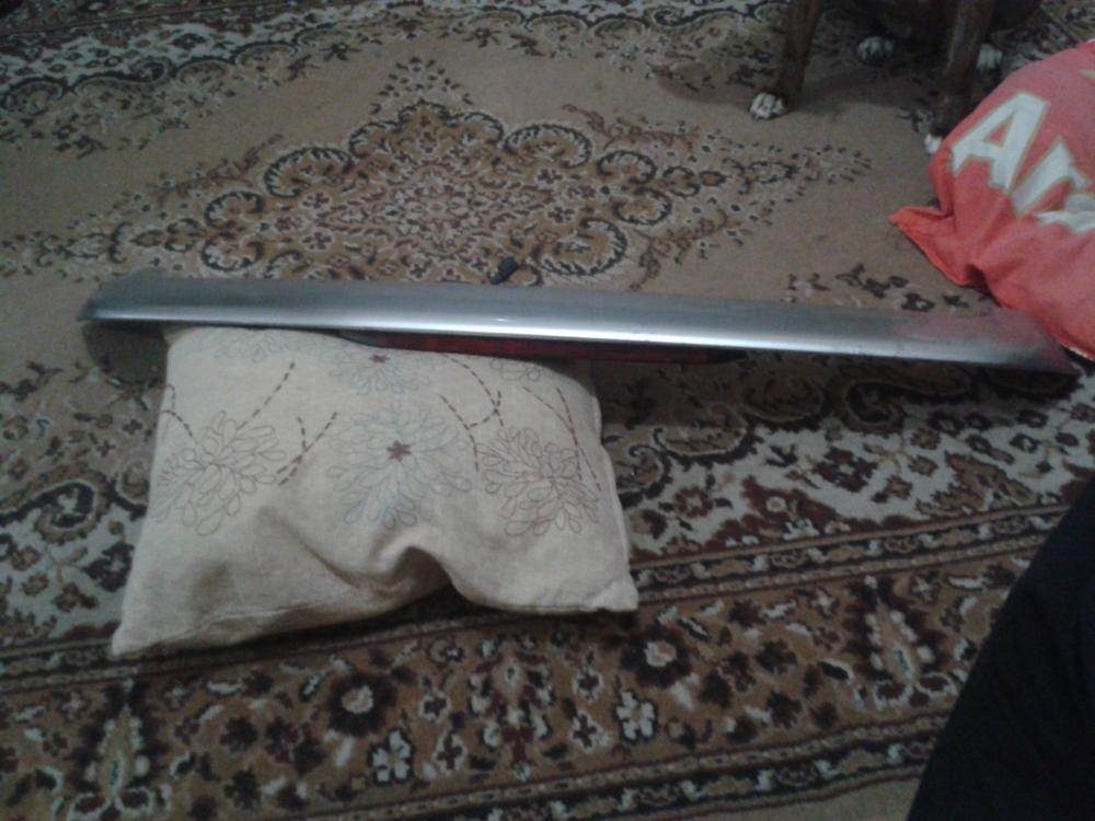

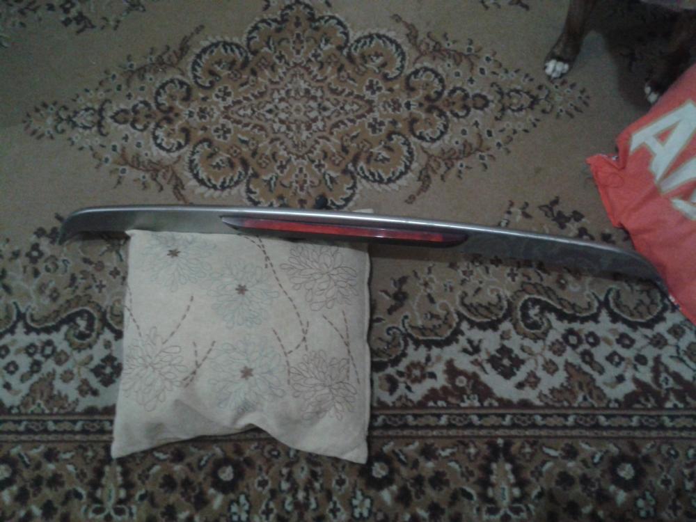

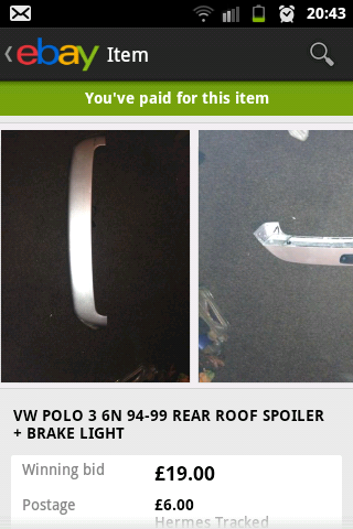

won a 6n roof spoiler with brake light cheap off ebay. Genuine too. :tongue:
post-920579-0-59709700-1461354841_thumb.
arrived today bargain at £25.00 with postage
post-920579-0-36637100-1461354896_thumb.
post-920579-0-10148900-1461354929_thumb.
Just saving up to get my 16v front bumper sprayed and get the spoiler done at the same time.
Nimal xxxx

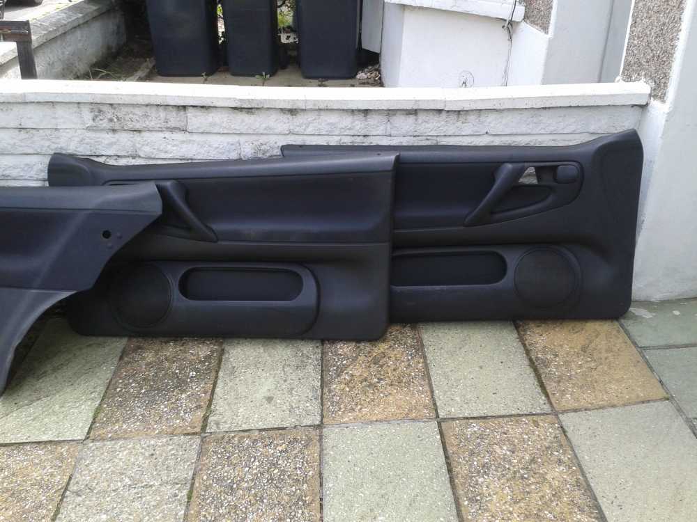

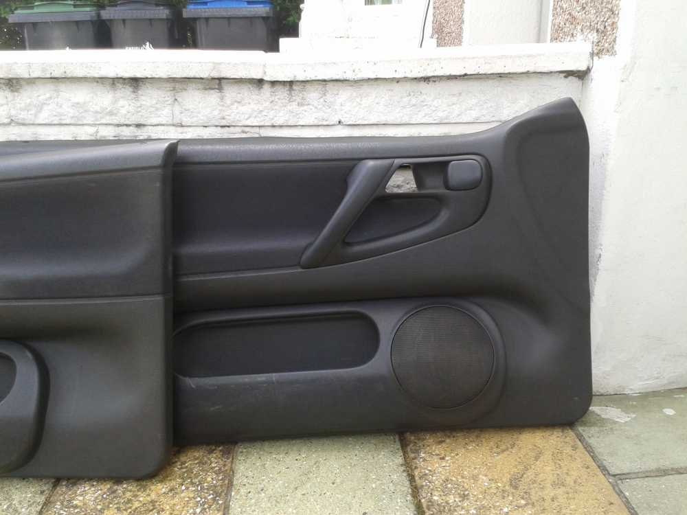

No Real Major updates. I took a trip to Basildon to collect some 16v door cards front and rear for a tenner off here. Bargain.
image hosting more than 5mb
Rear door cards has golf mk3 speaker grills fitted.
image hosting services
image upload without registration
^^^^ original poverty spec door cards all plastic and ugly
free upload pictures
^^^ removed both rear door cards
adult image upload
img upload
^^^ fitted both 16v rear door cards.
will fix the front door cards once i sorted my electric windows.
Nimal x

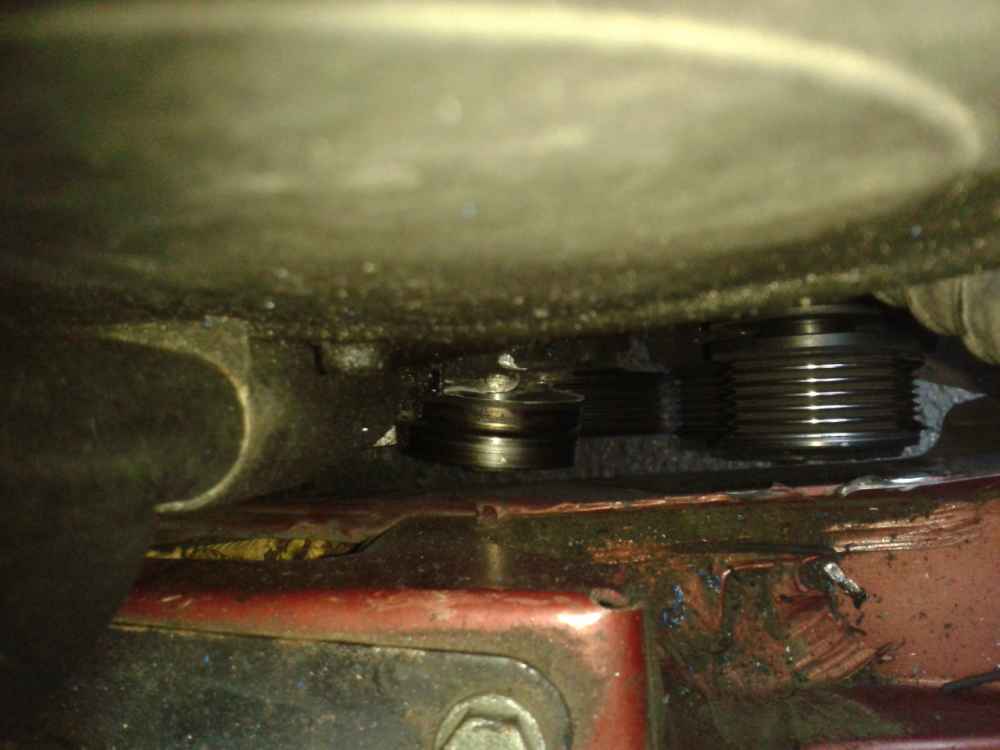

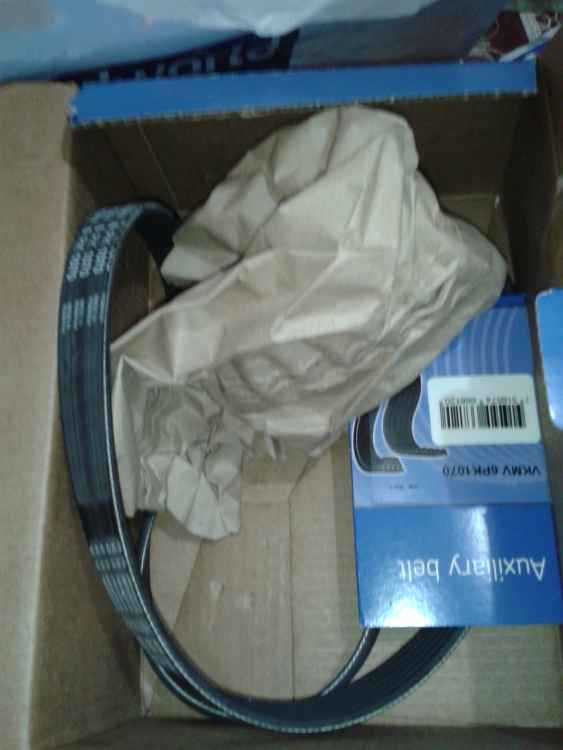

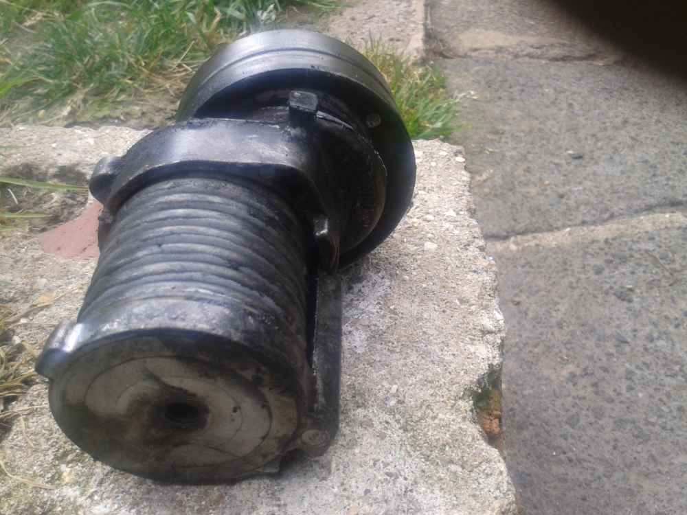

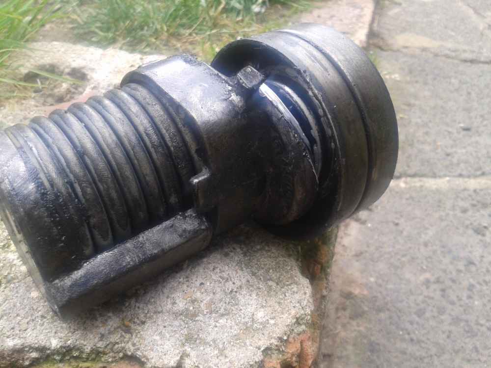

Well yesterday i was driving back home from work and my pas was making a loud noise and all of a sudden my steering went all hard. Pulled up and pop the bonnet open to find my tensioner exploded :lol:
After an hour of trying to remove it . Here it is. One fucked tensioner.

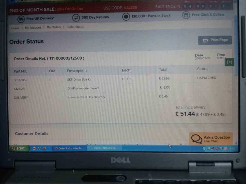

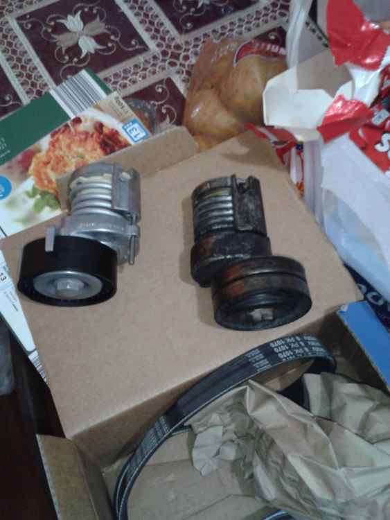

Ordered a new drive belt kit SKF drive belt and tensioner from eurocarparts using a Dscount code (SALE25) FROM £63.99 TO £47.99. Should be here by tomorrow as i opt for next day delivery and fitted by friday (my day off). Also when removing the heat shield from the manifold i discovered a nasty crack hence why my car is kinda loud :lol:
Gives me an excuse to fit a stainless steel one soon . Updates on friday when all fixed hopefully.
Nimal
started at 1 in the rain trying to put the tensioner in, Guess what it didnt go in and hitting the chassis leg. Had to remove the power steering pump and it went in.Next problem i had was when fitting the pas belt, it wouldn't fit like it was too small. Alot of head scratching and looking around i realize i still had the aircon  compressor pump and pully attached and was running the a/c belt. Soo I removed the whole a/c pump and pully and attached the new belt. all done in 3 an a half hours :lol: .
Edited by madnemo
old and new one

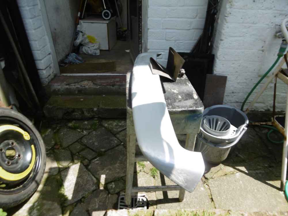

Soo i sprayed my rear spoiler afews ago and it came out propper.
sanded it down with 400 grit sand paper
P1000098.jpghow to do a screen shot
plastic primer applied
P1000093.jpghow to do a screen shot
sanded down plastic primer then used a tac cloth to wipe off any dust contamination .
P1000102.jpghow to do a screen shot
applied 4 coats of lovely canyon red paint
P1000110.jpghow to do a screen shot
Then sprayed 4 coats of 2k clear coat
P1000106.jpghow to do a screen shot
^^^^^ nice and shinny
P1000111.jpghow to do a screen shot
^^^^ clear coat dried.
Gona leave it a month to proper harden then wet sand from 500 grit then 1000 grit  and 1500 and finally 2000 grit then give it a compound polish.

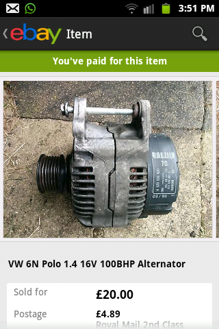

My alternator is playing up (not charging the battery) soo ordered a second hand one from good ol ebay for a bargain score
Nimal

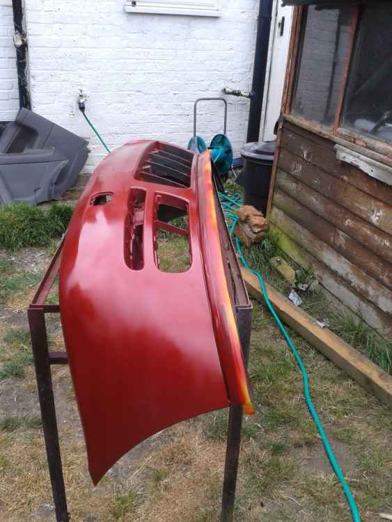

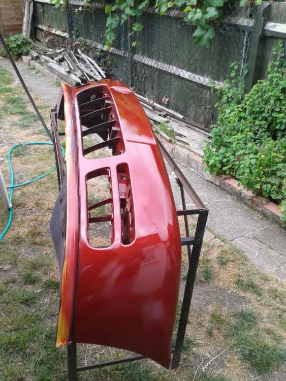

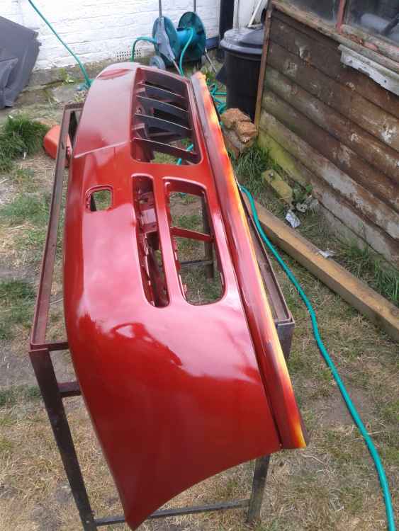

Pics of the Front 16v bumper painted
^^^^^^^ Canyon red base coat
2016-08-13 13.10.07.jpg2016-08-13 13.10.07.jpg2016-08-13 13.10.07.jpg2016-08-13 13.10.07.jpg

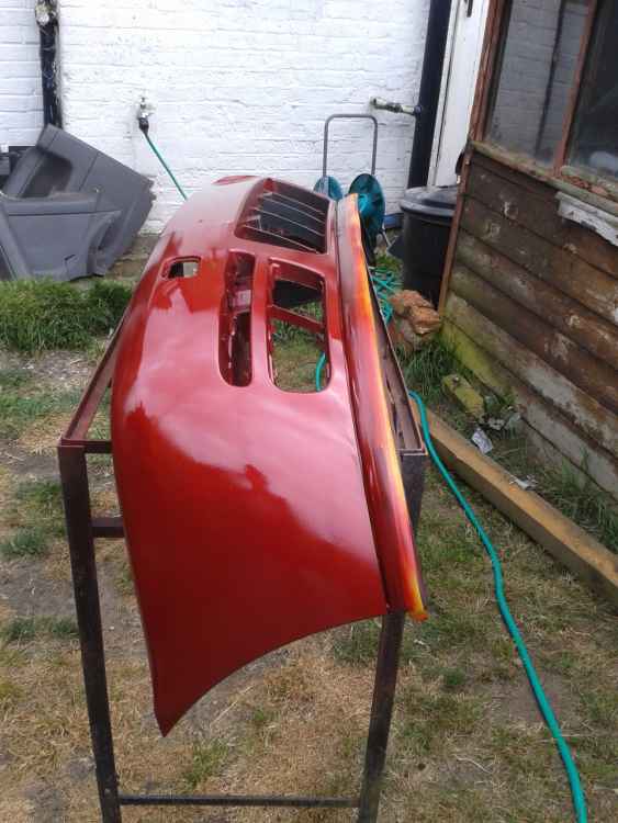

gave it 3 coats of 2K clear coat. I'll give it 2/3weeks before i wet/color sand it to get it nice an smooth no orange peal and give it a compound polish after.
Nimal
Edited by madnemo
I'll take some proper photos of the paint work on the bumpers when installed as my phone camera doesn't really show the shine of the paint job properly

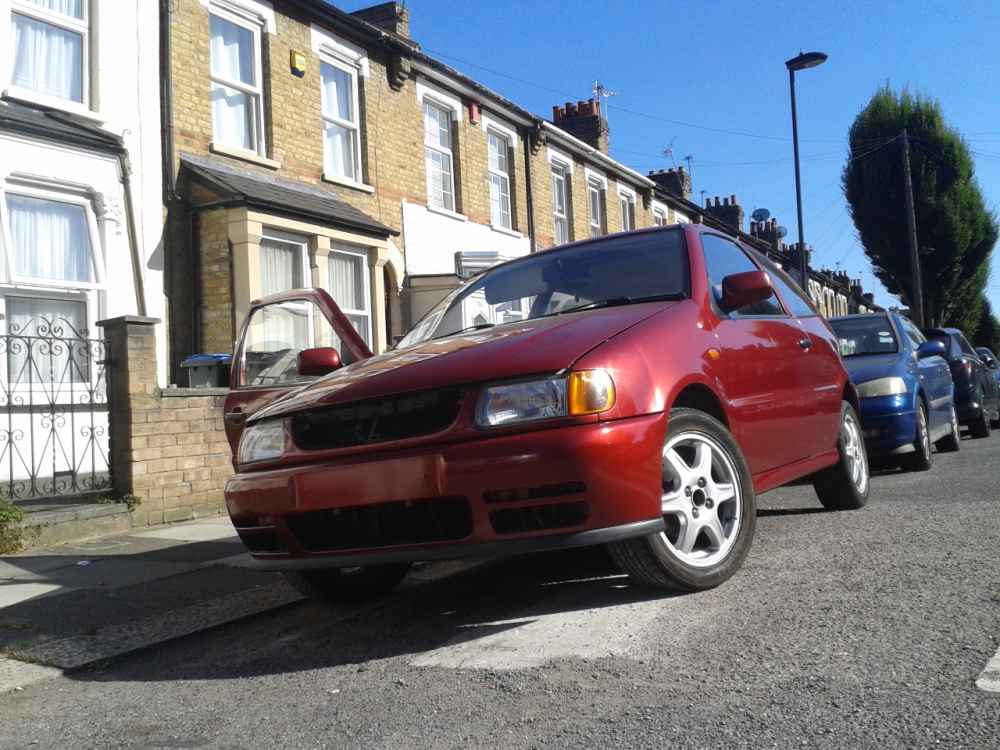

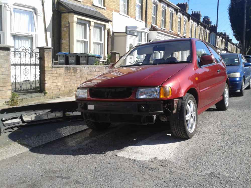

Finished work early today. Soo i decided to fit my freshly painted 16v front bumper today.
Really need to be lowered as it looks like a 4x4. The paint is hard now soo next week i can finally start to color sand (getting rid of the orange peal) and use g3 compound polish to get the bumper proper smooth. Next is some new pressed plates, clear indicators and installing the fog lights ive bought awhile back. Thanks for reading.
