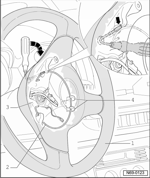

Have you had the steering wheel off ? if not it's probably the horn wires shorting together and if that's the problem you'll need to remove the airbag to check the wires
Insert a bent screwdriver into the holes in the rear of the steering wheel and turn as shown in this pic.
post-36925-0-74954000-1444327637_thumb.p
