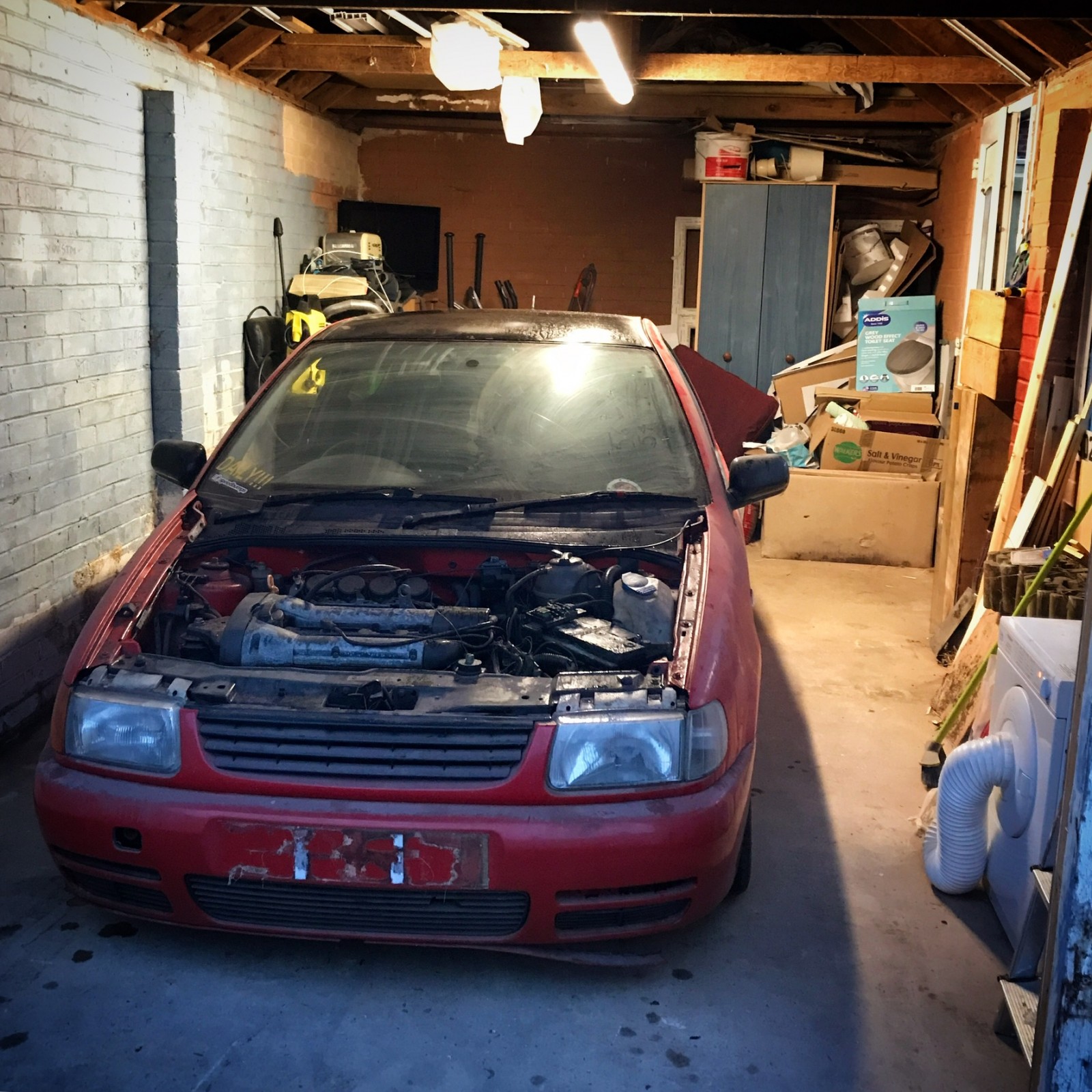

Sold this back in May 2018, but just bought it back!!
car had been sat since I sold it so had collected quite a bit of damp and usual things that happens when a car sits. Got it back home and stripped the interior out and hung it up to dry, now to start on a few other issues, blowing exhaust and a really stiff clutch pedal!
Wow always good to get a car back will have to upload more pics and what plans have you got for it now
I really regret getting rid of my first polo so I had to get another but this one is going to take some work as it was sat in a barn for around 8 years
Yeah I was quite lucky to have it offered back to me to be honest, but glad I seized the opportunity, she's not in need of as much work as yours by the look of it.
since getting it back I've;
  • replaced the clutch and release bearing because it had a really stiff pedal, old release bearing had seized so replaced both.
  • investigated some issues relating to changing gear as it felt like a stick in the mud, found that when the dog leg mount failed spectacularly it snapped a bracket and cable loacting housing so they are being replaced which I'm part way through.
  • replaced the selector shaft seal while I had the box out.
  • had a hole in the cat welded up.
  • cleaned up most of the shmoo from the front of the engine and box (20+ years worth).
  • stripped the entire interior minus the dashboard (26 fasteners in total 🤣).
  • Identified areas of rust that require attention before they need heavier duty work.
