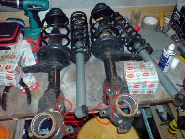

I'm after a pair of carrier adapters for my Mk2 G40, I'm running VWII Callipers on the front and need the bracket that bolts to the hub, which holds the calliper carrier.

I've got the carriers I just need the adapter plates for bolting the carrier to the hub.... does that make sense?
Never seen them. My carriers bolt direct to the strut and the caliper bolts to the carrier. Same on every mk2/2f Polo I've ever seen
They bolt on to these holes on the hub...
post-2904-0-49129700-1445027479_thumb.jp
Where did you find that picture?? :)
Google. I never realised it was one of yours!
I'm gonna take a pic when I can to let you guys know what I'm going on about, Mark what size discs were you using in that picture?

Just to clear the confusion on this, I was running the TSR 270mm upgrade, which had adapter blocks to allow the calliper to reach the edge of the big discs, this was what I was after. I didn't know the details at the time.
