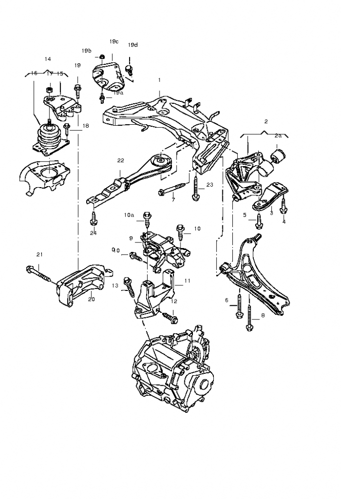

Here's some info from the dealer manual 9N Front Wishbone RR.doc There is no mention of extra work required for the Auto box, If you look at this pic
post-36925-0-57013900-1445893666_thumb.p
I'd support the box on a trolley jack then remove item # 9 (under the battery tray) this should give you enough movement to jack the box up to clear the oil pan and remove the bolt :)
Item 9, thats the one :thumbsup:
Nige, Polo3, this is great... Thank you both very much! I'll give it a try & report back. Kindest regards.
All done, Thank you both very much... I removed the gearbox top mount that sits underneath the battery box, I was then able to lift the engine & box to give the clearance, sorted it all out this evening & put it back together again. Many thanks Nige8021, & Polo3. All the best Pete..
