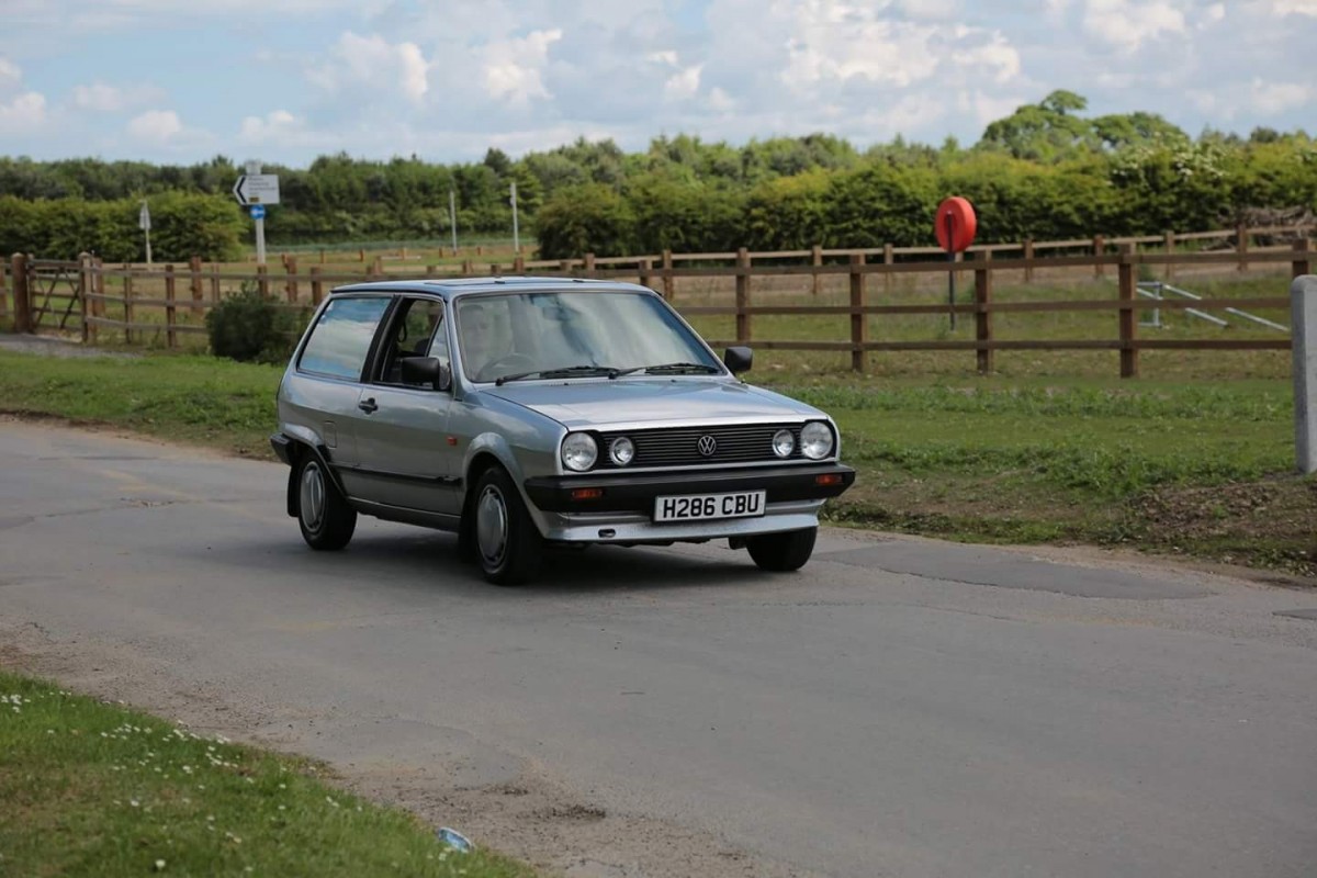

Comments: It has 80000 miles on the clock and 3 previous owners (not bad for a 29 year old car). The engine is pretty good on the whole (apart from 2 breakdowns on the way down from Bristol to Falmouth but this turned out to be a loose ignition chord so all is well now) however the body needs some work, love and attention to get her to what I want it to be. Anyway here are some pictures of her:

First I gave her a very good clean to see what I was working with
