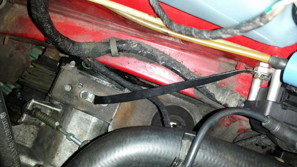

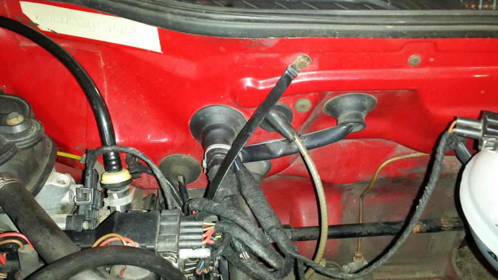

Linked this up for now. Looks the part just like the earth from the coil pack. I know the opinion is to replace with the heavy duty cable but at the moment it is not the time to be spending on the car and it's not on my list to Father Christmas so will sort out in the new year. I've made sure there is enough slack to allow for the movement of the engine and cleaned the bulk head behind the bolt. This bolt, by the way, was holding the frame for the ECU.
post-15736-0-45265300-1449325880_thumb.j
post-15736-0-91510200-1449325895_thumb.j
mind that gearbox one doesnt snap off when the engine moves , and yea needs to be fatter imho
The gearbox engine mount one is the original that came with the car. Shouldn't be much movement there.
Don't know if this is of use but on early mk2 golf gti's VW used to use the engine mount bracket as the earthing point and later models had the earth point to one of the top two transmission mounting points instead (the bell housing to engine block) as the earlier point is crap due to the extra joints to the gearbox as every joint in an earth creates resistance and thats with good clean connections the same as small diameter earth cable and poor quality cables.
Black at £2.50 per metre is a good price plus p & p. Not bad. A great service. May see if it's still available in the new year.
