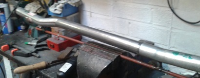

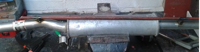

I have asked a few times about this as my mid section on the exhaust scraps on the devil speed humps in my area..
So I had a go at modifying the center mid box exhaust. Here are the results ..

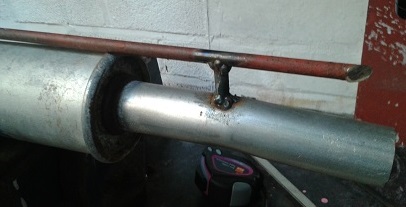

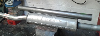

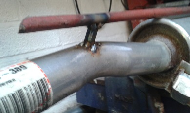

Made a jig so when middle section is cut out all will line up so then new section of exhaust pipe can be cut and tacked in , then remove jig and finish welding then grind down pigeon shit , coat of zink JOB DONE :D
If people are thinking why the hell didn't I just not cut box out and weld it up is because both ends of the pipe have kicks and different angles in it so the jig held it all in place after the center section was cut out . So this should fit same as original exhaust..

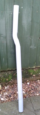

Thanks mattg40 .. Did not know you could buy it , did not cost much new center exhaust was £18 ( you can use old one if needed ) and new mild steel straight exhaust cost £12 as for the jig cost nothing as had metal bar in workshop ..time one hour had nothing else to loose ..
The reason why home made weld on jig worked for me is that I did not want the two pipes moving from correct position after I cut out center box. This jig I made kept the same alignment from start too finish..

It is possible to just use a piece of straight tube cut to length with a hangar welded on. Did this on my mk2 polo and it cost under £5
