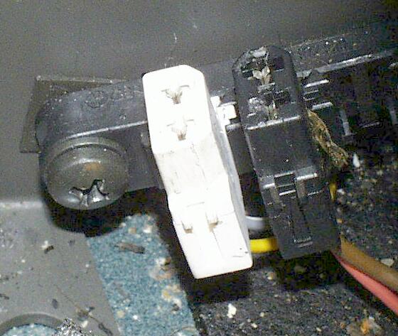

These:
post-7203-0-36623200-1450035315_thumb.jp
I was missing one of the plugs so I wired in the OBD plug as my main diagnostic port. I guess if you want the originals then you'll have to get them from someone who is breaking a car.
