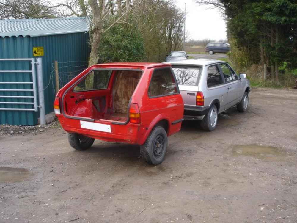

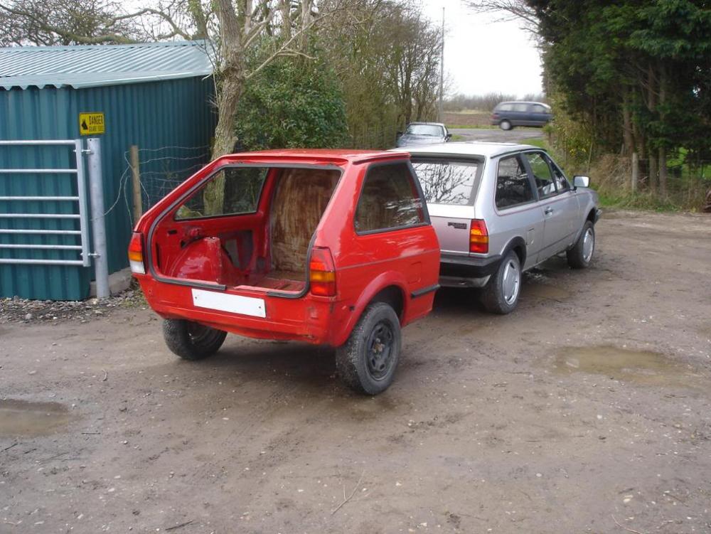

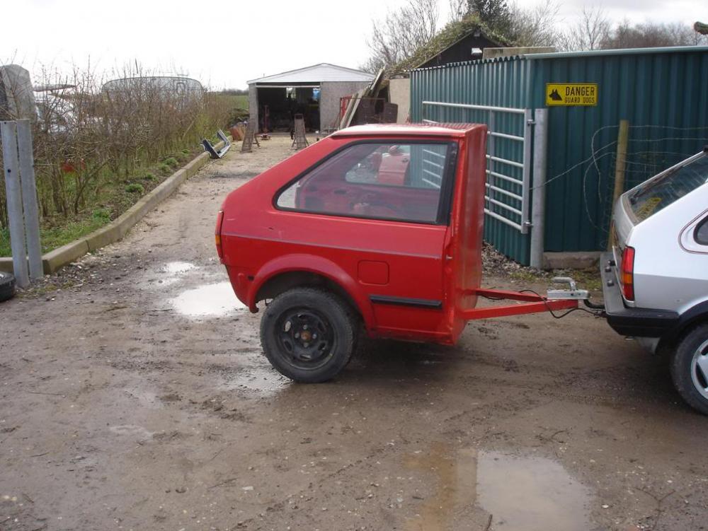

  • Roughly speaking, this is how mine was done. It's as rough as arseholes, but it's strong. You've just got to be in the mindset that you're towing the axle and the rest of it just needs to stay stable.
  • The camera lies, everything I took a picture of with that camera looks awesome. You wouldn't guess from the pictures that the tow car was as rotten as an old pear :(

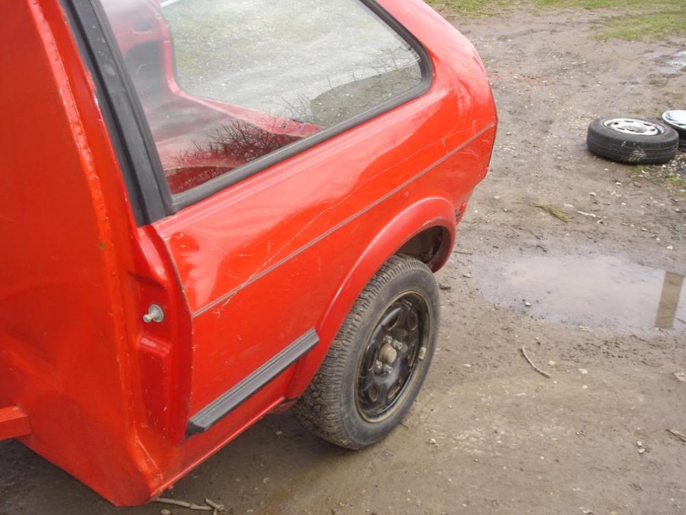

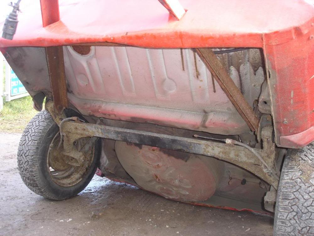

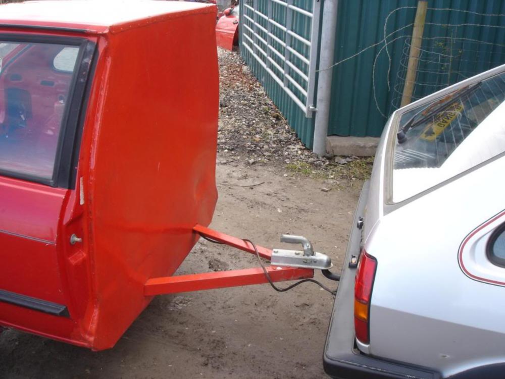

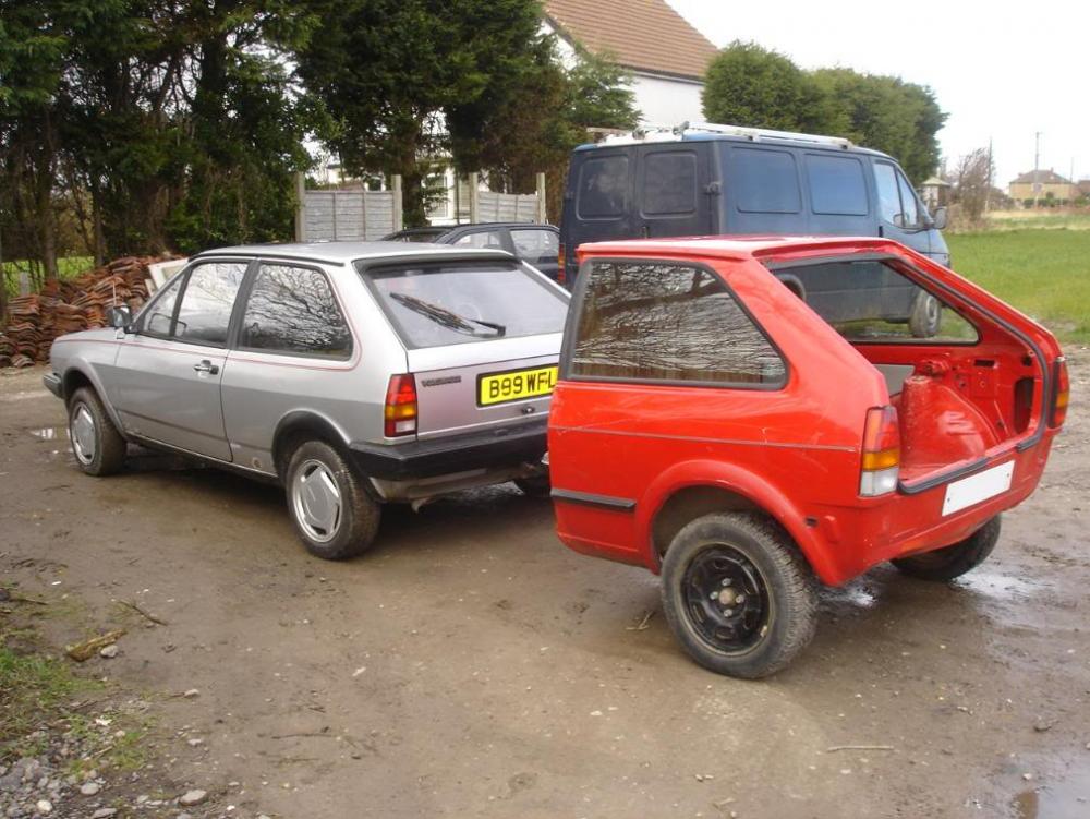

Roughly speaking, this is how mine was done. It's as rough as arseholes, but it's strong. You've just got to be in the mindset that you're towing the axle and the rest of it just needs to stay stable. Don't just blast a bit of angle iron onto the floor and call it a straight drawbar, it might last, it might not.
I've not really changed much on it, except I reinstated the handbrake cable and use braked hitch with it - works well. It's a it's a bit rustier now and it's got a tailgate on.

Looks like a good job.

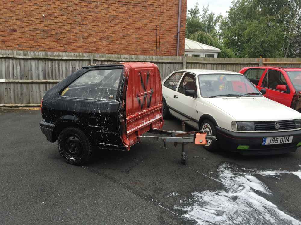

quick update in this she has come back to me and now the rear lights are wired to the 7 pin plug and working well on the back of the camper,
Next step is to kit the inside out and paint it or wrap it :drinks:
