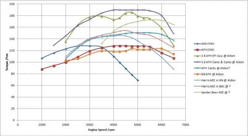

I found these on an old thread: (hope I don't break any rules posting this here)
post-920986-0-37182800-1450699538_thumb.

Thanks for the ecu maps. They kinda relate what people are saying and the nature of the engines.
