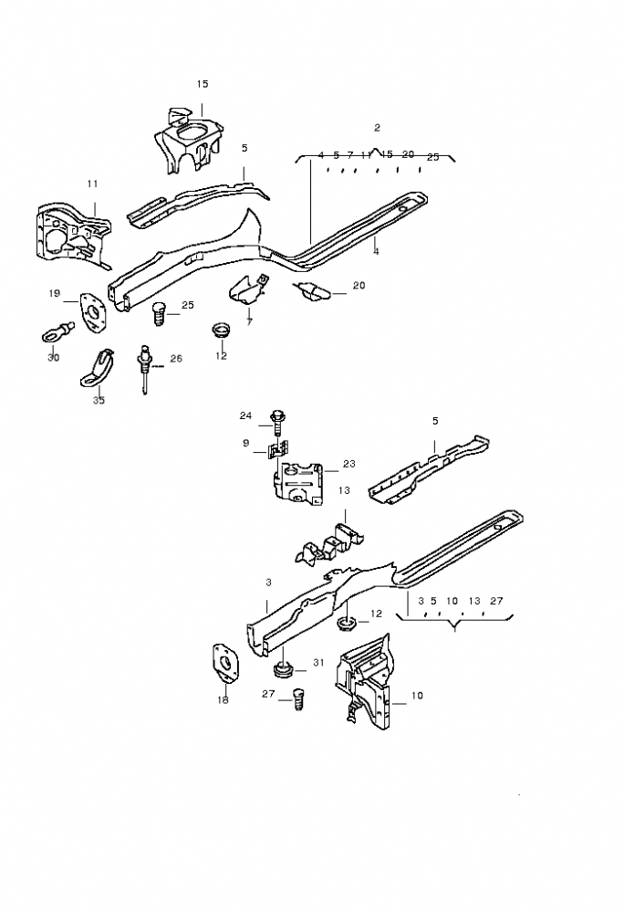

I seem to recall in someones build thread, there was a write up about this problem, they cut an access hole in the chassis leg, to get at the captive nut, then welded a new top hat section over a new nut and welded the access opening back.
post-36925-0-35572100-1450783662_thumb.p
(7) 6N0803127B retainer bracket / subframe left /
(7) 6N0803128B retainer bracket / subframe right /
(20) 6N0804055C retainer bracket / subframe left /
(20) 6N0804056C retainer bracket / subframe right /
#7 25 uros
#20 12 uros
my #20's came out fine, it's the #7's that just span. They didn't even give any real resistance, i was sat there for a couple of minutes 'undoing' them before it dawned on me what was going on.
I like the idea of cutting a little 'window' to access the captive nut, if I was to cut a nice trapezoidal piece out of the side of the mount. I'd be able to get at the side of the nut, undo it and weld at least 180o around a fresh nut and then just close up the 'window'. Less grinding, prep, painting and no need to lift the engine.
