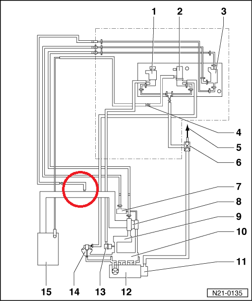

Hope someone can help, changed the cam belt yesterday and on rebuilding it I found avacum pipe off.... The 3 silver pipes that run to the drivers side it's the top one that just looks lost.... Please help as it's holding back..... And worse still it's the wife's

That's great thanks.... Says it goes to the pipe between the maf and charge cooler... But can't find where
I can't see any pictures of where the connections go to but here's another fitting locations 6N2 TDi Fitting locations overview.doc
I assume it's the connection in the red circle ?
post-36925-0-40366700-1450811057_thumb.p
if so the thick pipe it's going to is the pipe from the air filter to the turbo charger inlet
Yes thank you so much, found it earlier.... Hidden below a sensor on the turbo intake pipe.
