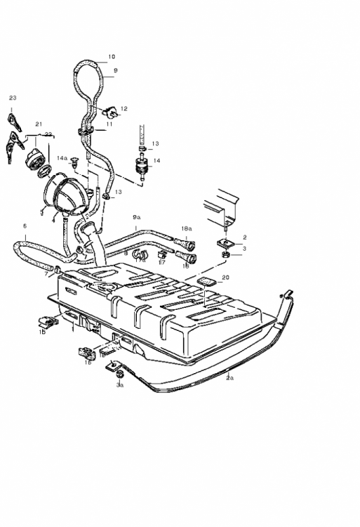

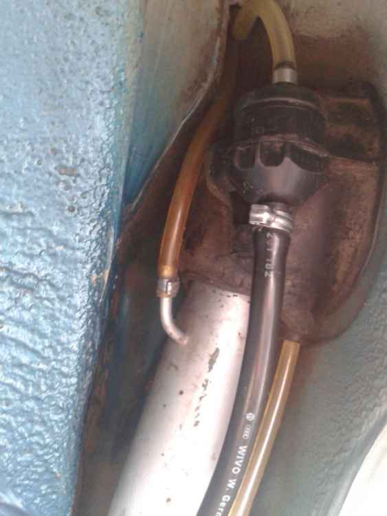

Well guys curiousity got the better of me!! I pulled the rear door card off to look at the pipe of doom. It is rusted big time. It crumbled in my hand and left a big whole on the inner arch. I hope my welder dont run for the hills !! The plan is to cot down the pipe of doom ( the first 2 inches of pipe that comes from under the car seems solid !! ) and then run a new piece of fuel hose through the inner wing. When the welder lets in new metal (as long as he can !! ) I will drill out a whole and put in a rubber grommet with the fuel line inside it. What do you reckon ??? Oh yeah removed the seatbelt and broke that so anyone got a drivers side seatbelt ?? I hate old cars at the moment.
Right guys did some work on the breadie today I got the tank out (cheated and cut the neck off as it was rotten anyway)and the hole behind seems fairly localised so hopefully all will be solid on Saturday (I will get some pictures on). Problem I have is in the rubber boot/mount that goes in the filler flap that hold the neck. The valve type thing that sits oin a cup with a pipe coming off it broke!! What is this bit called and any ideas where I can get a new one ??
