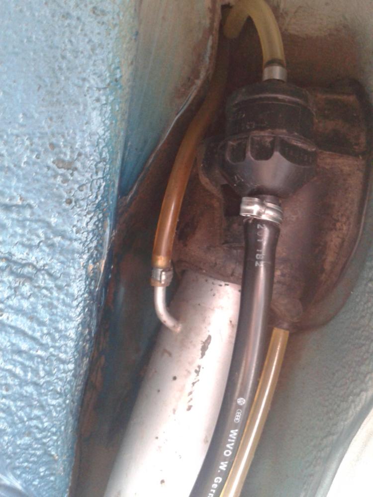

Does this help ?
post-4280-0-92168800-1452707161_thumb.jp
Edited by 1vw2many
Hi yeah it is this item but in mine it sits in the rubber boot. What is it and am I knackered getting one.
sure someone on the classifieds will sell you one...my mk2 doesnt have one , i assume its to an anti drain valve incase you roll the car?
Searched for it but no luck anyone got this locking around. Wish I knew what it's proper name is.

Still struggling to find the correct name for the valve that sits inside the rubber filler neck boot as pictured above !!!

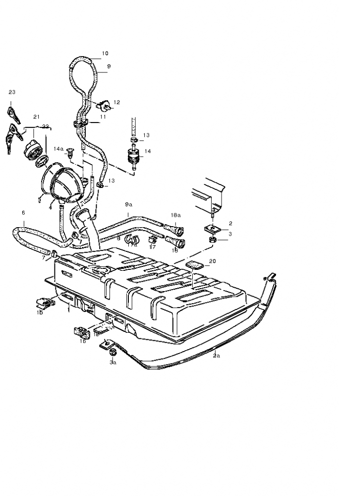

post-36925-0-03260200-1452810634_thumb.p
14) 867201753 gravity valve
Thanks nige just got to find one !!
