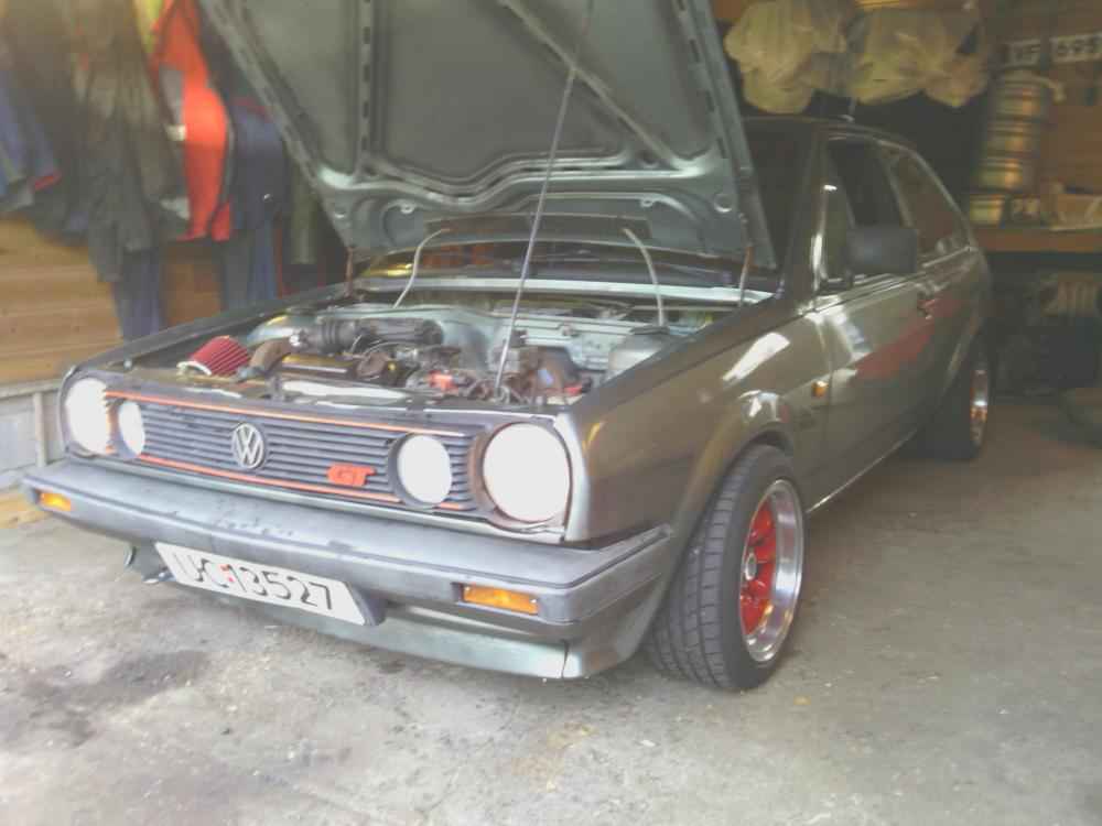

This is a project thread about my 1986 Polo coupe GT. Bought it a couple years ago and used it as a daily driver for about a year.
The engine gave out and now I'm in progress of restoring it. I will probably have a lot of questions during this build, and I hope maybe some of you can help me :)
Some pictures from when it was a daily
