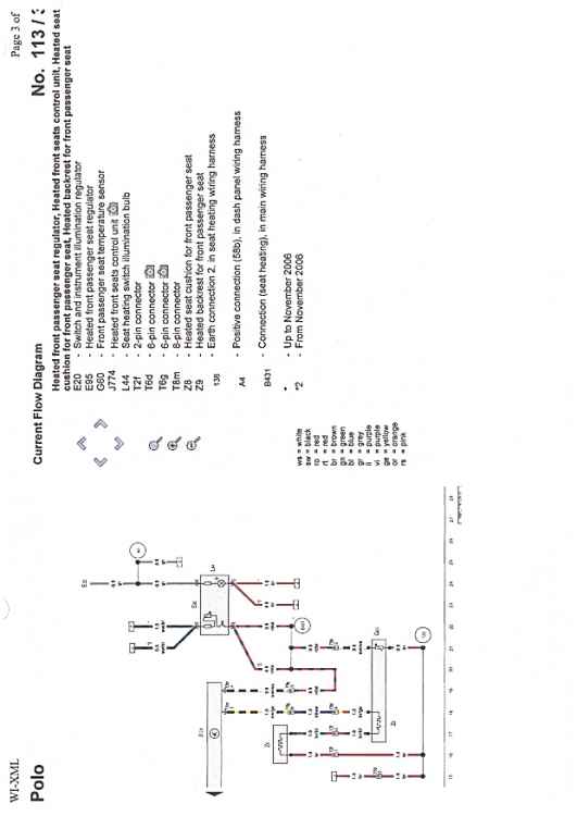

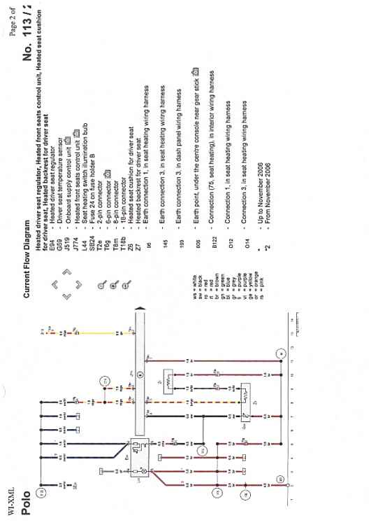

Installed some heated leather seats in my 2005 Polo TDi ages ago, bought the relevant switches and what I thought was the correct plug and play wiring loom for them from Kufatec. However, I have since found out that VW decided to change the wiring/relay set up from 2006 onwards. The seats are from a late 2007 car, the Kufatec loom only covers up to 2006 cars. Does anyone have access to the correct wiring diagram for a 2008 model year Polo with heated seats? Perfectly capable of making my own loom if I have the correct diagram....

You sir are a legend, thank you :-)
Where the hell did you get those from?
Unfortunately the downloads from photobucket won't open on this tablet or my phone. Anyone got a magnifying glass? Might try firing up the laptop....
They are from ElsaWin it's a copy of the dealers manual.
post-36925-0-18207400-1452122749_thumb.j
post-36925-0-59082100-1452122768_thumb.j
If you want I can email them to you ?
PM sent, thank you :-)
Finally, I have a warm backside at last! :)
With the correct diagram to follow, I managed to modify the Kufatec loom to work with the later spec single relay set up I have on my seats. A big thank you to Nige for sorting out the diagrams so I can finally put this job to bed :)
