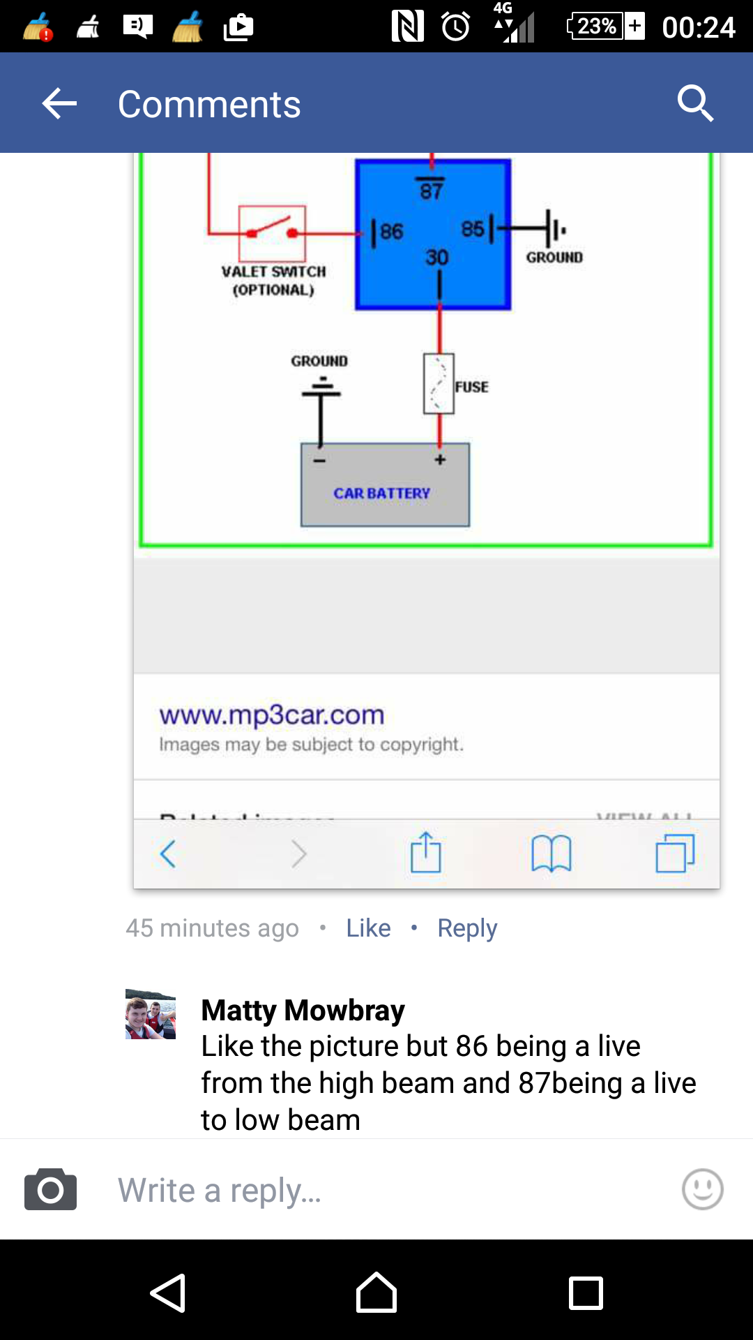

post-916839-145247177983_thumb.png would this work using 86 live high and 87 live low?
Like I said in my PM, I'm sure all Polo's turn off the dipped beam when you turn on the high beam.

I added a diode between the white and yellow wire on the stalk switch.
This allows the main beam output to power the dipped beams.
