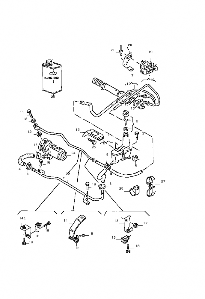

Hi all
I saw somewhere on here that somebody has access to part numbers, er, can't seem to find the thread again tho. I'm looking for a power steering pipe for my 2000 Polo estate 1.9 tdi. Any help would be very much appreciated.
Ben

First Welcome to the forum.
post-36925-0-01750500-1452718772_thumb.p
Partlist:
oil container and connection parts, hoses
1 6K0422371A
oil container / only for:
6K0 422 889 E /
2 3A0422376
locking cover
3 N 0147222
allen key head bolt
M6X60 /
4 6K0422887E
suction hose
/ ADC,ADD
(4) 6K0422887F
suction hose
/ AEH,AKL,APF, AUR
(4) 6K0422887B
suction hose
/ diesel eng.
(4) 6K0422887D
suction hose
/ AKK,ANW,APE, ALM,AUD,AUA
(4) 1H0422887D
suction hose / for vehicles with air condit.
5 6K0422889B
suction hose / F >> 6K-1-531 720*
(5) 6K0422889D
/ AEH,AKL,APF, ADD,ADC,AUR; diesel eng.
(5) 6K0422889E
suction hose / F 6K-1-531 720>>* / only for:
6K0 422 371 A /
6 N 90655501
spring-type clip
23X12 /
7 6K1422891B
return hose
lhd / automatic: AEH,AKL
(7) 6K1422891B
return hose / F >> 6K-1-531 720*
lhd /
(7) 6K1422891K
return hose / F 6K-1-531 720>>*
lhd /
(7) 6K2422891B
return hose
rhd / automatic: AEH,AKL
(7) 6K2422891B
rhd /
(7) 6K2422891K
rhd /
8 N 90655301
spring-type clip
17X12 /
9 6K1422893A
flexible hose
lhd / AKK,ANW,APE, ALM,AUD,AUA
(9) 6K1422893E
flexible hose
lhd / AGP,AQM
(9) 6K1422893C
flexible hose
lhd / ADD,ADC
(9) 6K1422893BH
flexible hose / for vehicles with air condit.
(9) 6K1422893AL
lhd / AGR,ALH,ASV
(9) 6K1422893AB
flexible hose / for vehicles with air condit. / F >> 6K-Y-504 805*
lhd / AGP,AQM
(9) 6K1422893AM
flexible hose / for vehicles with air condit. / F 6K-Y-504 806>>*
lhd / AGP,AQM
(9) 6K1422893AF
flexible hose
lhd / AGR,ALH,ASV
(9) 6K1422893AH
flexible hose
lhd / AEH,AKL,APF, AUR
(9) 6K2422893A
flexible hose
rhd / AKK,ANW,APE, ALM,AUD,AUA
(9) 6K2422893E
flexible hose
rhd / AGP,AQM
(9) 6K2422893BD
(9) 6K2422893AL
rhd / AGR,ALH,ASV
(9) 6K2422893AB
rhd / AGP,AQM
(9) 6K2422893AM
rhd / AGP,AQM
(9) 6K2422893AF
flexible hose
rhd / AGR,ALH,ASV
(9) 6K2422893AH
flexible hose
rhd / AEH,AKL,APF, AUR
10 1H0422999
round seal
7,65X1,63 /
11 1J0422269B
banto bolt / F 6K-Y-517 458>>*
M16X1,5 / AEH,AKL,APF
(11) 1J0422269C
banto bolt / F >> 6K-Y-517 457*
12 N 0138481
seal
A16X22 /
16 N 0206201
pipe clip
D1-13X15 / AKK,ALM,ANW, APE,AUD,AUA
17 N 90074401
hexagon nut, self-locking
M8 / AEH,AKL,APF, AUR; diesel eng.
(17) N 0102336
hexagonal head bolt / for vehicles with air condit.
M8X28 / diesel eng.
18 N 01021527
hexagonal head bolt
M6X15 /
19 1H0422941
retainer
20 1H0422173
retainer
21 N 90437401
pop-rivet
A4,8X10 /
22 6K0422896C
cooling pipe
(22) 6K0422896D
cooling pipe
(22) 6K0422896E
cooling pipe
/ ADC,ADD
23 G 002000
oil for hydraulic system and power steering
1.0 ltr. /
24
vane type pump / see illustration:
145-81 /
26 1H0422931
bracket for hose
27 357422939A
retainer
(27) 701422921
