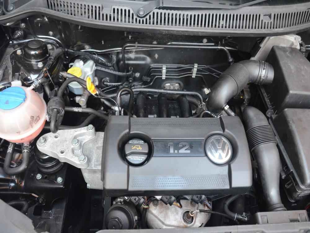

I tried but can not find the switch. I took a few pictures of the car, which will be posted soon
Any one would advise where is the oil pressue switches?
post-922614-0-38959500-1453154880_thumb.
There is no pressure switch on the oil filter flange.
post-922614-0-84861200-1453155171_thumb.
Is this the oil pressure switch on the cylinder head? but this is not located on the left-hand end of the cylinder head.
post-922614-0-50704200-1453155332_thumb.

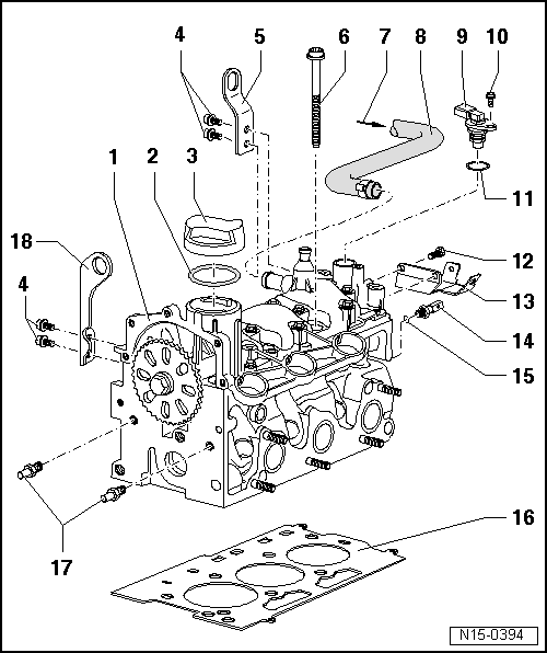

I'm guessing you have a BMD engine code ??
post-36925-0-91987800-1453155709_thumb.p
#14 0.3~0.7bar oil pressure switch F1 25Nm
Thank you very much. Will try to find it tomorrow.
Thank you Nige. Yes it is BMD engine. I found the switch as your information and already ordered one to replace.
