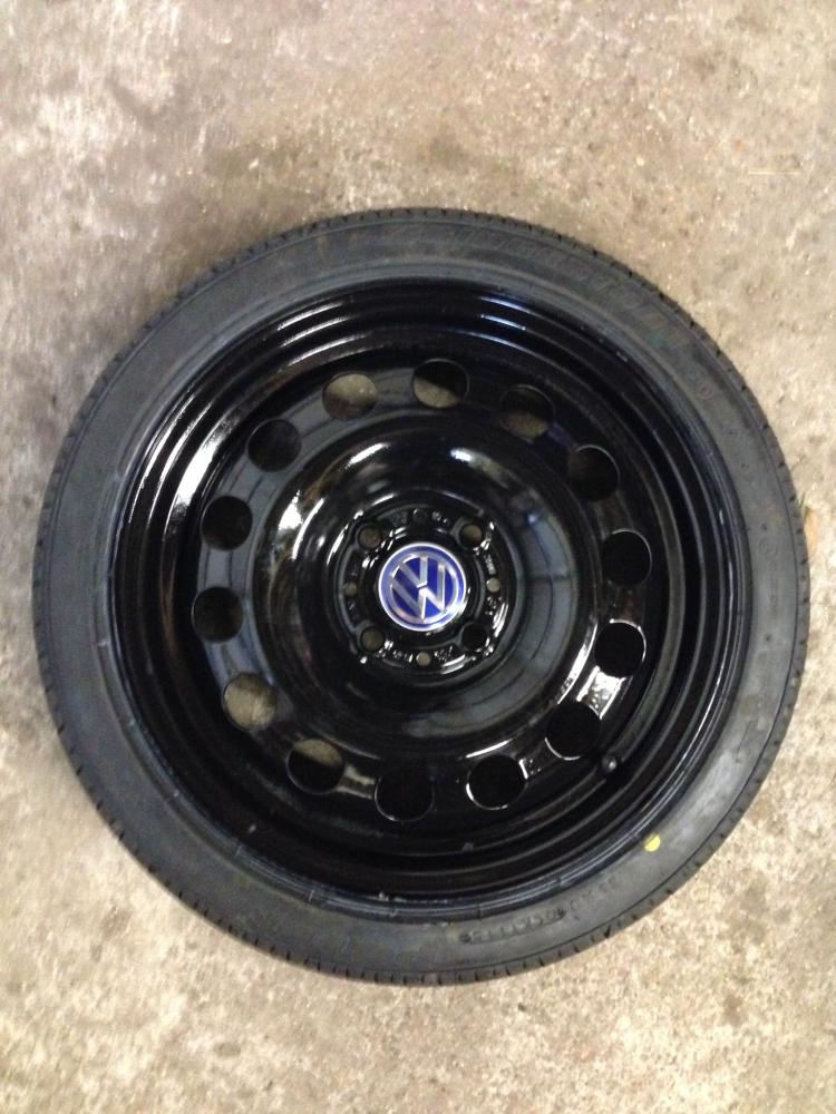

Today I put my 15" BMW mini wheel , without any spacers, on the car after having the centre bored out to 57.1 mm and painted black. They look very stock and it looks like I have plenty of clearance except if the suspension travels more than 50mm. If they were going to rub it would be on the spring cup mount. I have a Bridgestone 165 50 R15 tyre at present which makes the total height less than the stock 13" wheels so there may be an issue with the speedo reading. I am buying Spax adjustable shocks for the front and rear. I have some hub covers with a blue VW emblem but they don't fit because the hub inside diameter is too small and sticks out beyond the wheel rim.I was hoping for a simple solution because I want to cover the hub nut. I am putting on the larger brakes but don't know yet if the new discs are thicker. If they are thicker it will space the wheel out. The only other thing I was looking to do was put some good quality chrome wheel bolts on the car. I have lowering springs but I don't remember how much they lower the car. If I could have some comments on potential clearance issues, suspension travel, tyre size, Spax shocks, hub covers, wheel bolts and the larger ventilated brakes I would appreciate the experience that is out there.

Photo attached of Mini wheel on car.post-145558-0-04887800-1455226204_thumb.
Mini wheel with badge.post-145558-0-74650900-1455227285_thumb.
post-145558-0-23065200-1455227458_thumb.

Have you thought of using the 6n type centre caps? The ones that clip over all 4 bolts and have the VW logo on them. Its difficult to mount an alloy wheel centre cap on a steel wheel, they usually have ones that stick out and are cup shaped similar to the g60 steel wheel centre.
I havn't thought of that but thanks for the tip. I am struggling to think how I will achieve the look I want.

Anyway, you can still get MK2 VW centre caps new, and i think they'd look best (aka G60 centres).

I got my 'G60' caps from a seller on eBay, the going rate was about seven quid each though I got a set of four for under 25 quid. This would be a few years ago though.
MikeyMK, thanks for this. The look I'm going for is stock but make people guess what has been modified. That is why I have painted them black making them look a little like the original black 13" rims. Yeti mentioned tyre size of 165 50 15 which is exactly the Bridgestone Potenza I have gone for. This ends up being shorter than the 13" combination I have now have which I think is great because it lowers and gears the car down. My car is dented and not pristine but that's the way like it and I don't want to adverstise that the car is modified. I still need comments about adjustable Spax shocks and wheel bolts that are good quality chrome items that are not going to rust in five minutes.
