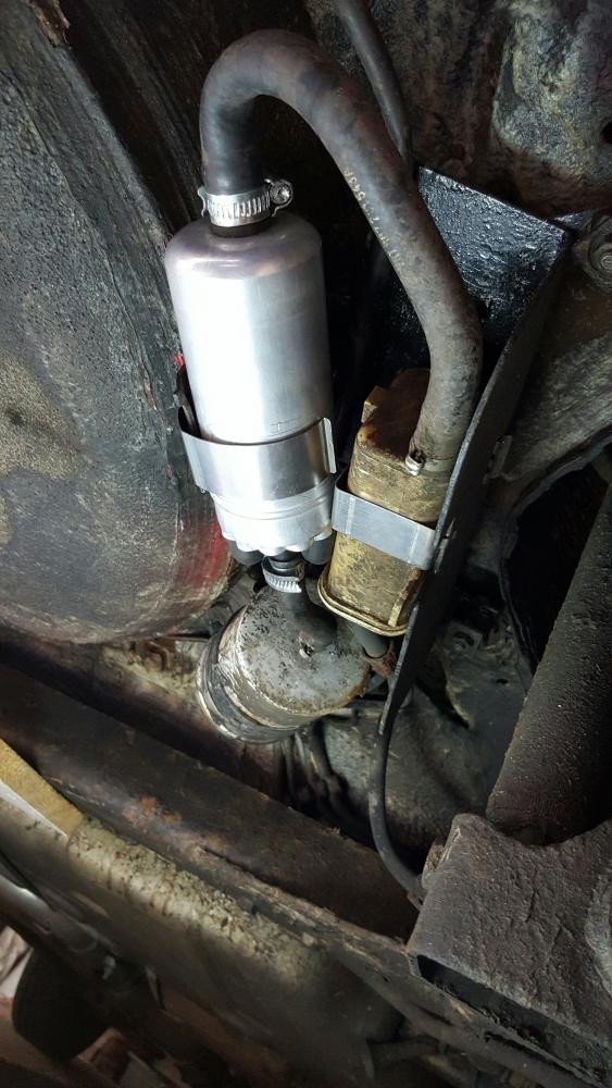

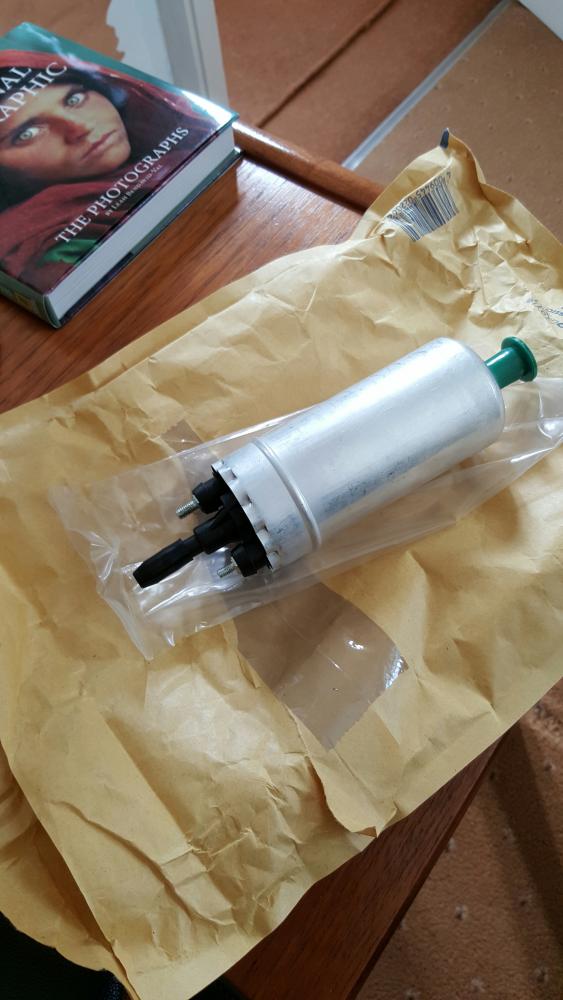

Delivered today and fitted. Gave it a test run and all seems well. It is noisy as it is a slightly larger diameter than the old pump and is touching the regulator. I'll put up with that for £17 ish compared to rediculous amounts for like for like swap. Time will tell.
This was the one I bought.

vwfan3
Hi
The noise could also be due to the fuel filter. When was the fuel filter last changed.
Share this post
Link to post
Share on other sites
c.w.pritchard
Yes. It's newish. Looks old but is covered in waxoly. The pump is slightly larger than the standard. I have a replacement that will go on but I just wanted to make sure it worked. Will need to reposition in the near future.

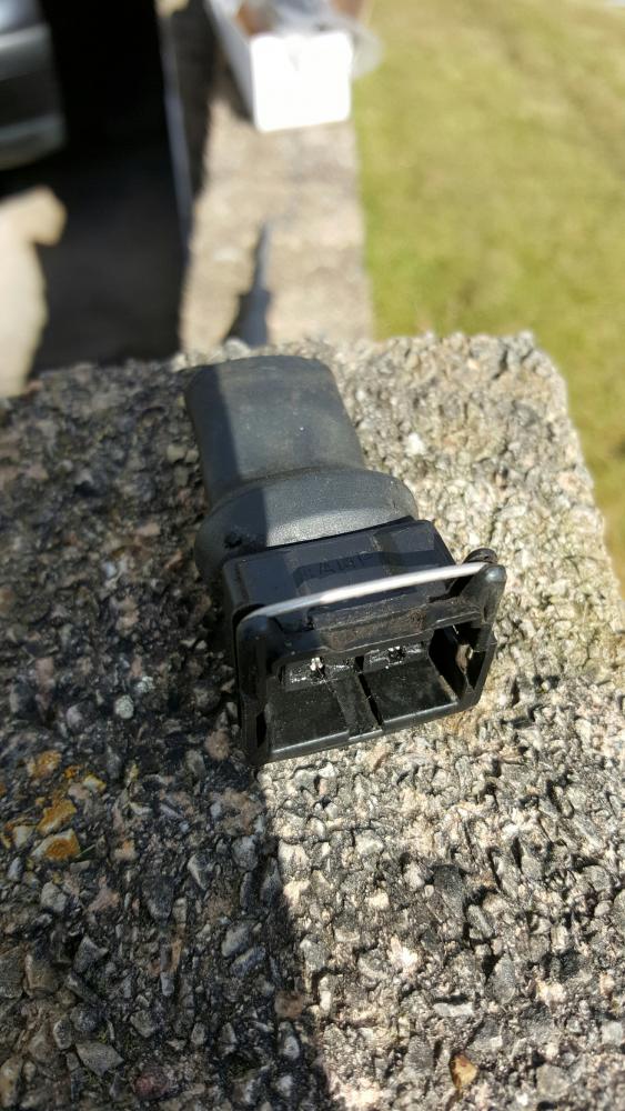

Anyone know where I can get one of these? Removed from the inline fuel pump when I replaced it with a universal fit. Tried vagcat but had no luck. Want to eventually put back an original.
post-15736-0-48299000-1458595299_thumb.j
Share this post
Link to post
nige8021
Search on ebay for "Junior power timer housing" around £2~3 with the sockets
