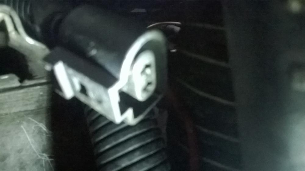

I couldn't feel anything but did find this?! Two broken wires.. Any ideas what they are for?
Also a connector that doesn't have anything attached to it.
The first picture is the connector that goes into the fuse box ontop of the battery, what do the two end fuses control?

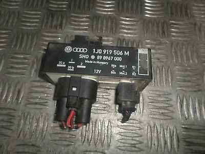

And last picture isn't mine but is that connector the one that goes into the control unit on the right?
