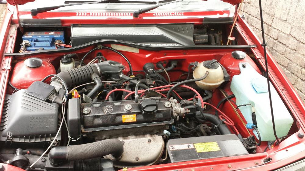

Here it is the original: (arrow)
My main concern with about the temperature. Is 105ºc enough?
Edited by dm222
Electrical tape is fine. But it doesn't look factory and if you ever come to remove it it leaves behind this horrible sticky mess. Fabric loom tape is much better.

The problem is, as you can see in my image below (arrow), the original tape is PVC tape and I want to keep it original, just asking if this tape (http://www.amazon.co.uk/gp/product/B00004WCCP?psc=1&redirect=true&ref_=oh_aui_detailpage_o00_s00?tag=b0f1c-21) the 105ºC is enough, it is 3M, it seems thicker and strong and better than cheap tape that can only handle around 90ºC.
Will it fall off or burn?
Edited by dm222
It's not in a high heat area, so as I said before there's nothing wrong with that 3M tape :)
