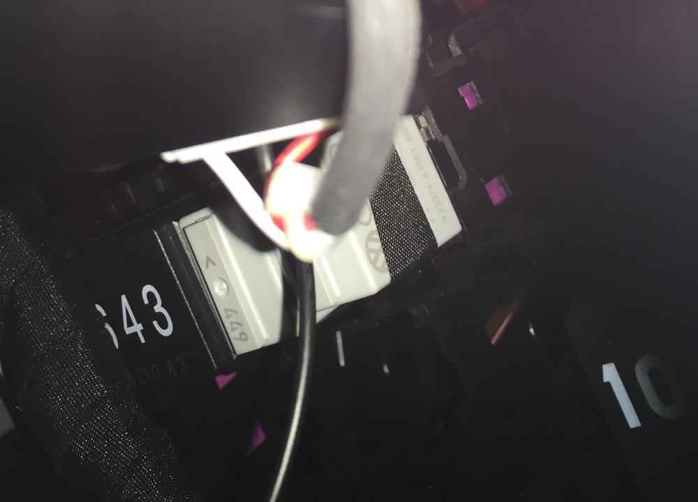

Hi, I'm new to the forum just recently bought a 1.6 TDI polo 6r. Didn't notice it on test drive or on drive home however i seem to get a fault when the heater fans are on full the lights dim quickly and one of the relays clicks this wouldn't really bother me however when I get out of the car whilst its doing this it sounds like the engine is cutting intermittently. anyone got any ideas on what could be causing this i don't think the relay is faulty because if i turn the heater off and back on to half(2) the problem disappears. It feels like the fuel pump relay (449)
Thanks for any help.

    Hi everyone, thanks for your help I think it was the alternator regulator. When the lights were clicking the voltage was going higher than normal and dropping across the battery. Thanks for all your h

Hi everyone, thanks for your help I think it was the alternator regulator. When the lights were clicking the voltage was going higher than normal and dropping across the battery. Thanks for all your help I've got a new regulator on the way I'll let you know if it solves the issue.
