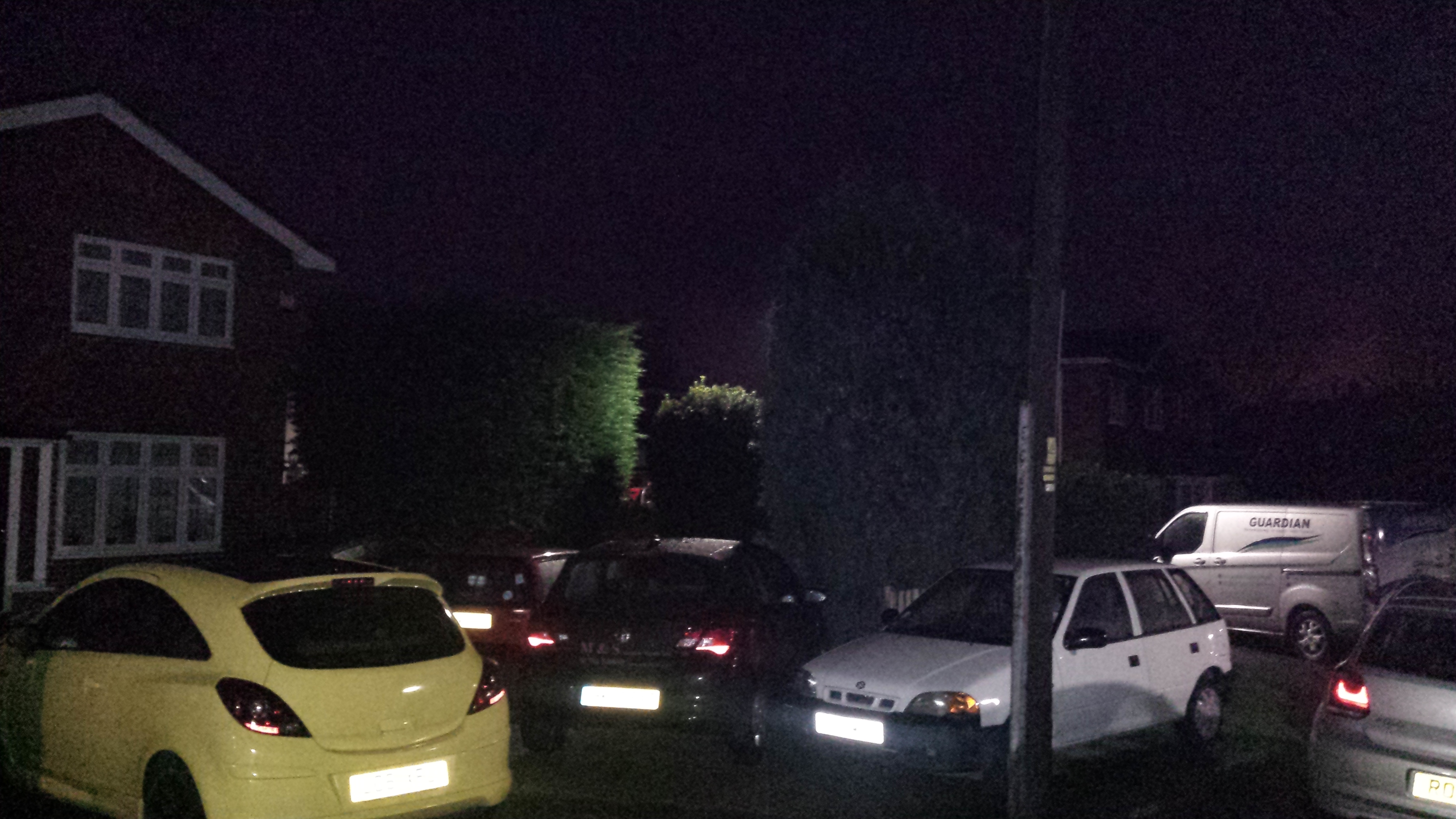

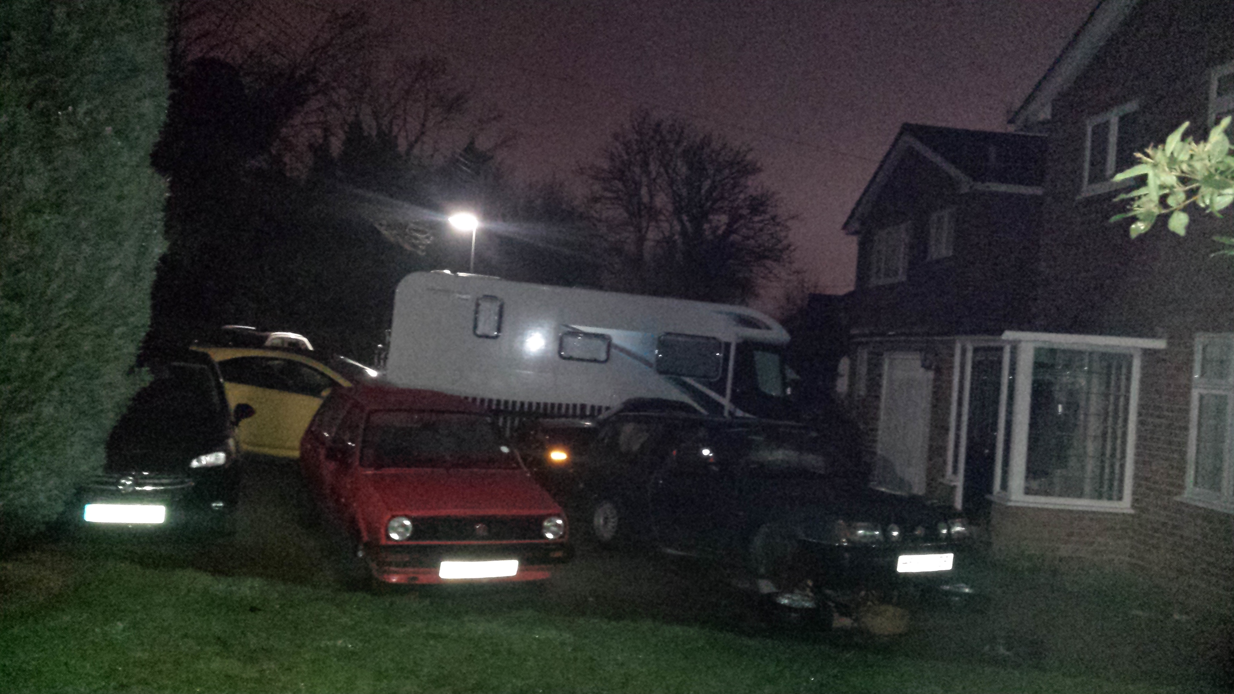

Not an update but I thought this was quite funny.
Everyone is home tonight and this is what the house is like with all the cars parked up
My 2 breadvans on the drive and the bluemotion on the street
Mx5 and the van on the street gfs dad's
Courtesy car (corsa) gfs mothers
Not so limited edition corsa gfs brothers
Suzuki swift: gfs grandads. He left it here until his insurance runs out on his other car
The silver vitara up the street is her brothers girlfriends too.
Neighbours must hate us lol a proper update coming soon but it's best to update all at once. Just swimming in wiring atm..
