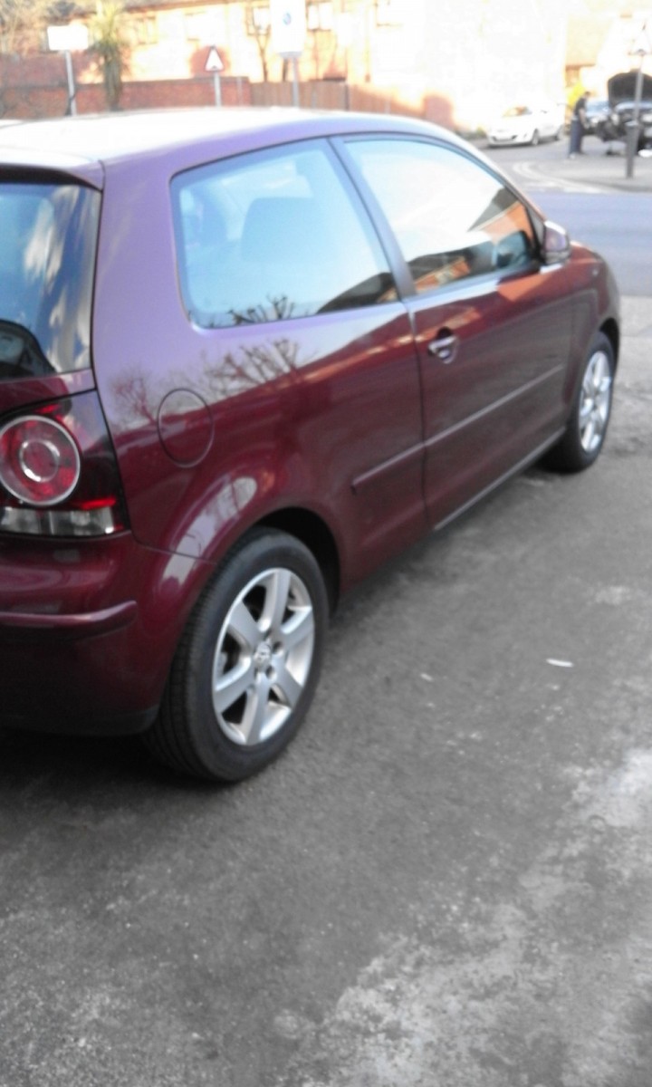

So last August I decided I wanted an upgrade, and liking my old Polo in every way except the power I decided to see if I could get a 9n3 GTI. Sadly, it was not to be, as the insurance on these motors is absolutely astronomical! But I did find the best alternative in the 9n3 TDI PD130; it just ticked all the boxes for me: it was fast and easily tuneable, was excellent on fuel being a diesel and was a Polo.
Quick search on eBay on the Friday night and I found this; a Winter Red Polo 9n3 TDI PD130 with 110k and a Full VW Service History including belt & pump change. Gave the chap a ring and Saturday afternoon I was off down to view it!
All went well, drove spot on, service book checked out, all the boxes were ticked, deposit paid. And by the Monday night, well, you guessed it, it was mine.
