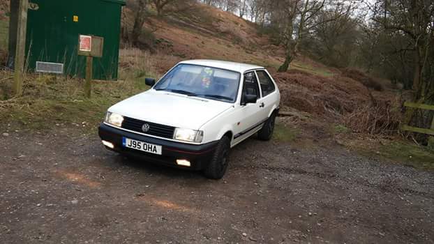

My barn find fox

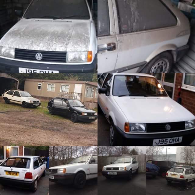

This is my 92 polo fox.
I bought this for £50 well £47.50 as I found £2.50 under drivers seat haha.
But this was sitting inside a old mans barn for 17 years and was looking in a right state.

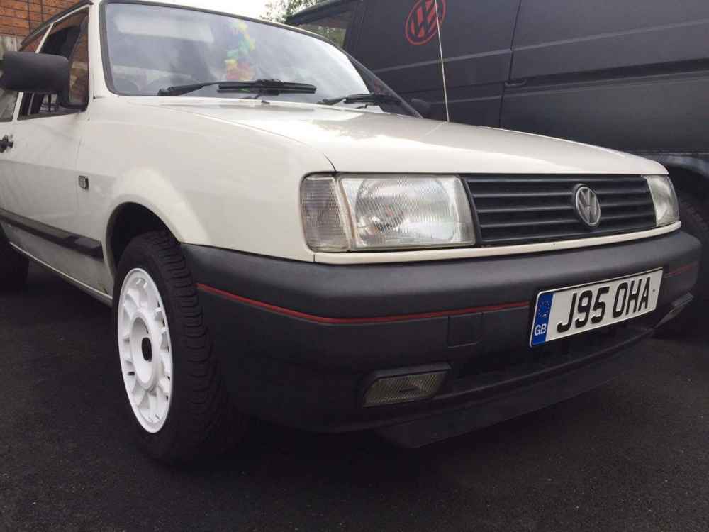

Original plans were to strip of down for parts for my black cl coupe and make a trailer buy it ended up being the complete opasite it is just to good to break up.
Took the whole weekend of cutting back paint and mopping but came up a treat £300 later she passed mot with no advisories and runs so dam well with only 54.000 on the clock.

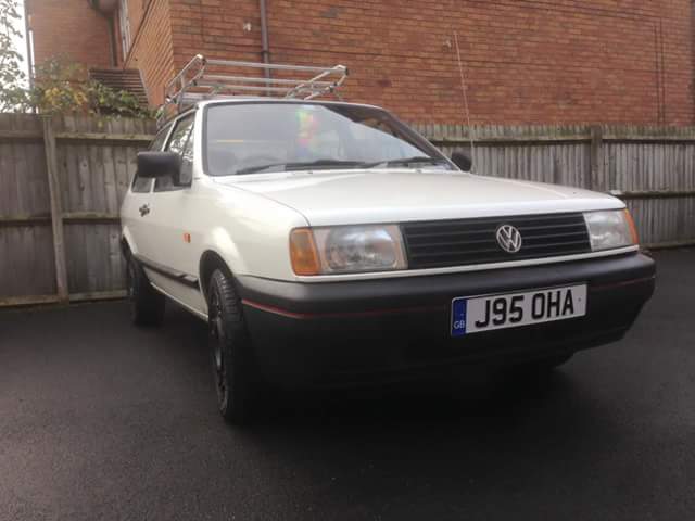

Parts needed were.
Exhaust system (standard)
Dam good service (obviously)
Battery (again obvious)
Breaks all round
Put my snowflakes on
Cambelt and water pump change (for good measure)
Fresh fuel.
Other then that she runs a treat!

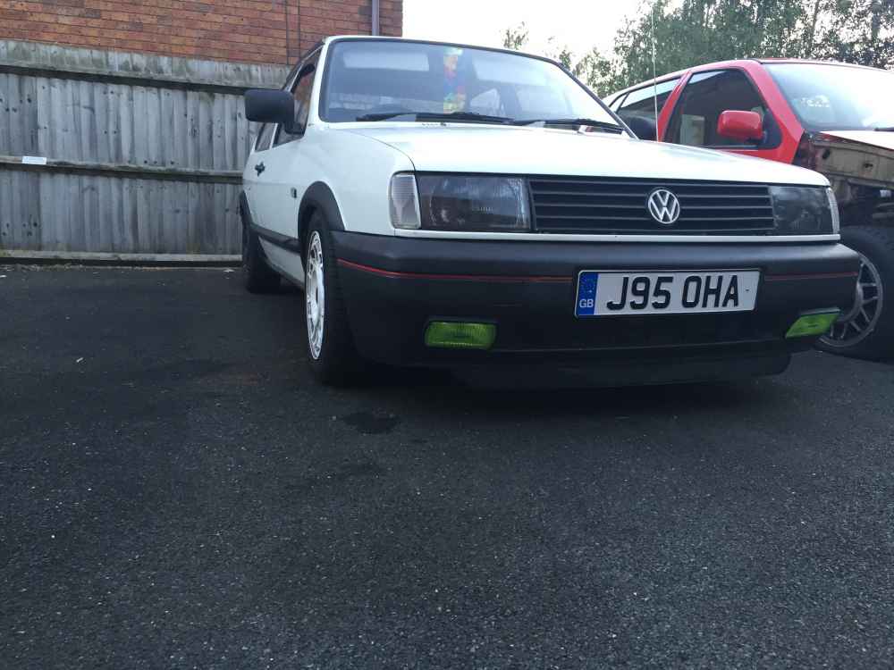

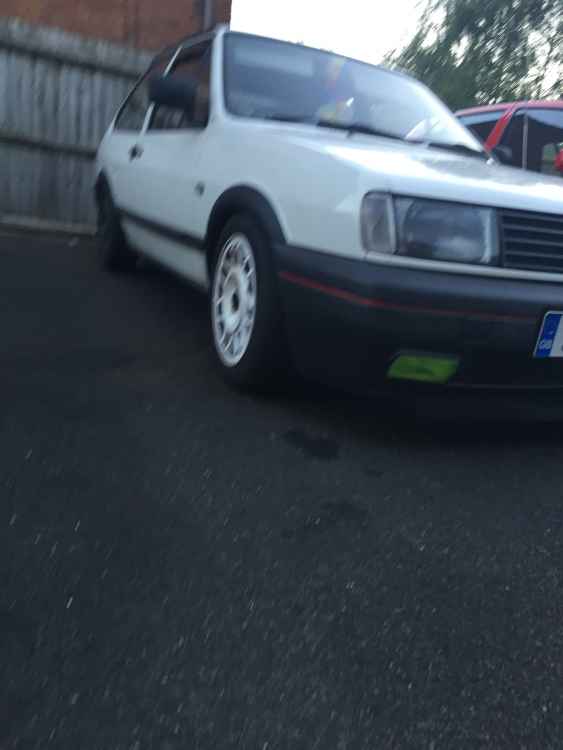

Update on the fox.
Coilovers are in the way
AFH box to be fitted
Arch and will trims
And refurbished snowflakes all round :)

Hi guys quick update on the fox treated her to new coilovers with hub and bearings top mount bushes and track rod ends changed handles a lot better and not like a boat ?
Also so have a valver 6n as a donor car for AFH conversion ?

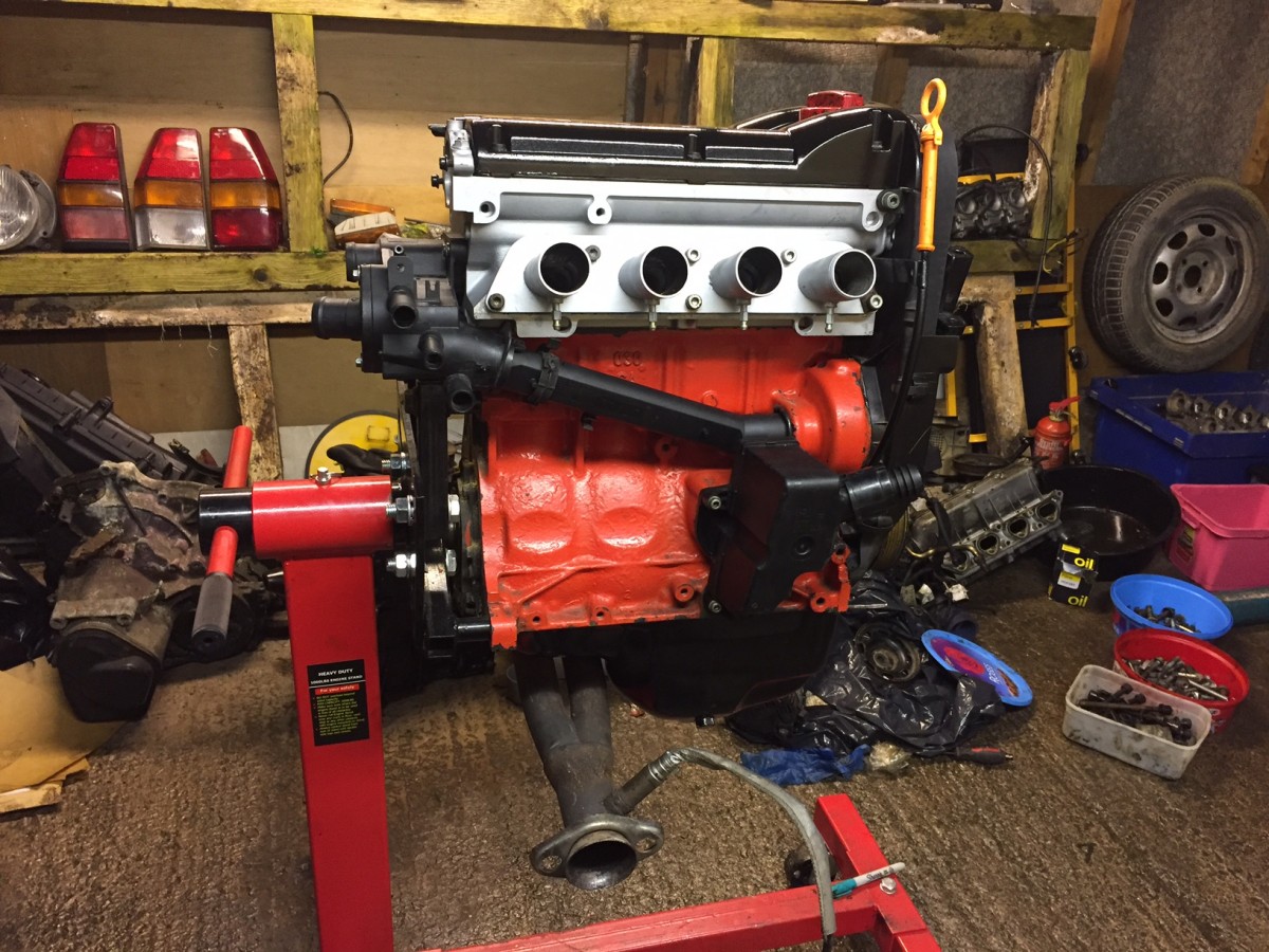

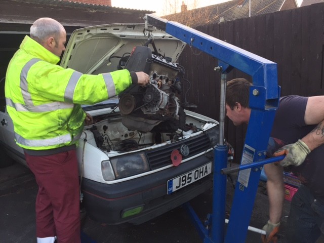

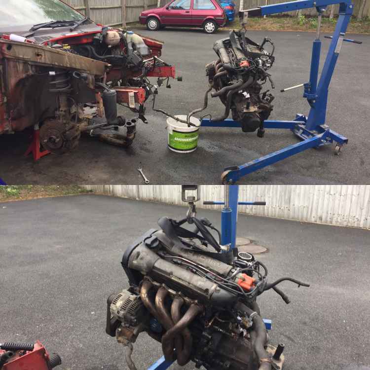

right guys a slight update on the fox i managed to find the time over the weekend pulling the AFH lump and loom out of the donor 6N,
But unfortunately will not be fitting to most probably beginning of next year as we have just purchased a house so this will be safely tucked away in my new garage :D
and whilst its out it will be painted,head skimmed etc,all belts changed and a good service ready to be dropped in its new engine bay .
It will sadly be on standard injection rather then carbs sorry to say!
As you can see i couldn't wait to mock fit the 4-2-1 Mani :D
On another note flo now has fitted ARB blocks which has made the world of difference to the handling courtesy of   kwijibo_coupe cheers again dude

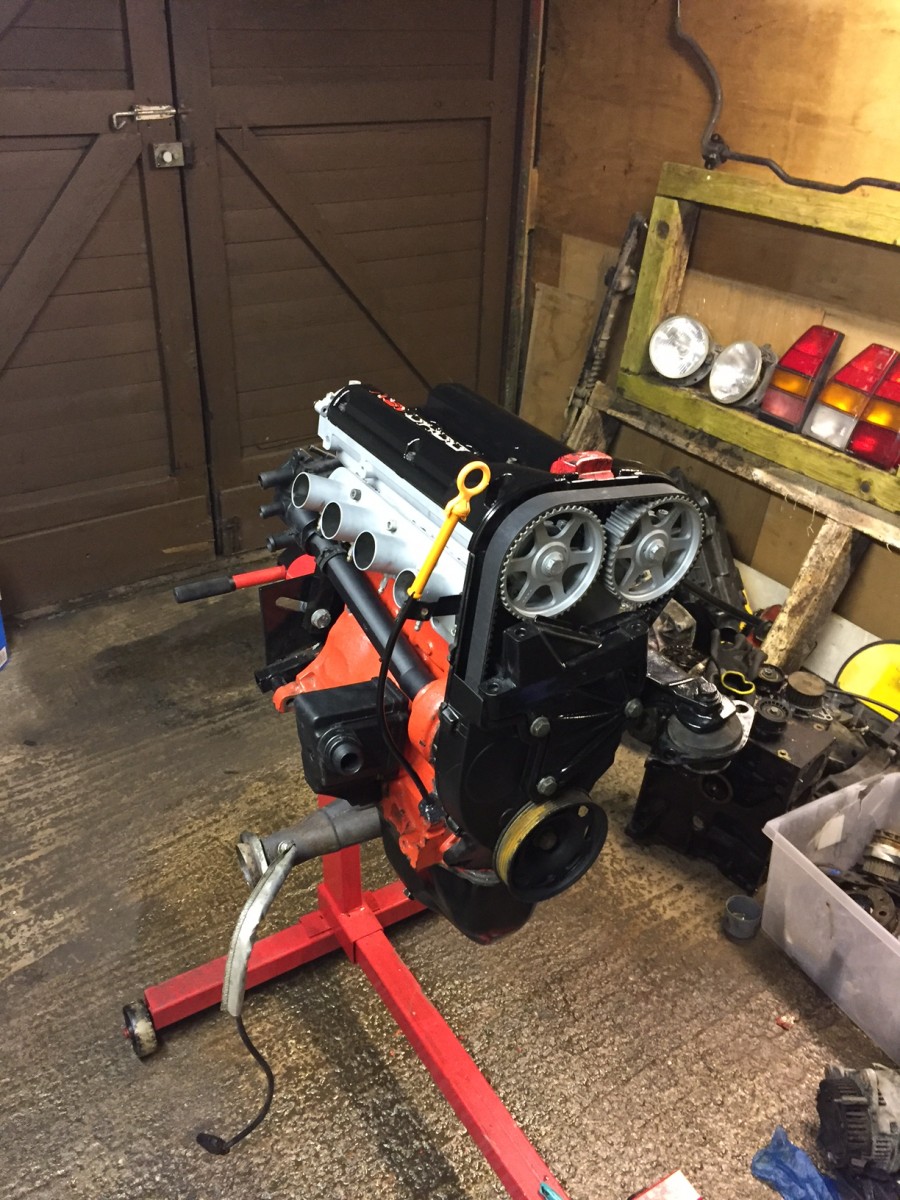

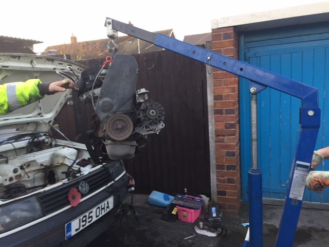

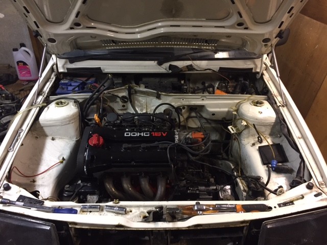

*Update on the AFH build i couldn't resist going carb route in the end :D but this is not the AFH you see in the pictures above from the donor 6N, i sourced a couple more and made one good one out the parts i had.
This included ported and polished head
rebuilt bottom end (apparently)
and boxes of brand new pipes and fittings etc.
I got hold of a brand new rocker cover gasket and set to work on removing the old one ( 4 hours and a old cheap pik).
Painted rocker cover, Also hand painted the lettering DOHC 16V (steady hand needed )
New HT Leads.
Vac advance dizzy with new cap and rotor arm.
new cam-belt and water pump fitted along with all other service parts required.
Mk2 loom which is in the process of being tucked and hidden away including coil pack

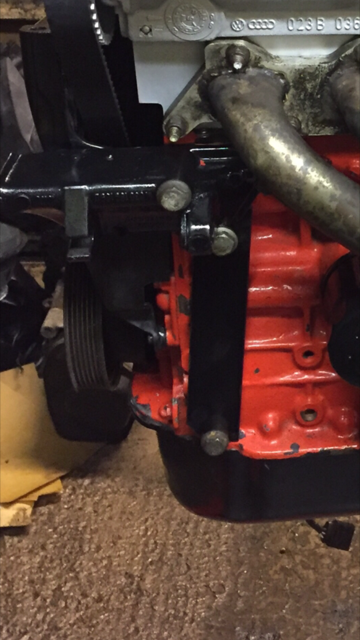

Bracket made to ensure third bolt of 2F engine mount is secured.
2F fly wheel and 2F late slim starter used.
it was a 1.0 Friday afternoon and by the evening the AFH was in and sparking.
Sunday came we had her fired up and my god it sounded awesome rather loud but it only had the manifold on.
manifold has plenty of clearance to the ARB too so shouldn't be any problems there.
im hoping by this weekend for it to be complete and ready to drive again.
come along way from the barn a few late nights in the garage has or hopefully will pay off :drinks:
the bracket made for third hole of 2F engine mount
