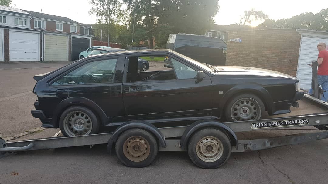

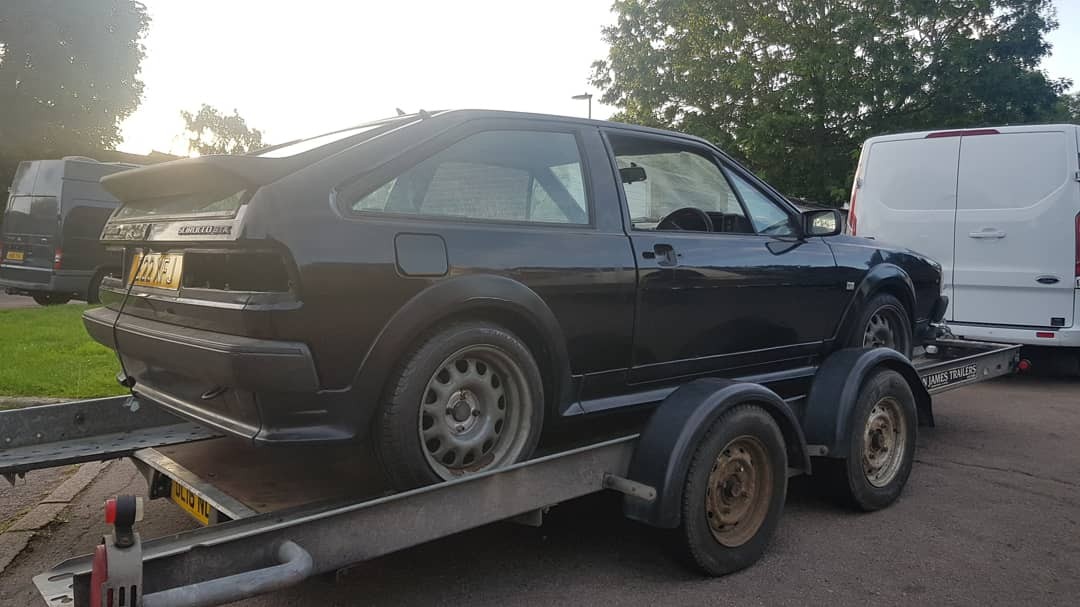

"Hey guys picked up a little project from "everlust" last weekend so thought if start a little project/build thread. It's currently sat on my dads drive so I can only get over to it and work on it at weekends so progress could be a little slower then I was hoping.
So basically its a GTX 1.8 8v injection. It's black which I love! Picked it up knowing it was blowing blue smoke on acceleration and headgasket gone. Still I took my friend down and we drove it back at a steady 60 with a few stops to top up oil as the headgasket is leaking quite quick. It ran the 80 mile home beautifully otherwise!!

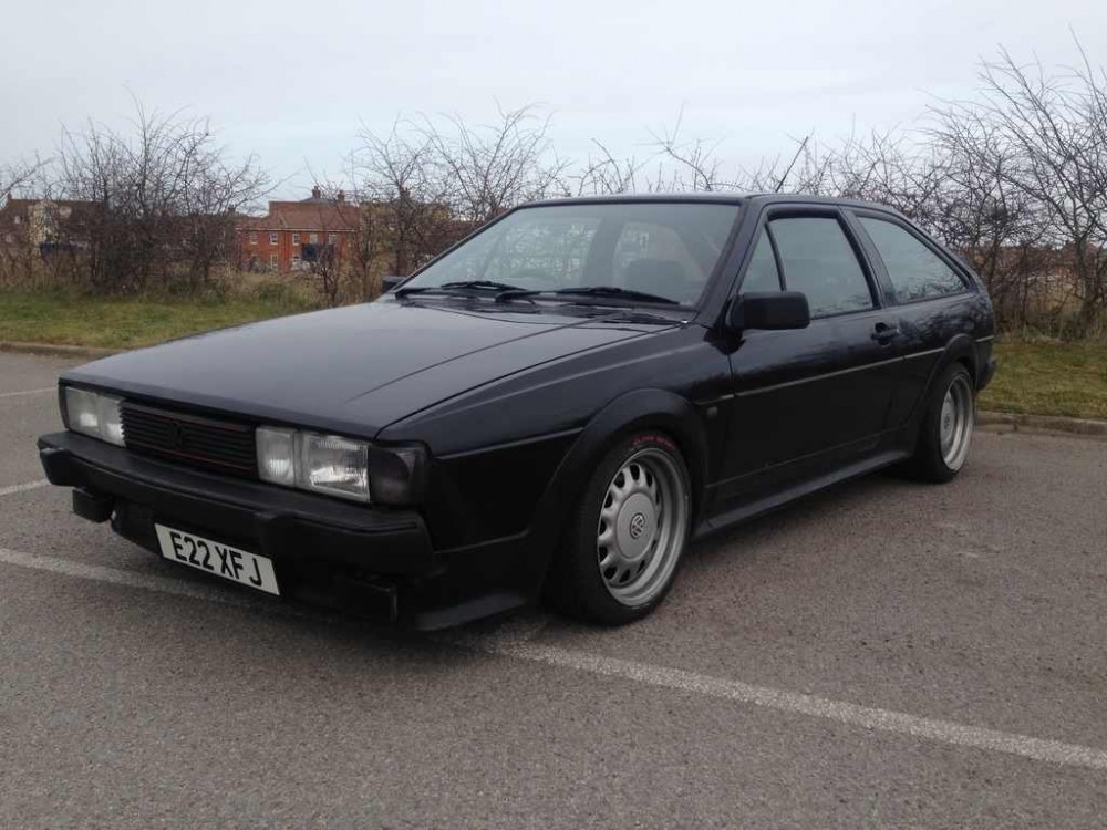

So here are the advertised pics
