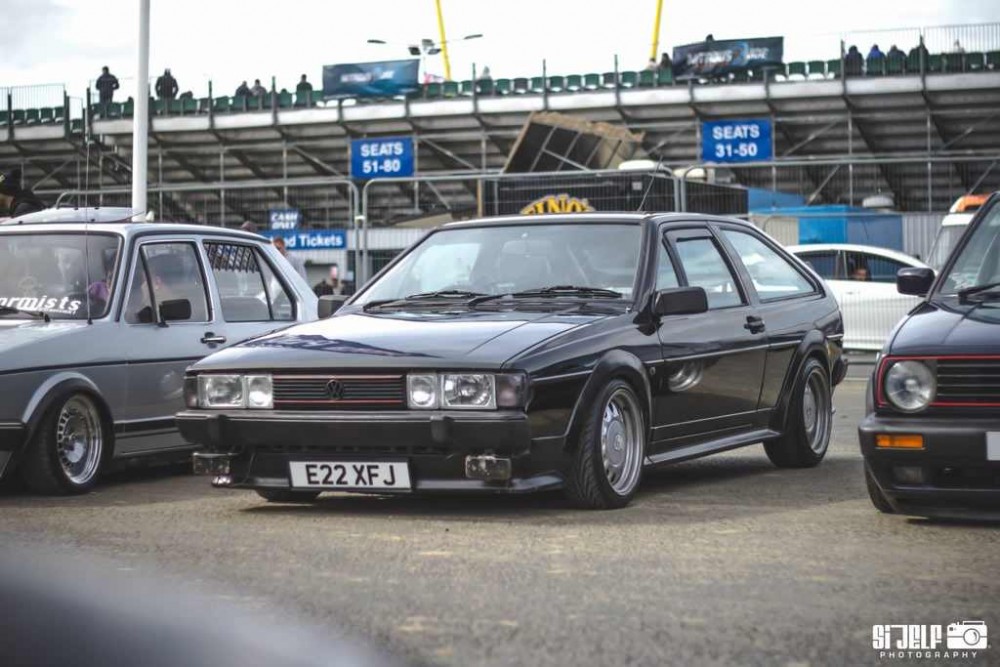

Scirocco GTX
Been taking this out as often as i can and people seem love a scirocco. Been doing other small bits to tidy it up

Well done with this so far bud you take this to shows over the polo then
I know what you mean about the comments thing I have a mk2 gt and it gets looks everywhere even had a police officer admiring it.
