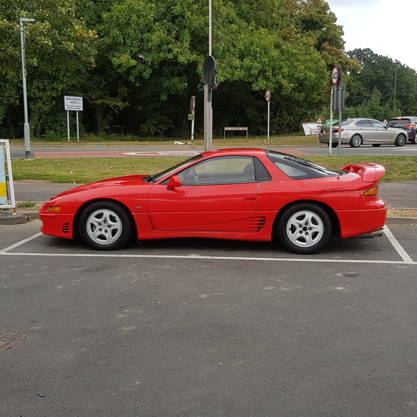

Around this time i was offered this
It was at a price i couldnt turn down.

I loved that rocco and my polo but i knew it would be foolish to turn down the gto
