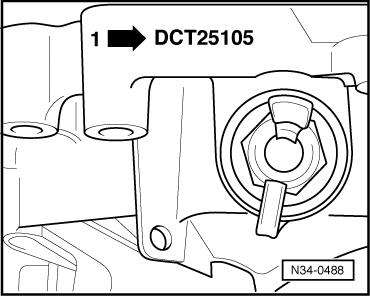

Finding the code on the gearbox is easy - just clean the area at the highest point of the casing with a soapy scourer pad, dry, and colour it in with a permanent black marker pen - it'll highlight the code like a black paint job highlights a dent!

Here's a pic of the code location
post-36925-0-24808100-1458146334_thumb.p
That's right, cheers Nigel.
