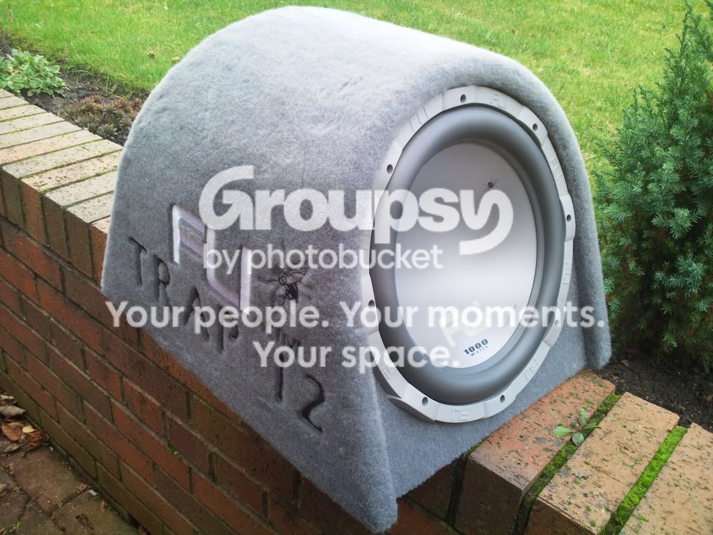

FLI 12" 1kw Sub using 250w AMP included with it ( I believe this doesnt hook up with the current stereo) (shown in image) (not sure if works entirely)

For the subwoofer you will need a wiring kit wire power wire from battery to 12v connection on amp,run rca's and remote turn on lead from headunit to amp and finally find a suitable earth spot and connect this to the Gnd connection on your amp.

Lastly the sub, you will an 8 gauge wiring kit which you can get anywhere.
You'll power-ground-RCA-remote.
Power simply runs from the battery terminal with an inline fuse closest to battery (should be included in the pack) run that down one side of the car and through clutch grommet. Bit of pain but its the best way to route the wire.
Ground will be anywhere in the boot, find a bolt of sorts attached the chassis, but remember to sand away the paint to get a connection.
RCA runs from the back of the stereo to the amp. Run that wire the opposite side to the power as that case cause interference with the signal the RCA is sending.
Lastly the remote wire (nearly always blue) will attached to the blue wire that should be short and attached to the wire loom plugged into the back of the stereo. This can be run down either side, and goes into the remote terminal on the amp.
