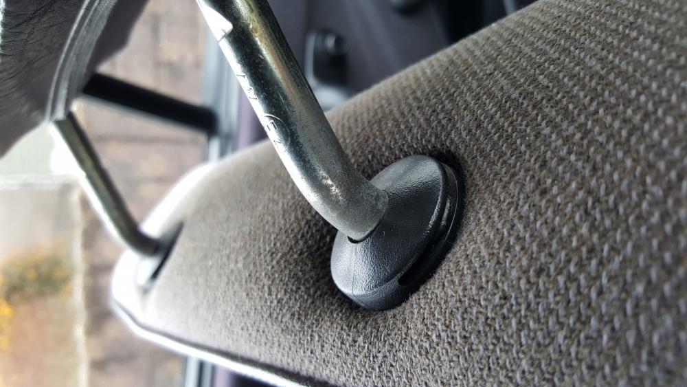

Did a search but came up blank. Could someone suggest a way to remove the headrests from the front seats of my coupe gt? Noticed the drivers seat was starting to show signs of fatigue and with material on the back support next to the door beginning to fray. Bought some seat covers from Halfords but it requires the removal of the head rest. Haynes doesn't cover this. Anyone got any suggestions please?

Removing
push or pull spring clips out of the slotted rings in the backrest with a small screwdriver and lift headrest out
installing
to install, first press springs clips into guide rings so that the straight part of clip is at rear. then push head restraint rods into guides unitl they engage audibly.
taken out of the polo instruction manual for my mk2f
